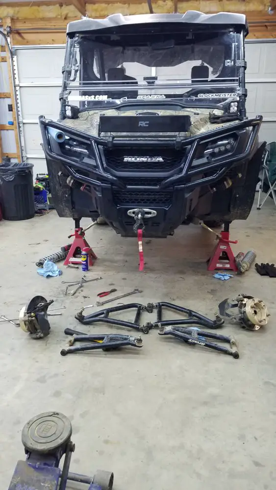

Been awhile...but its maintenance time again. After complete teardown found....
All Super ATV bushings are shot
Driver sides upper control arm mounting tab holes are wallered out.
Both upper ball joints need replaced
Passenger side outer tierod worn
Drivers inner tie rod had worked loose.
Ordered all new bushings and a Super ATV frame stiffener with gusset kit.
Also will have to do weld washers on upper control arm tabs.View attachment 163489
Your rough on stuff lol or Tackett was... I have a few things to replace that were showing signs of wear prior to tackett but once you get started you might as well get it all done...
Ill keep them in mind for the next set...already had the SATV on the way. Whats your thoughts on the frame stiffener and gusset kit so far?
Pretty sure the last log I hit that took out tire and tie rod probably would’ve ripped out the front control arm tab without it.
One thing I was worried about is it getting loose because of being a bolt in piece, that hasn’t been the case yet.
Honest opinion is I think there could be a better solution but for a bolt in support it’s much better then nothing and the price and ease of install makes it worth the money. Wish had it from day one there would’ve been lots less to fix.

So you already had noticed that there was some maintenance coming even before the Tackett ride?
It’s good to know that Tackett didn’t do all of that
13,542
70,279
I just did a little look see the other day when I dropped the preload in my suspension down and front is tight, I was surprised but I did change out any remotely loose ones before Colorado. I had my shocks too stiff at tackett.
I just did bushings in my SATV arms last weekend. Not a bad job just time consuming. She's tight as hell now.

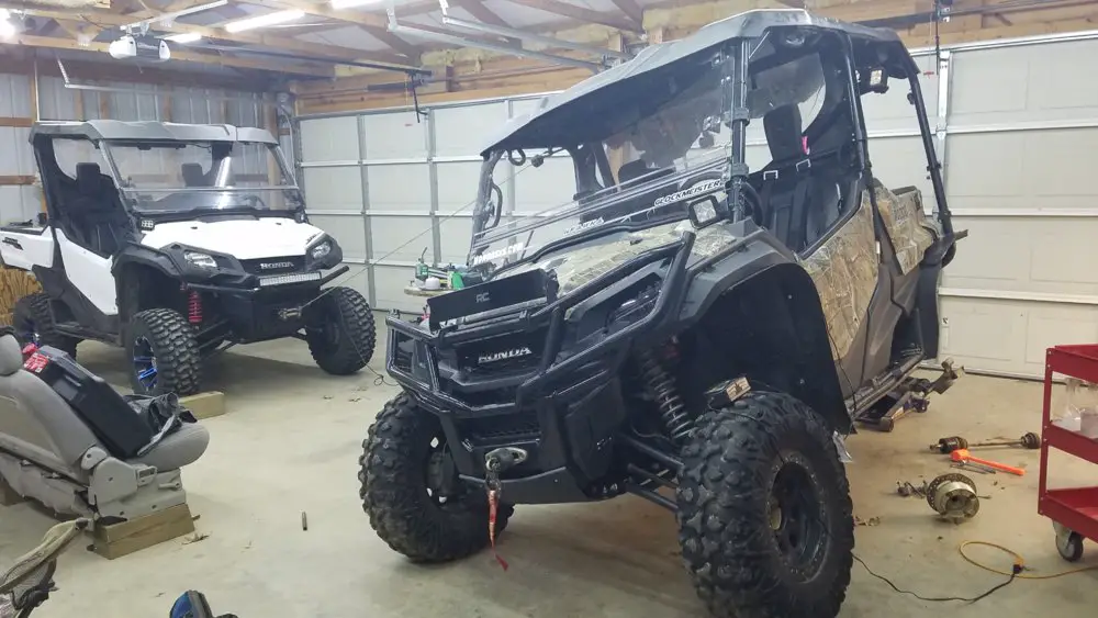

SATV frame stiffener installed, new A Arm bushing, upper and lower ball joints, and outer tie rods all replaced. Should be good to go for next weekend at SMORR.

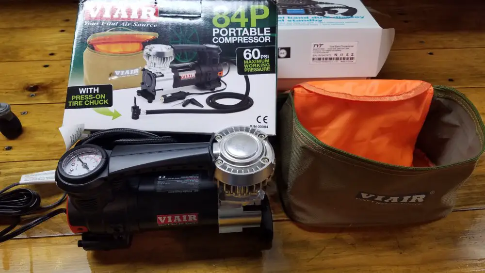

Also got this new high speed, low drag air compressor. Should do the trick.
Be easy with the handle on the chuck. I broke mine off the 2nd time i used it. Better yet, get a real clamp on chuck and barb fitting and hose clamp and throw it in the bag for when you do break it. ;)
Good idea...i got the clamp on because i hate the threaded end ones...too hard to thread when you've had too many kool aids
