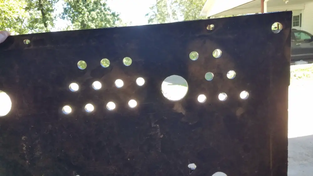

Not crazy about putting more holes in my skid plate but i had noticed the skid warping from the heat. So i popped a few holes for circulation.

I’ve noticed that mine will warp when it’s hot but then it returns back to shape after it cools down. Let me know how that goes, I may have to try the same.

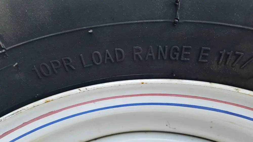

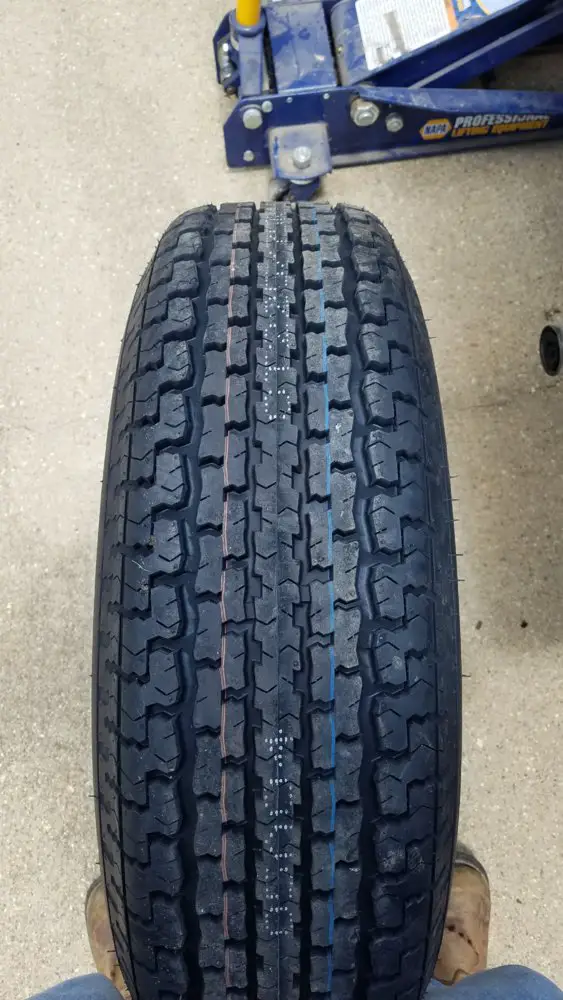

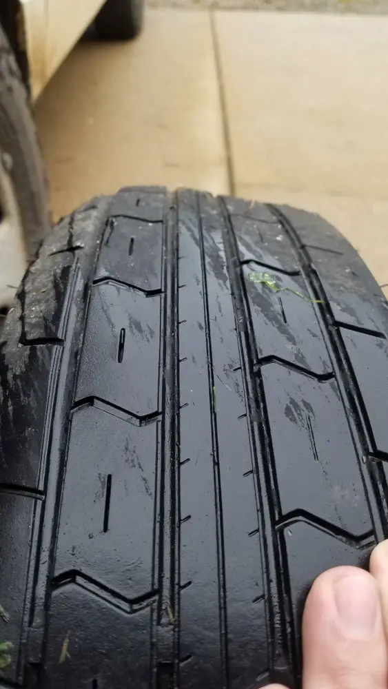

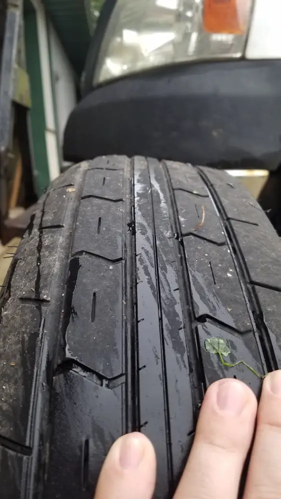

Upgraded tires on my trailer yesterday because both tires developed big bulges. Cheap tires i guess.
View attachment 141122 View attachment 141121
New 10plys
View attachment 141119 View attachment 141120
That’s funny you did that. I just got 9 new trailer tires last week (the ninth was my spare for the 5er) 4 for my 5er toy hauler and 4 for my tandem. I bought Carlisle trail HD’s. Have a speed rating of L (75 mph) load range E for the 5er and D for the tandem highest for the size. All an upgrade from before and needed. Good peace of mind for sure.
