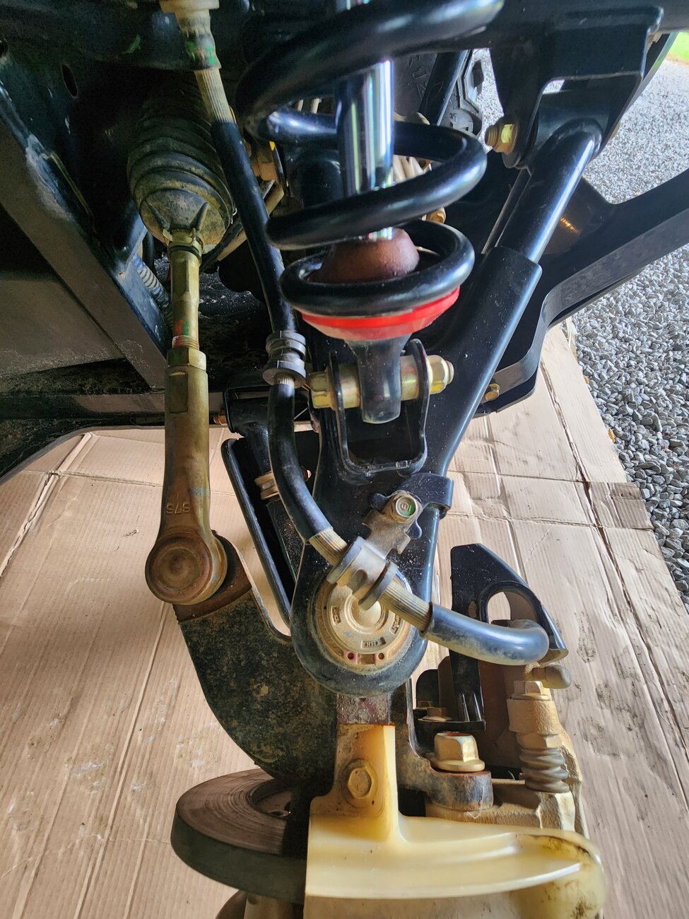

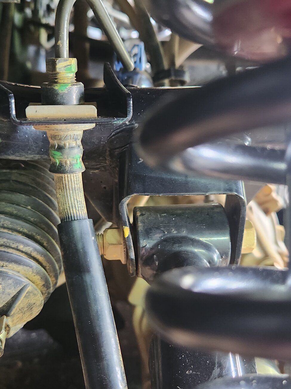

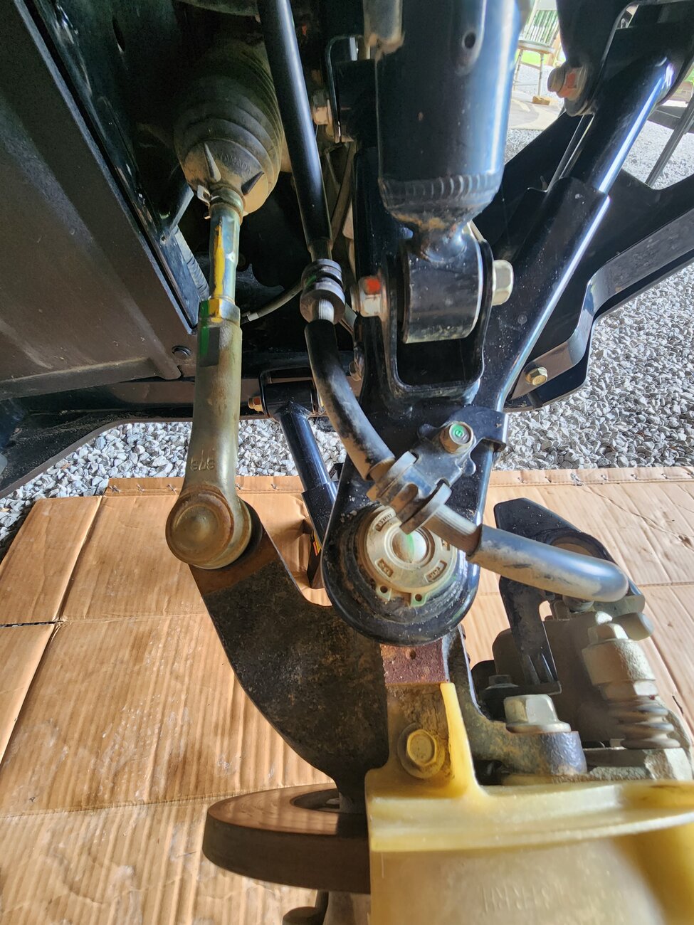

Got em jacked up, rt front wheels off.
20230828 120245
20230828 120253

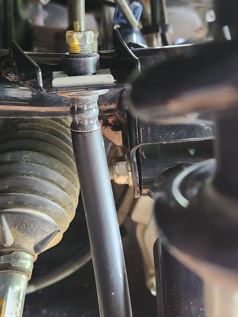

The only thing I see thus far is a bent a-arm bracket: upper arm, rear bracket.
View attachment 401109View attachment 401110
If the paint isn’t cracked anywhere there and welds look solid I’d be willing to bet that bracket was tweaked in from tightening the A arm down at the factory. Just a guess from this particular pic though. You can make a better judgement call being able to see all the way around both sides of both A arm mounts I’m sure.

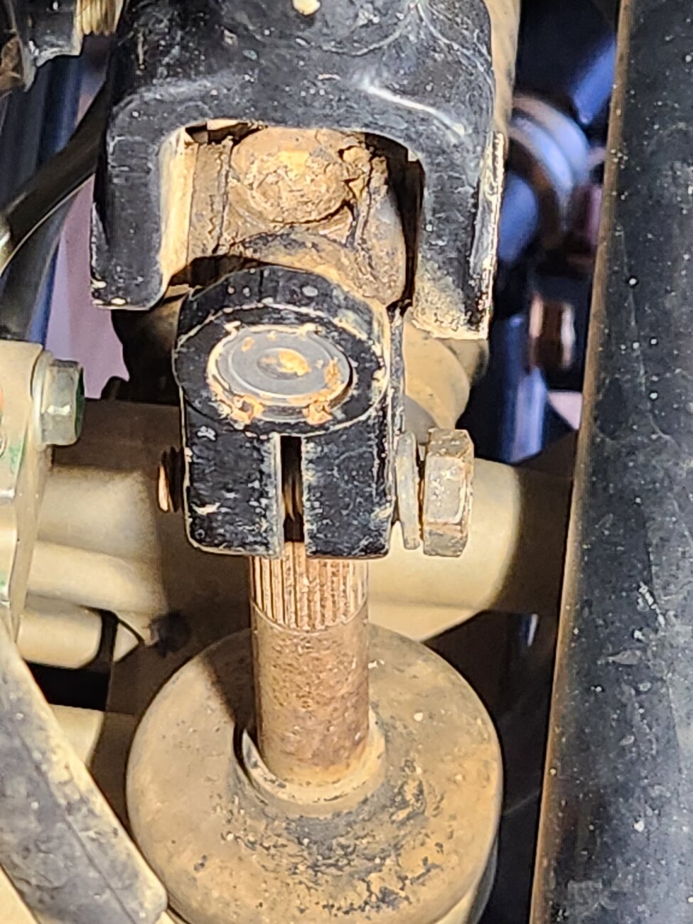

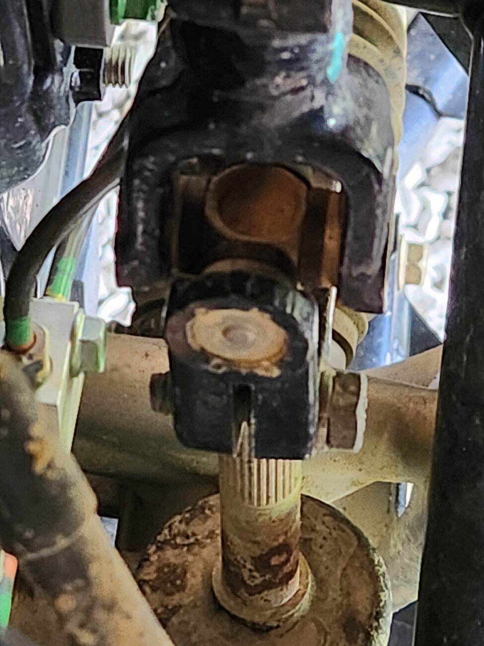

Ball joint too loose, I think
The P1 & P7 has a grooved steering shaft coming out of the steering box, the bottom universal pinch bolt needs to be in that groove, you may have to loosen top universal pinch bolt to get the bottom pinch bolt to rest in the shaft groove. Throw the bolt away and get a new one. This was a recall on some of the early P1's. Anyways match bottom pinch bolt of the universal to the steering box shaft groove then tighten top universal pinch bolt on to the shaft coming from your steering wheel. I would think the P5 would be the same as other P's. Now on to the ball joint, did you check it with the tire on? You won't be able to get enough leverage with the tire off to check unless it just falls out. Please keep us apprised.

The ball joint feels fairly loose/pretty easy to manipulate, notchy . . .
Hopefully that and the steering knuckle are the issues. I'll bet there is a You Tube Vid of the process, You will probably need access to a ball joint removal tool ( $25.00 OR LESS AT HARBOR FREIGHT) and a press to install new ball joint.

Order new hardware for your steering joint. I think new bolts are less than $1 ea.
I completely lost steering on mine during takeover. We tightened it up enough on the trail to make it back to RRB, then swapped with a bolt for remainder of week.
