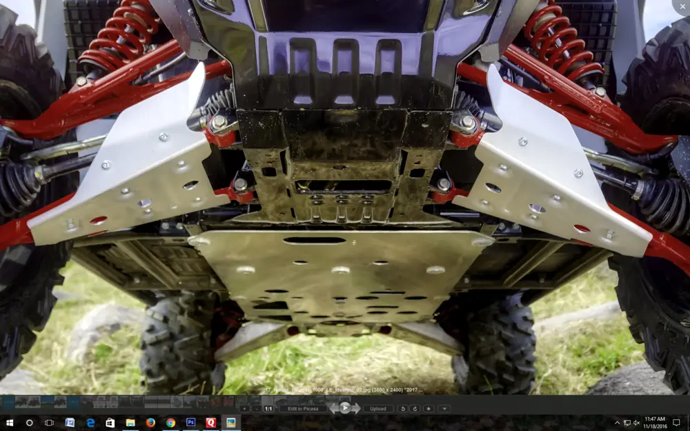

Anybody else waiting for a part number for the LE center skid plate?
Nope.. I have discovered UHMW after years of saying... " WTF, who would want a plastic skid plate".
But they both have there goods and bads!
Anyways, I have a close up for you!
Upload 2016 11 18 11 47 53
The skid plates, a-arm guards and front bumper are already available from Honda accessories
Skid plates- 08972-HL4-A00
A-arm guards- 08P74-HL4-A00 FRONT
08P75-HL4-A00 REAR
Bumper- 08P70-HL4-A00
Apart from the new 4wd system addons (not sure what system the non-LE 1000 will have, assuming '16 model system), illuminated switches and the painted parts you can make your own LE out of a '17 or even a '16 model. They already said the shocks will be available separate so to me as a Service Advisor for Honda, I still want the same model 1000 I always have. A EPS 3 seat with the exterior panels removed, the only thing that's changed is, I would like the FOX shocks now and maybe the door cup holders instead of dash mounted ones.
The skid plates add nothing, I have never sold a Honda branded skid plate to anyone for an atv or sxs, why, because they only cover the space the original does. The wheels are not going to sell anything either, anybody that knows the current SXS market knows that this industry is closely falling the truck industry. You buy your vehicle, take it home, tear it apart and commence installing parts. I've sold more wheel kits since the Pioneers has been out then we ever did. I know you need to include some kind of fancy wheel to make it look like your getting more for the money, but there not a selling factor at this point.
Honda better aggressively price these bad boys or I'm going to be sitting on them at the dealership. I mean they took away the most requested feature with the locking diff, Sometime I wish Honda would take the less technological and innovative route and follow what they taught me@ Honda school in Troy, OH-
K.I.S.S KEEP IT SIMPLE STUPID

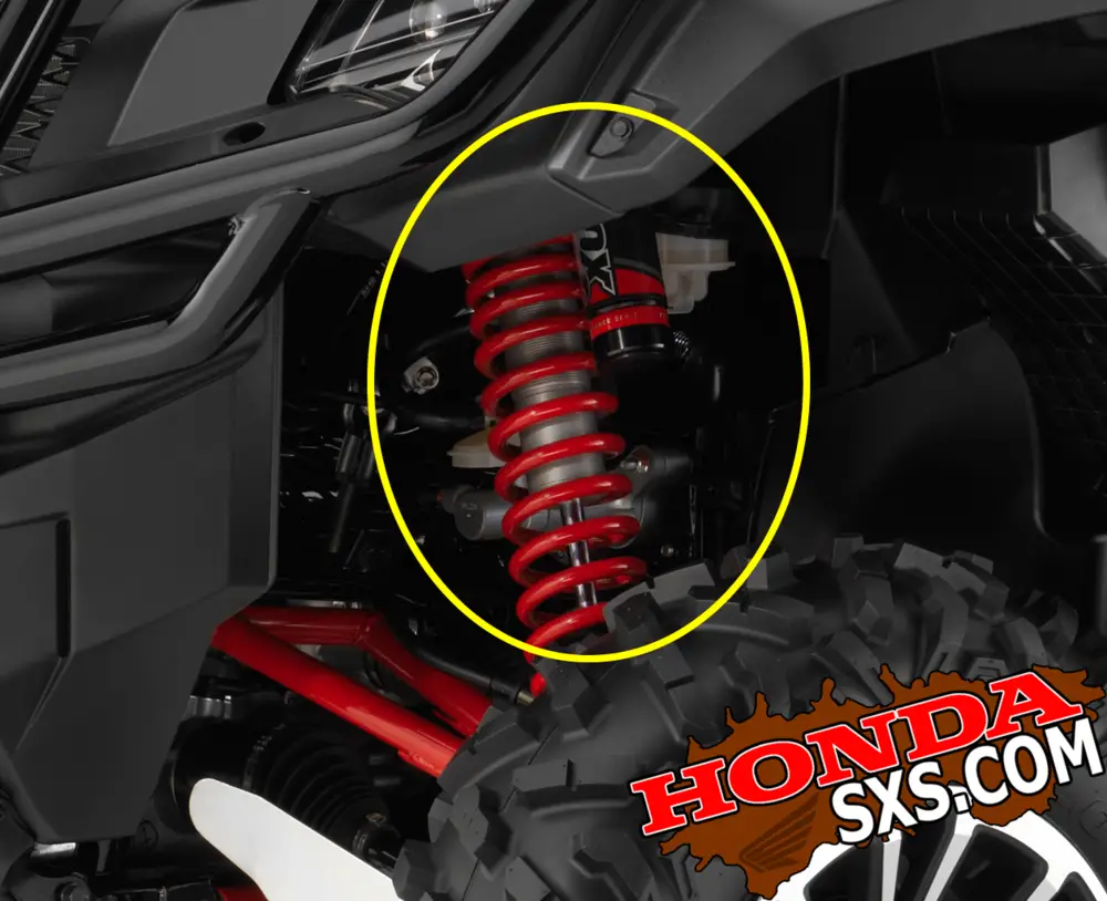

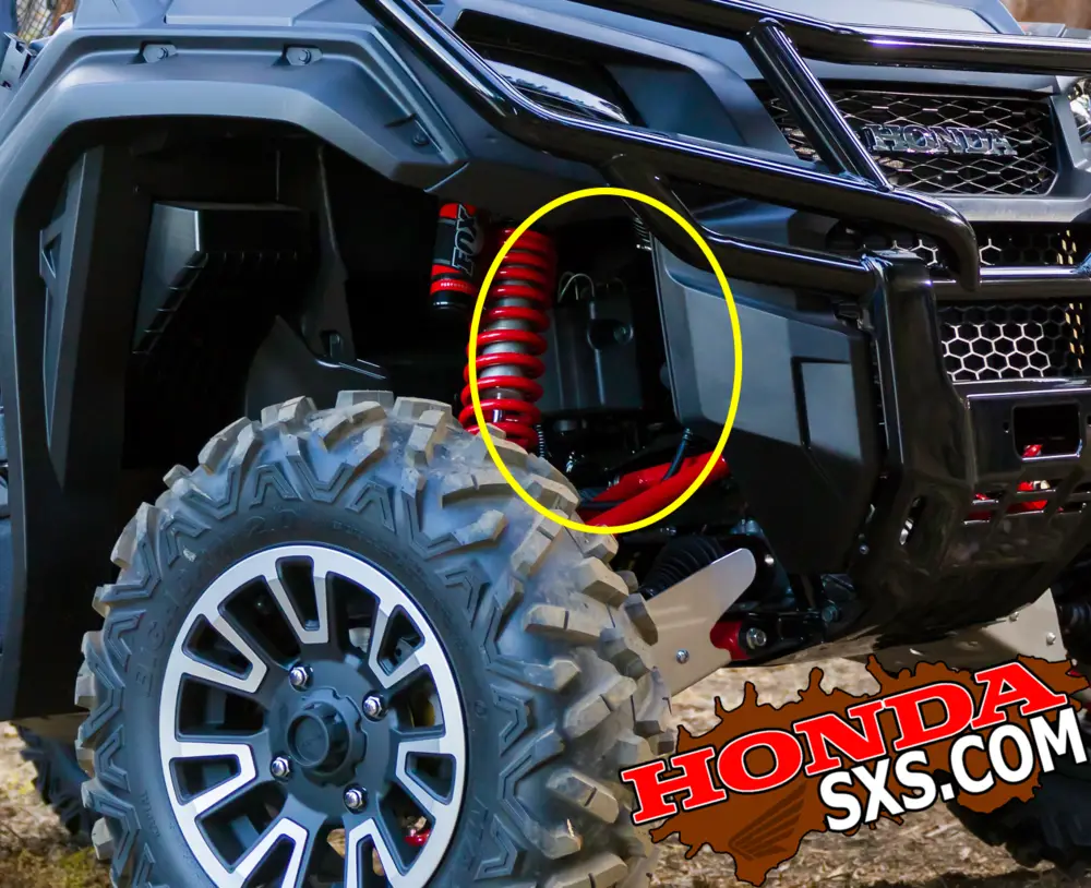

Maybe part of the brake modulation system. Does it have the same thing on the other side? It looks to have a cable coming out of the bottom going towards the front wheel that looks a lot like the ABS cable that we used to use on the front hubs on our ABS systems.
There will have to be a ABS cable that carries the signal from the tone wheel in the hubs to the ECM/ABS pump controller to let the system know the RPMs of the wheels so it knows when to apply the brakes. Since the braking is going to be independent on each wheel, it will have to have something that works independently of the master brake control.
But without seeing more/closer pictures I couldn't tell for sure.

But look behind the Fox Shock! You see dual brake fluid chambers that match the patents posted a few months back.
Patents --> Electronic Braking patents - US20160114775
It's a brake modulator - similar to an ABS modulator in a car. It is needed for the traction control and hill start assist features. It can apply brakes individually to each wheel. So if traction control is on, it can apply braking to one or both of the rear wheels to stop wheel spin. It will probably act as a proportioning valve too, based on some of the marketing stuff they released about this new model. It will also apply the brakes for the hill start assist, to prevent you rolling backwards if you're stopped on a hill and release the brake.
It could also be part of a stability control system, but I don't know if these models are equipped with that...
