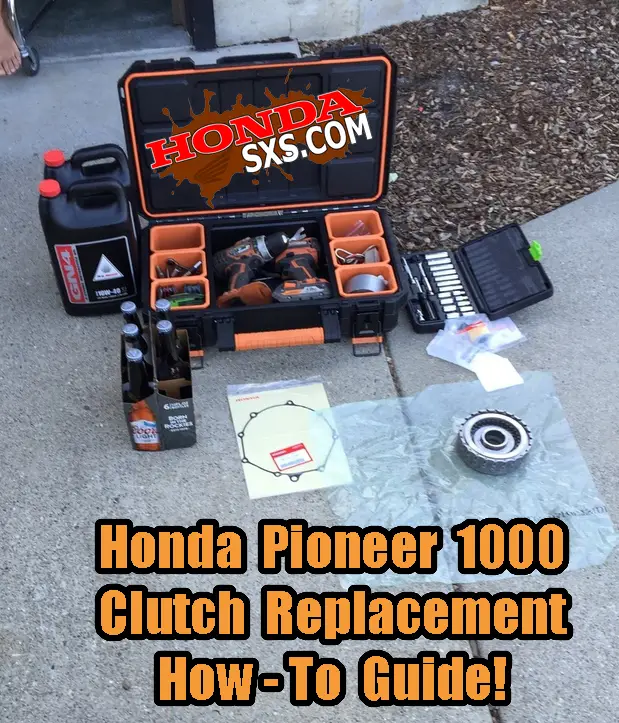

Lets talk CLUTCH REPLACEMENT!
The 2016 Honda Pioneer 1000 seems to be getting a reputation for having clutch failures and it has been common perception that Honda was taking care of these issues as they come up for all its loyal riders. WRONG!
Lets say if you are stock and haven't drove through a puddle of water 10" or more, then you have a fairly good chance the Honda will approve your replacement. But if you have modified your Pioneer outside "there liking"... well.... You best just read up on the below!
But... Not to worry. For less then $350 and a few hours time you can be back on the trial!
If you can replace an alternator or water pump in your car/truck then you are more then capable of completing this clutch replacement!
Time needed!
  • Stealership = 7 + Hour$$$$$.
  • Novice mechanic = 3-4 hours.
  • Home mechanic = 3 hours.
  • Back yard mechanic = 2 hours.
Parts list.
Oil Filters and Oil.
See: Honda Pioneer 1000 Oil Change Guide!
The below is from a 2016 Honda Pioneer 1000-5 Deluxe.
IMG 20210623 WA0018

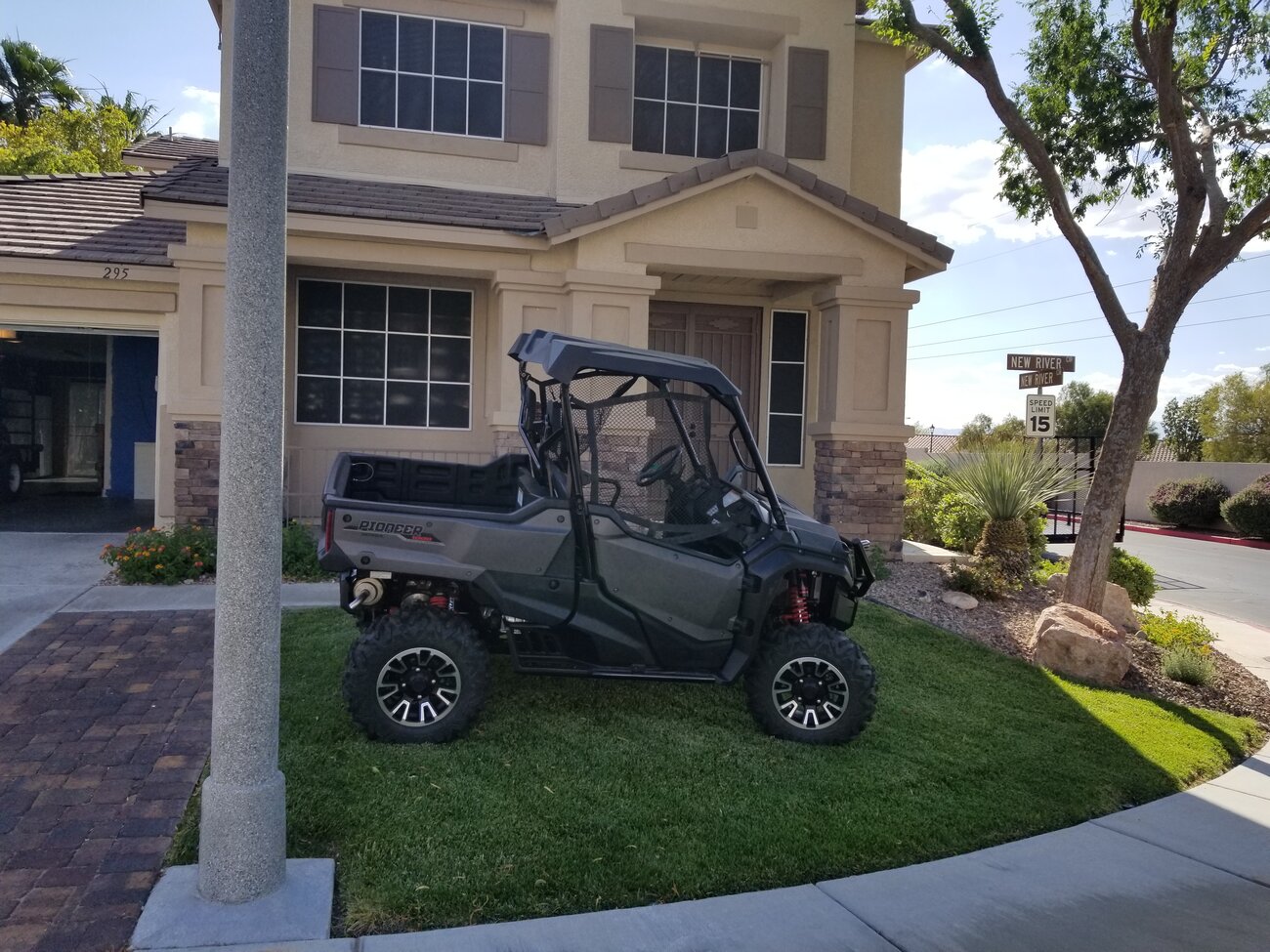

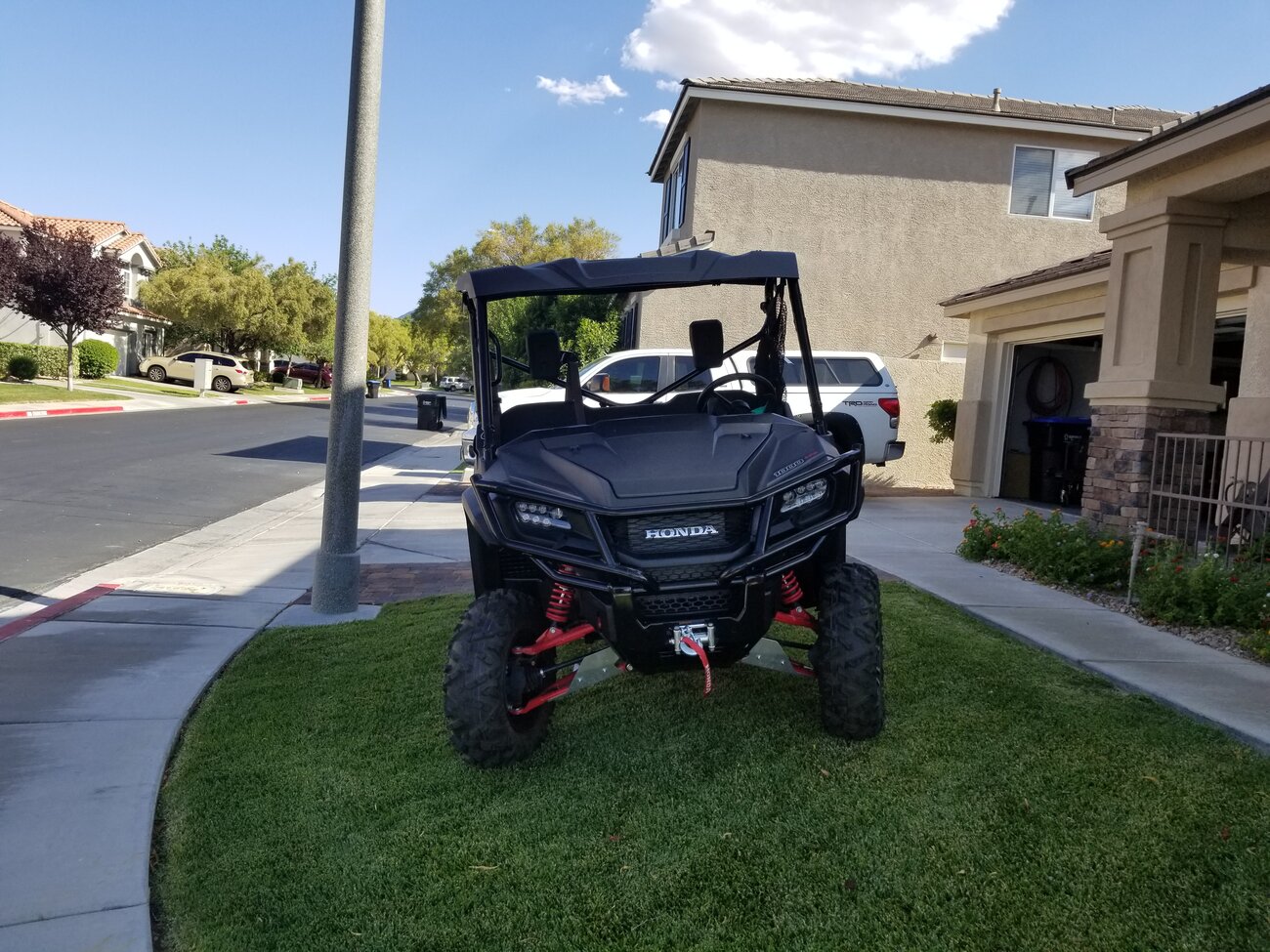

I bought the unit new from ride now in NV but now I reside in Iowa. It currently has 166 hours and roughly 1150 miles. When I bought it, I really don't know the milage but it was brand new off the floor. I had to wait for Honda to send the dealer the exhaust recall parts to pick it up. I want to say it was a year old though (overstock) so I bought it in May of 18. My oil doesn't smell burnt to me. It smells just like the engine oil. I had trouble shifting the other day while it was running but if I shut it down, I could move the shift lever to what ever gear I wanted and it was fine. Now the shift lever moves freely and it revs a bit before shifting into 1,3,5 as well as Rev. It also does the same thing in MT mode. This is why after reading and hearing about Honda clutch issues...I feel like I am where I am.
