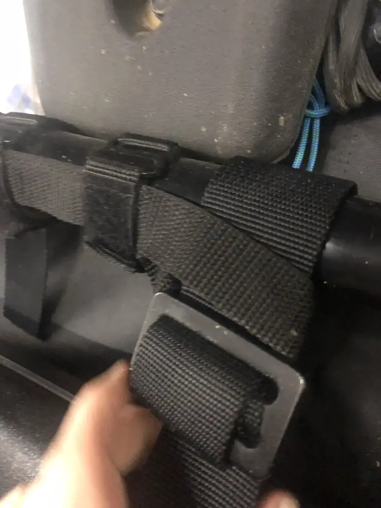

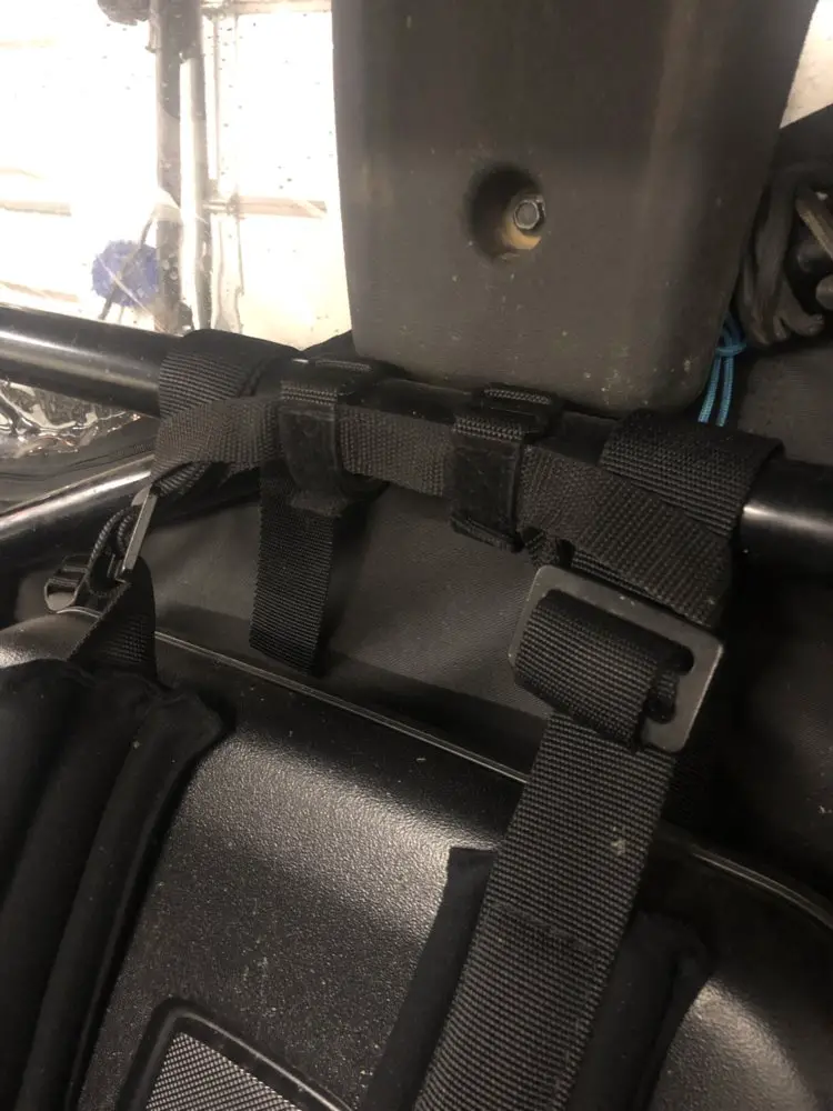

Did you look in my machine thru a time portal or something?
I am using 3 per side right now. one in the middle, and one on each side to retain. I haven't gotten the belt quite tight enough on the BCF bar to keep it from slipping over the collar. My next step is slice a piece of 2.5" OD .065w tubing from my scrap bin and tack that onto the collars to retain it.
Until I get that done, and can contain the belt 100%, I didn't want to share. But seeing that you brought it up, I figured I would share what I have done so far. I'll grab a picture tonight.
Most of those collars are made out of 1215 steel and do not weld good at all. Might be better tapping and running a bar between them on the outside.

Couldn’t you just take a small rod and shape it into a half rectangle so to speak and weld it to cage the loop belt through?
You could, but not everyone has access to a welder. Possibilities are endless if someone has a welder and can get a decent weld.
