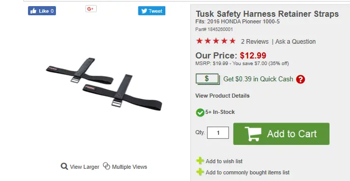

We need to put our heads together collectively and come up with a solution for the shoulder straps on the BCF bar. They need to be retained to do their job. I have a solution in place right now, but I want to get another ride or 2 under my belt before I suggest others do it as well.
So, Anyone with harnesses currently installed and the shoulder part not being retained from sliding on the bar, step up and help us come up with a solution to keep them from sliding left to right.

Can u use a 2 pcs shaft collar on the outsides of each set of belts?

Work perfect
Upload 2019 2 12 10 15 3
Tusk Safety Harness Retainer Straps
Ones I ordered Pro Armor Safety Harness Retainer Straps
Did you look in my machine thru a time portal or something?
I am using 3 per side right now. one in the middle, and one on each side to retain. I haven't gotten the belt quite tight enough on the BCF bar to keep it from slipping over the collar. My next step is slice a piece of 2.5" OD .065w tubing from my scrap bin and tack that onto the collars to retain it.
Until I get that done, and can contain the belt 100%, I didn't want to share. But seeing that you brought it up, I figured I would share what I have done so far. I'll grab a picture tonight.

Do you have pictures of this installed?
I can get one when I get home, it works good though. Because I only have harnesses on my side I took the other one and have it clipped on a bar that I attached a few things too - neither has moved as of yet but I also have not been in a accident - it helps keep the harness straps in the same place and I also used prior to getting the harness bar.
