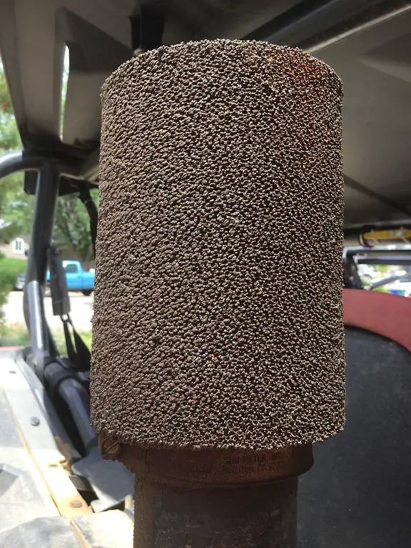

Cleaning the Uni does sucketh, that's fer shur. But it sure is efficient.
Stock filter at 1137 miles -
I 2fqCwcL L
Uni at 1066. :oops:
I KRxxBDV XL
New it looked like this -
I gXGK7GX L

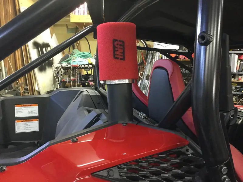

You think an S&B is expensive but the Donaldson Top Spins are not?
I'm using one of these as a prefilter with an outerwear style cover. Cheap and easy. If the outer cover gets to dirty, reach over and pull it off and continue on. Is it really that difficult to clean and oil a filter once and a while?
