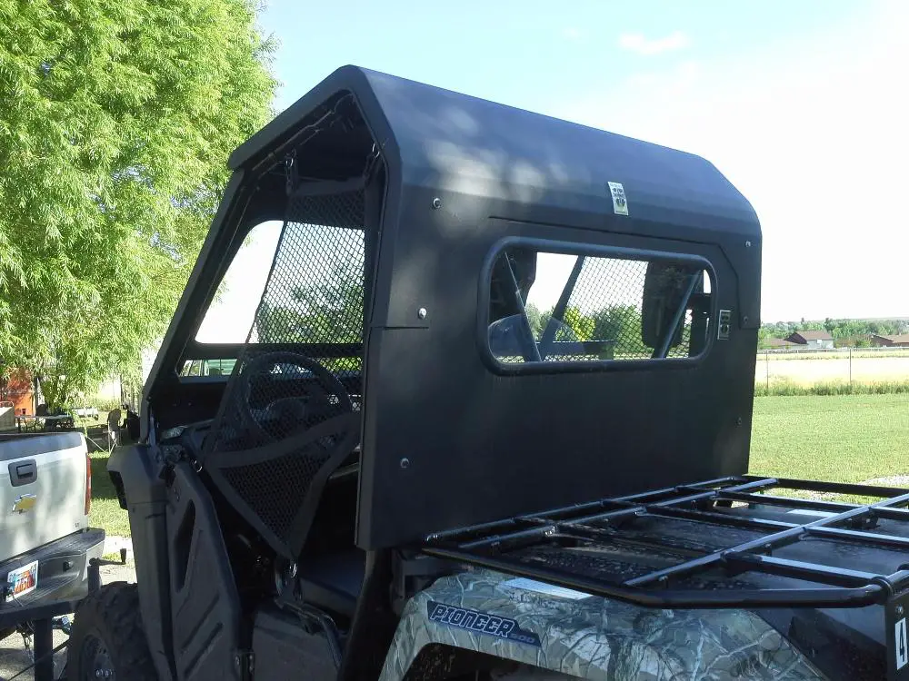

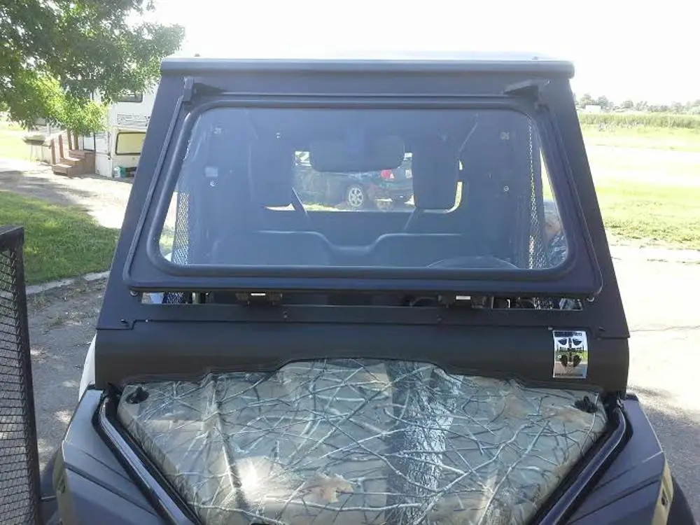

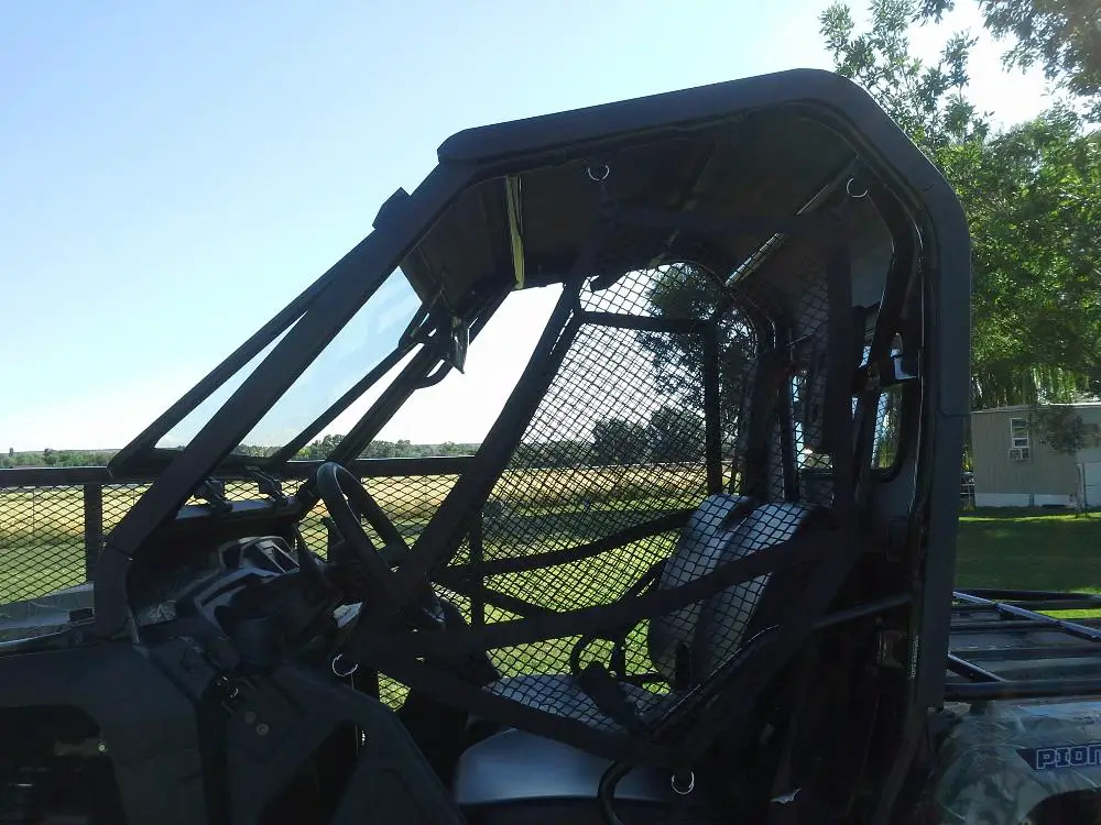

I am really liking the looks of the Alumalite Armor P500 tip out glass windshield aluminum roof and back panel. If they made some doors that came up about 12" higher than OEM that would be the complete ticket for all but the coldest climates. For 1200 on the full package that's not too bad for what it is made out of. I've got over $800 in the Honda OEM accsy. windshield / roof/ rear panel and it nothing more than plastic & vynil.
Gallery
View attachment 11819 View attachment 11820 View attachment 11821

The fit looks perfect. The windshield is a bit obstructive for my preference, but to be stout enough I can see that it needs to be made that way. Finish is very nice too! It also appears that it has the added benefit of some dash space to throw your gloves and what have you.

Not sure about the windshield fitting with the Honda roof, part of me says yes you will be ok but I am not 100% certain. I would go with the whole shebang and be done with it the roof back panel combo made out of aluminum and glass as well block a lot of the engine heat from what some have posted, but it will not stop all of it.

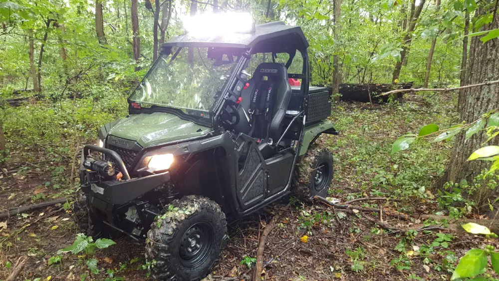

Thanks those pics above are not my P500 those are promo pics from the alumalite armor website.
This is mine:
20150912 13210420150912 132204
20151003 125558

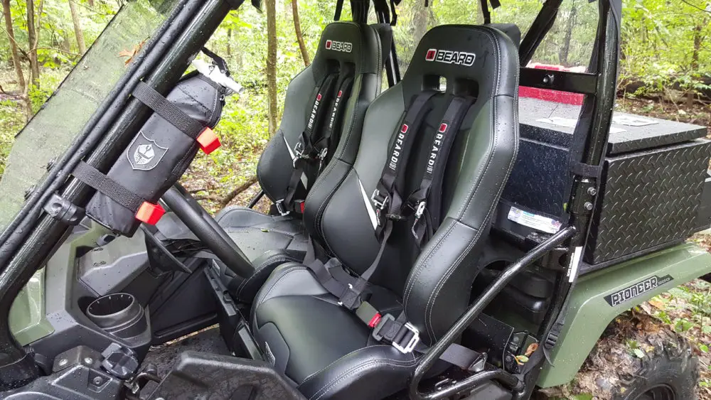

What fire extinguisher package are you using there?
It is a Pro Armor brand bought from RMATV. Attached by qick release velcro straps.

Thank you. Btw, the sound bar you recommended to me sometime ago looks good, fit good without interfering with the rear view mirror, and sounds fab.
