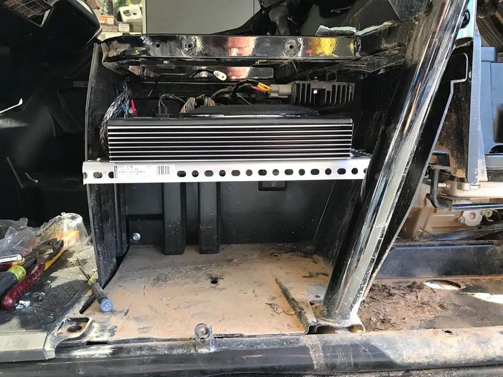

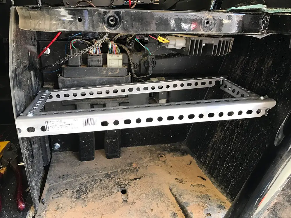

It's working now. I don't know what was happening last night. Do either of you have pics of the brackets? Trying to see how you mounted it. I also ran my remote with to the bazooka and am using the aux pwr out for remote turn in. That way if I don't want the sub on I can conserve energy.
20170301 183858
20170301 183912 20170301 184013
First 2 pics are the L Brackets I made, the third pic is under the bed. This metal strap is on the outside and a piece of angle aluminum is bolted to it on the inside under the seat and one end of the sub sits on it.
