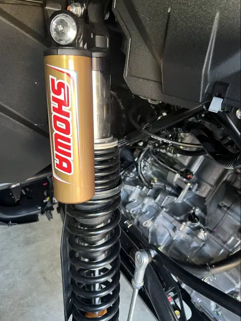

Just high/low compression adjustments.
Not a lot of tuning options as these are fairly basic upgraded shocks over the $5 shocks that come on a P1K standard, deluxe and Forest edition. You could look for a more progressive springs and fiddle with compression settings, or purchase Fox or Elkas. Not sure if King makes anything for a Talon? Considering many just put around in these, probably a non issue for that crowd.

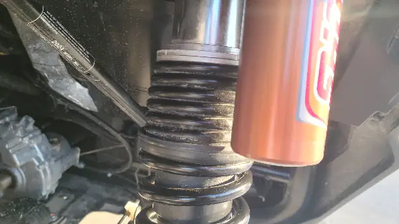

I can almost guarantee that the shock body is grooved for a snap ring and that's what holds the top collar in position on the shock. A threaded collar can be slid over the shock and retained with said snap ring to make them dual rate/adjustable. Low end Bilistein(sp) coilovers are built this way and so are most hotrod style coilovers. While it sucks that the shocks don't have threaded bodies it's also not the end of the world.
Whoever is the first to make replacement threaded collars and crossover rings for these will be selling them like hot cakes if done right.
SLOWPOKE693
SLOWPOKE693
Mar 10, 2020
2,029
7,867
Somewhere in Texas
Snap ring goes on shock body, threaded sleeve slides on shock from bottom and stops on snap ring, thread your adjuster on, install top spring, install crossover nut and slider, install lower spring and lower spring retainer. Easy peasy
