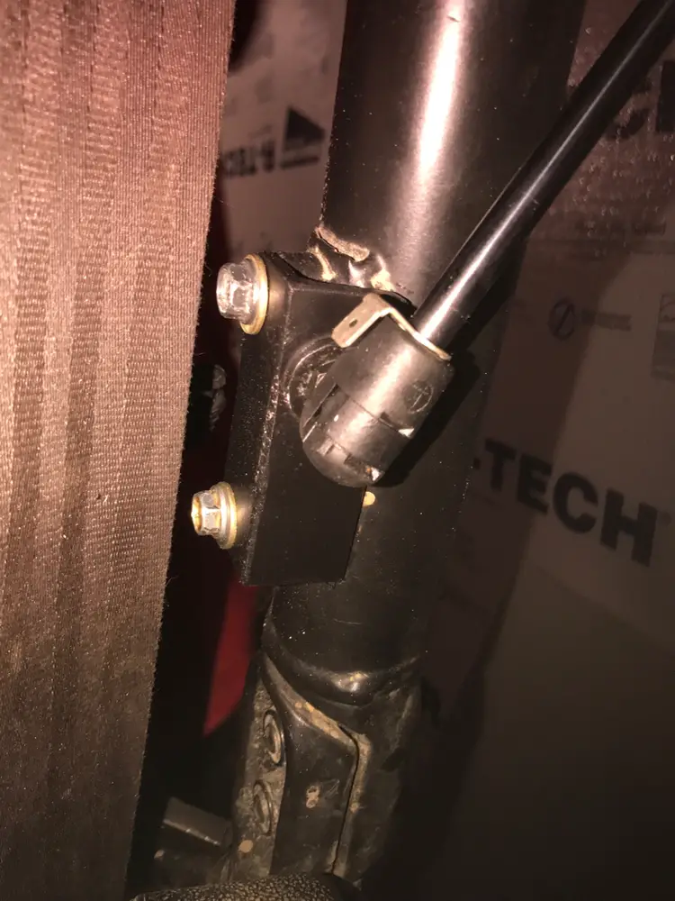

The shock took a sec to figure out. You build the door then take hanging fish scale at the top shock mount point to weight the door after mounted to figure weight. Ok 31 pounds. (Actually 6.5 but it's heavier closer to the hinges because of lever action) I used 35 works great. You use extension mount on door and that uses shock to pull door in when shut. Built mount on factory bolt spot works great. A couple braces were added also can never be too solid. It's coming! Look at shock I made sure to use one with defroster wire clips, I'll be adding exterior lighting on the doors to make up for the tinted windows. 016c6ee92089c0afd299bb6fd8176867

I have never saw a defroster wire hookup on a strut (I am from Bama though) like that and like the gullwing setup. U deserve 6 beers minimum! Awesome job!

s*** they have them there too lol. It'll work excellent for power then ground through hinges. One wire disconnect when doors pulled. Gullwing was way to go it's simple and opens up wide so eases getting in and loading. Two pins to pull from hinges and I gut this quick release for the strut.B363b37b1477c30164c5f32278cbd6a3
