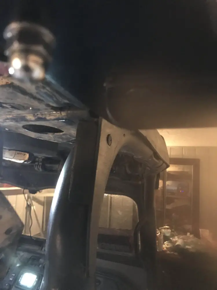

And finished with paint. Time for the cool part assembly. Won't be bad though everything was prior fitted.
322,956
Had to build blocks to put at the back top edge of the b-pillars so it'll seal. No big deal and they are virtually invisible, if anything with doors removed it'll look less cheap.

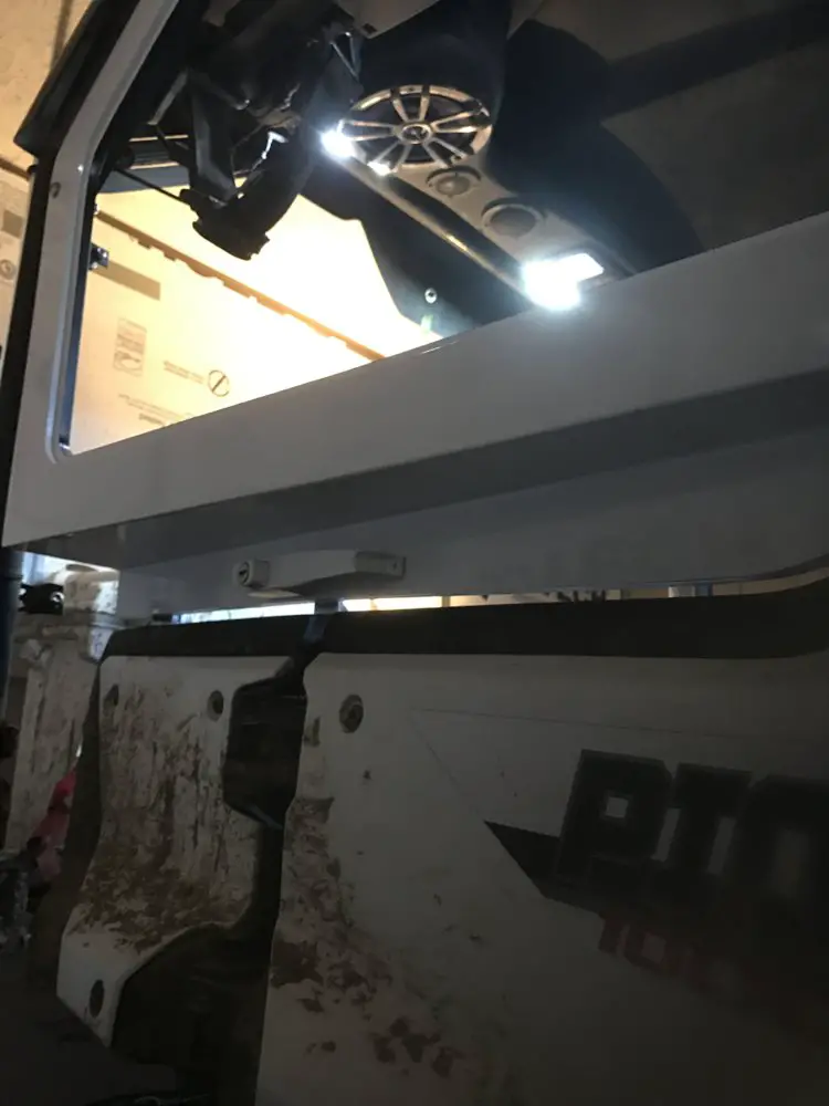

As can be seen in the photo I've used all stainless bolts nuts and screws. Done this all the way through the build, there's nothing worse the rust a few extra bucks is well spent.
Used white screen door latches they match well and provide easy access on both inside and out. I bought a matched set with locks so the back can be locked.

Used white screen door latches they match well and provide easy access on both inside and out. I bought a matched set with locks so the back can be locked. View attachment 28864
What is the latch catching? Looking great. I was kinda curious what you were going to use for that part.

Right now it's simply using the little guy that came with it but I will be building a better catch. It's super solid surprisingly and will work for next weekend. I was going to build an electric lock but sometimes simple is better and hey if I do break the latch it's 8 bucks. I like using easy to find items on a build it makes it easier down the road
