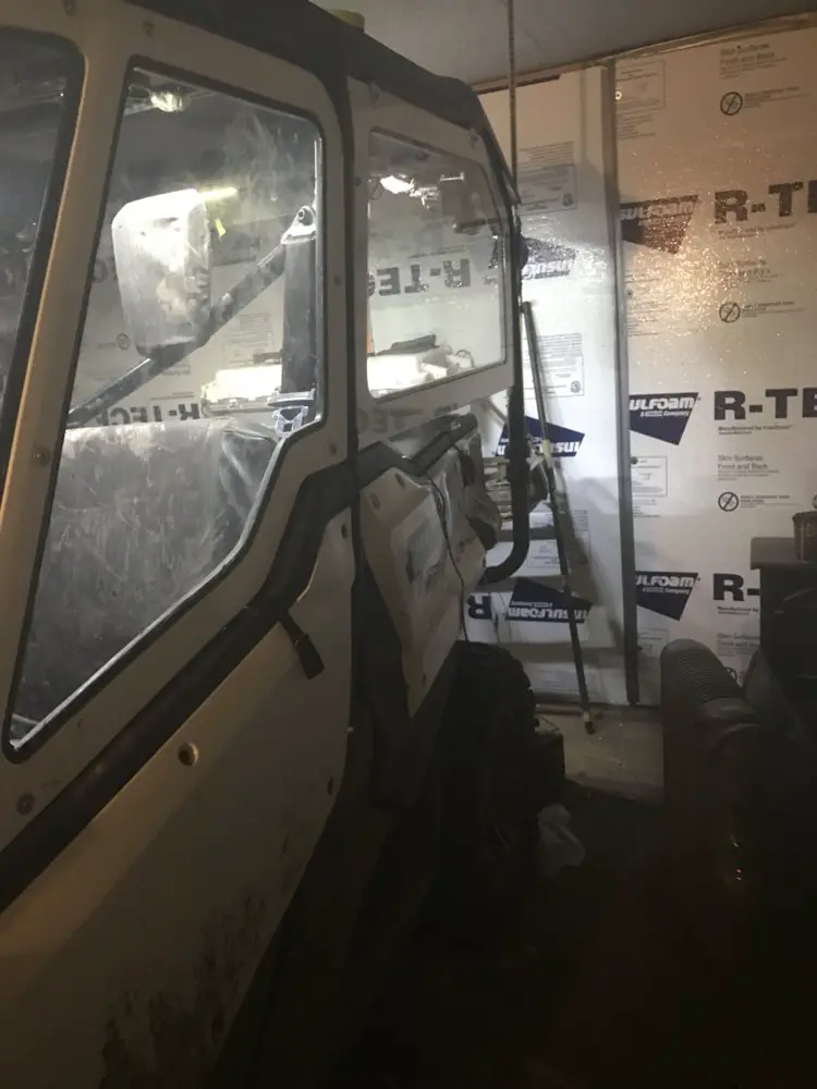

Finally back on it for an hour so far I'll at least get the two doors totally done tonight. Traced the windows
IMG 7707
better then normal lol just a little trimming.
42,070
322,785
To hold in the lexan I simply used an automotive grade 3m double back tape. Very important to get the good stuff. Norton works excellent as well. Go to the paint store get the good stuff Walmart does not work even 3m. As long as both sides are clean you'll have no problems. Make sure it goes on perfectly flat especially on corners. Sometimes separate pieces need cut.
IMG 7708
I always prefer to use overly wide and trim down to what's needed. This holds true with anything you use it on. Take time it's a very important step. I prefer double back on a project it's easier to work with the window urathane and looks great. Also if you have a problem you can get it off lol.
IMG 7709
42,070
322,785
IMG 7710

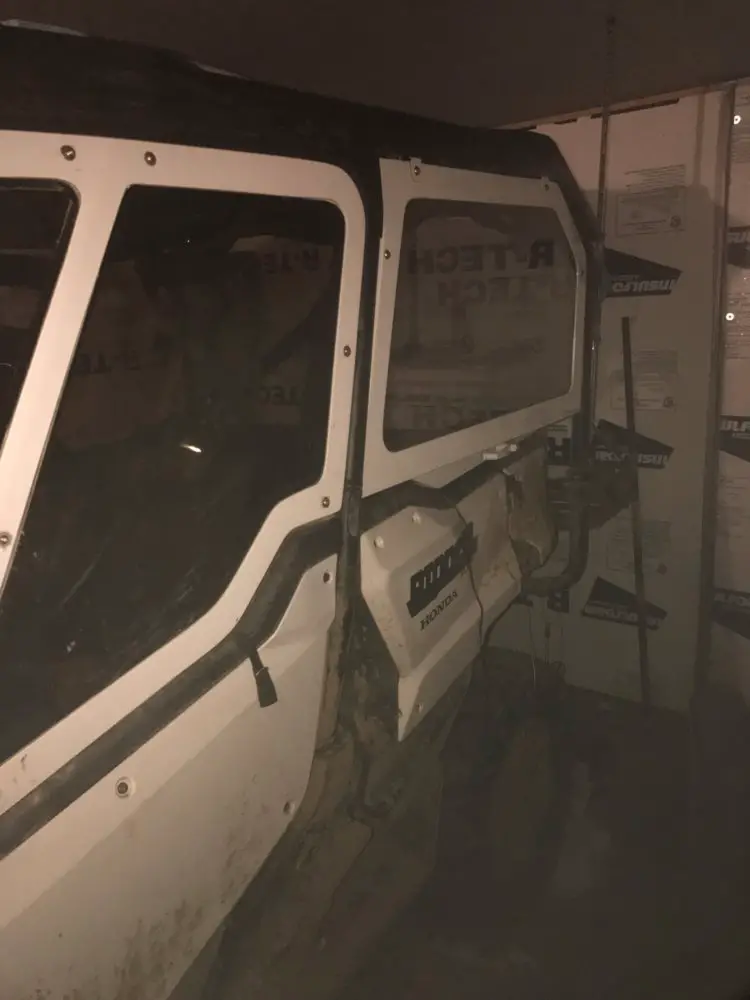

Ok the recessed tinted windows in. Made the door even more rigid. Very solid for what it is. Again nothing sticks out away from the rig the ROPS and roof will still take the hit. Will not be littering everywhere lol. We run around trees constantly very important to us. Again all stainless steel hardware no rust. Other the some trim (I'll black chip guard front edges of the doors to match factory rounds in the front doors, and also across the top and hinges) doors are in locking sealed and done. I'm beat, up in 6 hours headed for bed feeling better 5 out of 6 holes filled on the chop top. Not long now.
