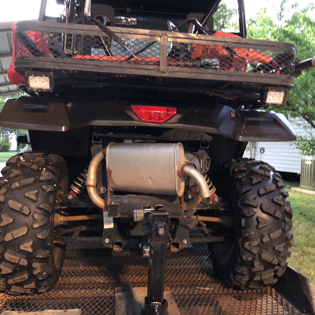

I’ve got a stock muffler to Silent Rider to an aftermarket muffler for triple quiet. No power loss at all & in 3rd gear just creeping around, it’s pretty dang quiet.
Interesting! Any chance you could take a video clip (of the sound/driving) and share it on YouTube or something?

Triple muffler setup on my 2018 Pioneer 500. Stock into Stealth muffler into a Dodge Charger pulloff muffy. May eventually try a Thrush Quiet muffler. No power loss & cruising in 3rd gear it’s super quiet.
I am impressed with that setup! nice. There is a free cell phone app to measure decibels called 'NIOSH SLM'. I ran the app in my honda 520 cab at near head level before selling (with roof and glass windshield) and got readings of 101.4 to 108.6 dB with WOT on pavement with stock tires. I sold my honda partly due to noise but i am sure many members would love for you to take a quick reading while driving with the app - at least i would!
App data for the run described above:
LAeq 101.4 dB
Max. level 108.6 dB
LCPeak 134.4 dB
Projected dose 4336.9%
