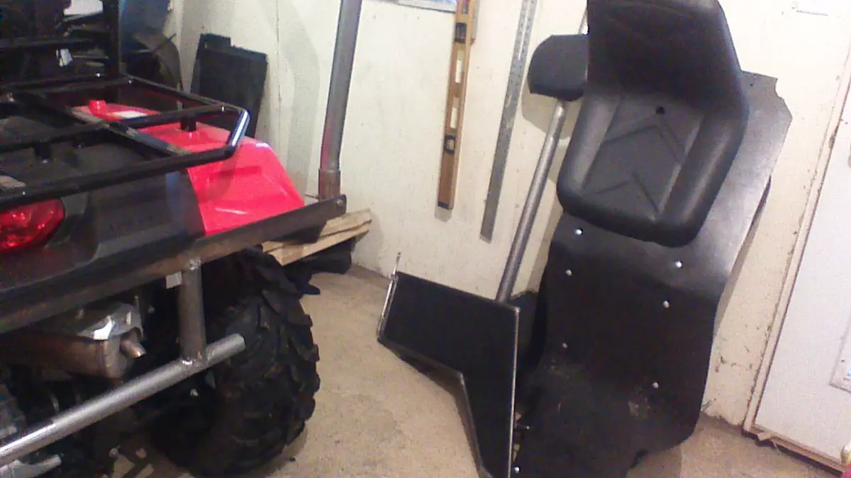

Could you please take a pic looking from above, I'm interested to see what have you used to cover air intake and engine and how it fits. Thank you!
Are those seats foldable or easy to detach? Could you still use back row as cargo?
Seats don't fold, really don't have any storage with the kids in the back, the center console is an old water softener salt tank I was using for a garbage can in the shop, cut one side out and shortened it, fit perfect.I may cut the top out in the back if I can find a 12x12x 9 deep heavy storage container with a good lid, it would give me a little storage,I timed myself tonight ,it took 15 minutes to remove seats and reinstall back rack.10 more and I can have the cage and bumper off.The rack fits perfect with the cage and bumper.I am going to redo the bumper, same design but bring it up on the ends to meet the ends of the angle iron.more strength for the cage, also made new mirror mounts,
