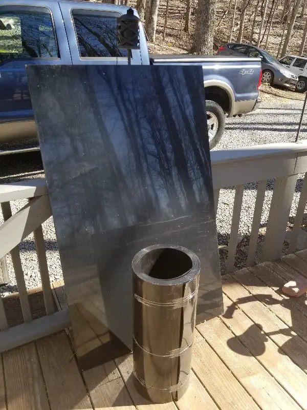

More goodies arrived today. Roll of HDPE for mud skirts/flares and a sheet of 1/2" HDPE for center skid section. It was less than half the price of UHMW so we will see how long it lasts. Outside skids are UHMW.

HDPE gouges much easier then UHMW, I am curious how long it'll last.
Me too. Would have to go back and look at the price, but it was less than half. If it works, I could build the whole skids for under $250. If I get a couple years out of it or even a full season, I will be happy.
I am sure it will take a while to gouge through a half inch....hopefully.

With all the rocks mind skids across, HDPE would be worn through by now. Being mostly mud for you with stumps not rocks you should be fine.
