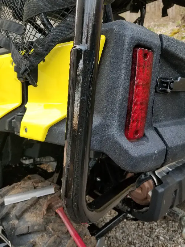

So did you do the other side to match?
Not yet, got to go have a flat on my trailer replaced right now. Going to this evening though. Wished they made a round half tube piece of UHMW!
Wouldnt be that bad with a heat gun

I got some 5/8" thick UHMW. Thought about milling a channel and adding some

That's a really great idea. Makes me want to cut my cage and then gusset the cut line just like that.

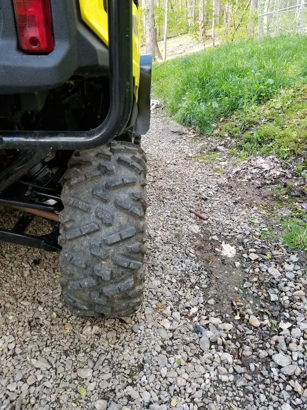

Finally got the rear spring spacers installed. Unloaded the machine was sagging in the rear. The springs had settled so all the top coils were touching.
Add all my gear or passengers and I hit every rock in the trail.
Added to the bottom.

Also got the sway bar removed. Wheel spacers will hopefully be here this weekend . Pretty much done for the Takeover. Have to mount the spare axle somewhere and some rear mudflaps.
May also try to make a chainsaw mount.
Seriously doubt I will have time for some tree kickers...
