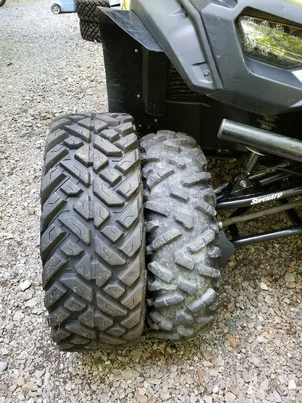

Combo weighs 57 lbs apiece. Got a tire grooving iron that may change that. Going to get a few trips on them first. Definitely not a mud tire but hopefully good in the rocks.
About an inch to clear a 5 gallon bucket

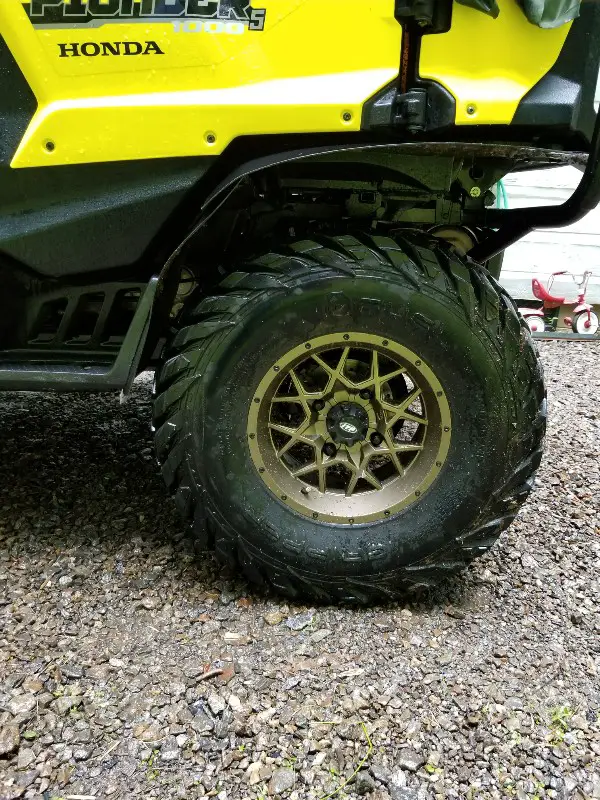

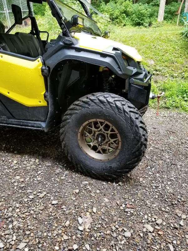

So, in between rain storms I got my arms finished and wheels and tires mounted.
I could be wrong but those look like they might be a directional tread and mounted all the same way. They probably function alright being a symmetrical tread but it would drive me crazy. I’m basing this off of forward travel and direction of side lugs. I like the bronze.

Look at the tread pic a few posts before. Unidirectional.
Nothing on sidewall about directional either. Got the tires at a great deal.
So far they go pretty well except deep mud, which I avoid if at all possible.
I'd not, I got a tire groove and not afraid to use it!

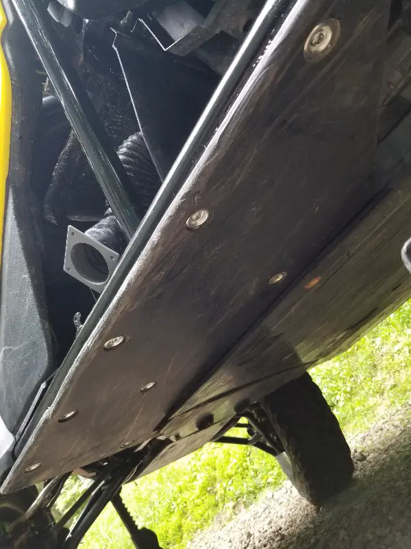

Shot of the marine fan and ductwork to pull hot air from drivers side of the engine.
Doing my Ruff Stuff tube gussets on side bars.

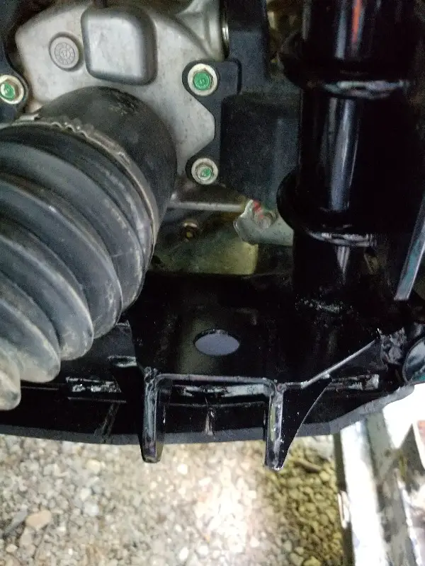

Steel nutsert installed. Everywhere else I just drilled and tapped the gussets.
20190715 155831 600x800
20190715 155545 600x800
Fully welded. That took awhile!
