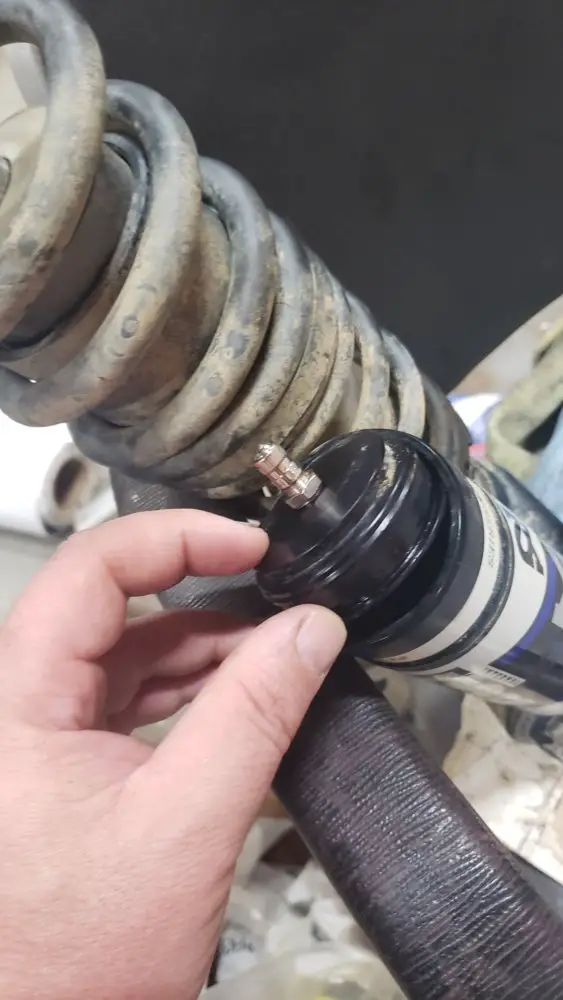

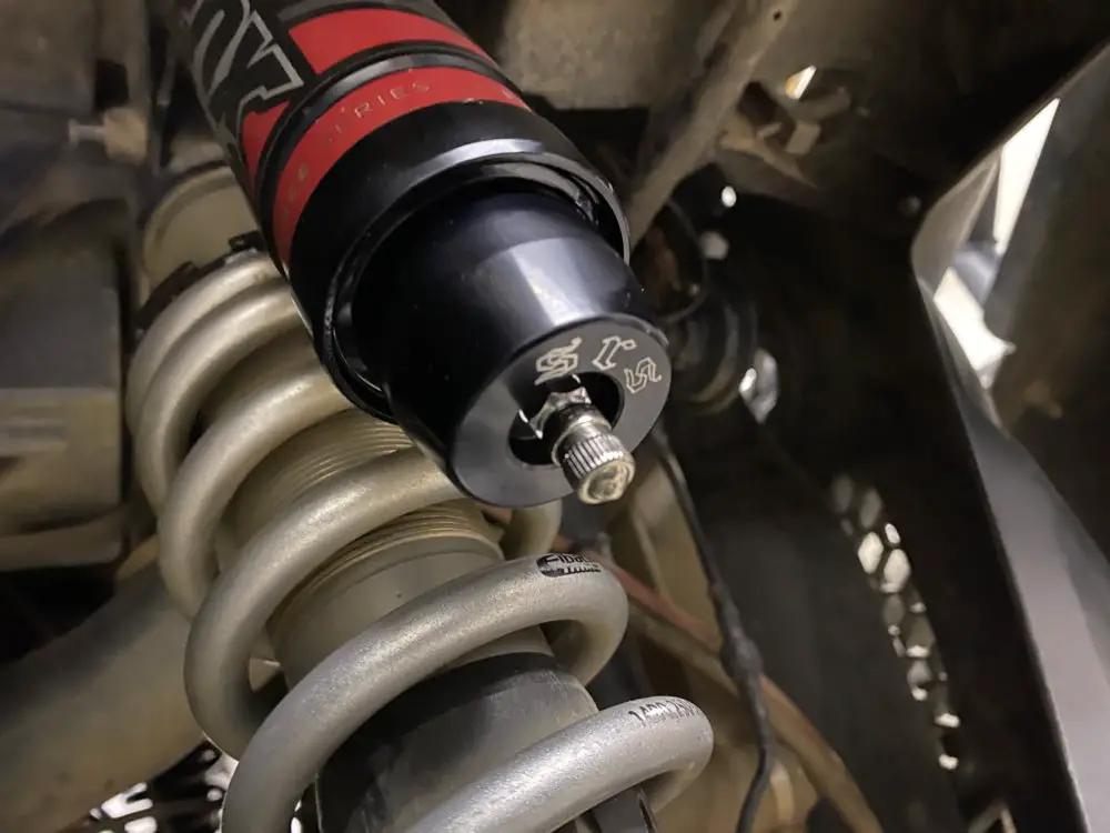

Back Somewhere around the Overland adventure (maybe even before) I recognized that something was off with the way my honda was riding but I could not quite place it. While I am still not sure I found "it" I discovered that my Fox shocks appeared to be really low on nitrogen. Basically what was happening is after riding (at some speed) over rough terrain a couple of my shock would make a "pop" or 'bop" sound leading me to believe that I might need to put limiting straps on as if they might be overextending at certain points... Seems that is a classic symptom of needing additional nitrogen.
Seeing some of the talon guys have issue with their fox shocks leaking nitrogen due to the rubber seal on fox shocks I just added in these
reservoir replacement end caps on to my shocks and had them recharged. - these end caps have Schrader valves which are not prone to leaks and much easier to recharge
Sure enough the right front shock (where the noise was most noticeable) did not have much gas in them at all (when released) and my rears were probably at half of what they needed. I just installed the shocks back on my honda last night so have not had a chance to take for a ride and test out - So while I am confident that the shock needed the charge I don't yet know 100% if this solves my issue
also adds in a little more volume of gas that may or may not help out with cooling

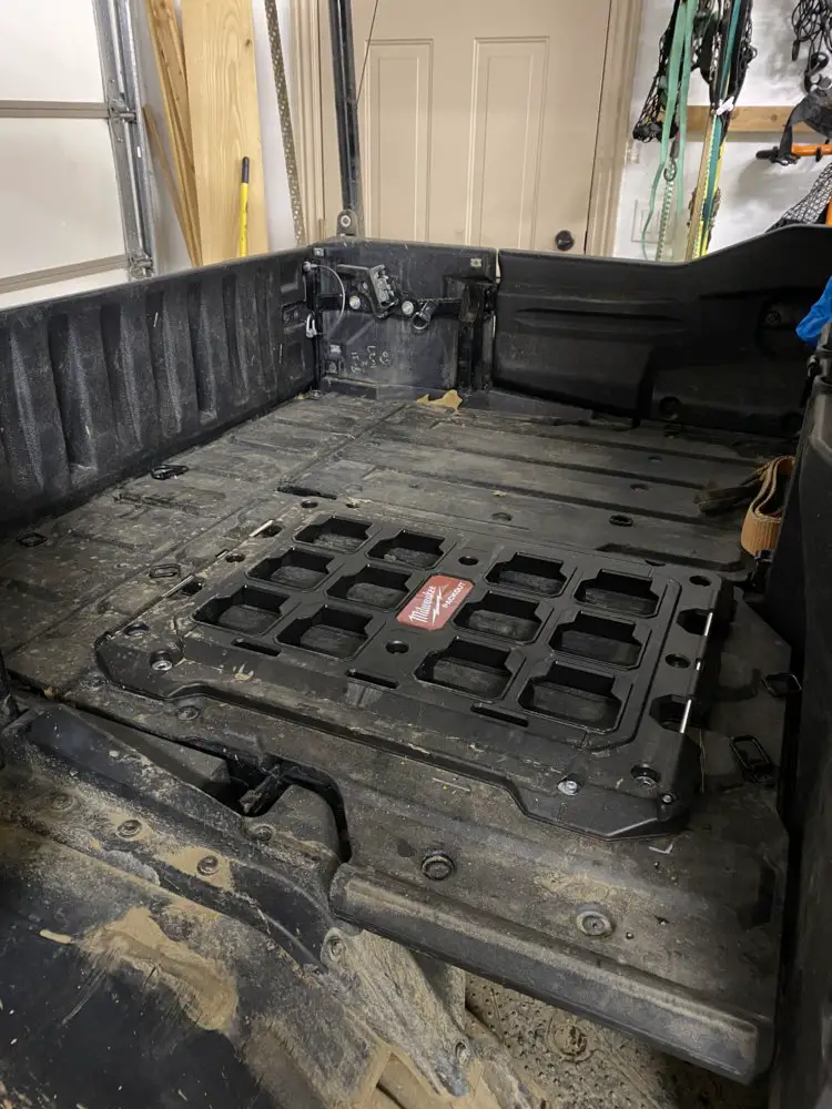

A couple months a go i guess i wanted to change something up so i decided to change out my storage boxes from Rigid to Milwaukee. For the money Rigid boxes are 2nd to none and the Milwaukee boxes are quite a bit more expensive - however were on sale over Christmas so i picked a few up. I have been quite pleased and will likely be expanding in the future.
One thing I definitely like about the Milwaukee pack out system is how they mount to each other and they fact that they make mounting plates that you can get

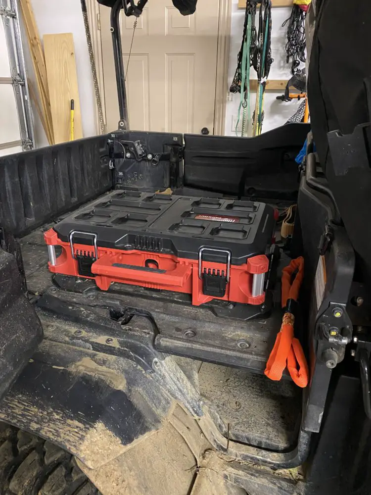

Below is a picture of the mounting plate secured to the back of my honda - the seat can still lift up as well
Picture of the Small Tool Box hooked in

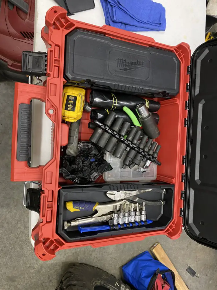

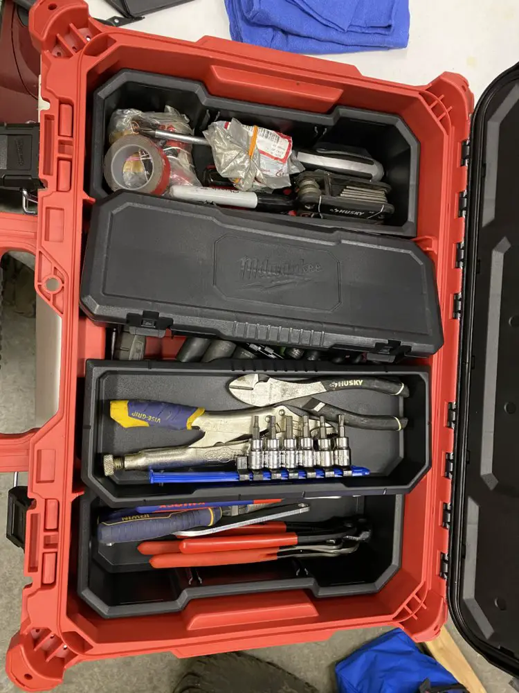

I have only purchased 2 of the Packout Boxes their Small and Medium size. the Small size is pictured above and below - it comes with 4 removable trays that sit off to the side - they are about the same internal height as the rigid small box but a little deeper - I can actually get all my tools I had in the small rigid box and my impact into this box - these pics below are early pictures when I was trying to first pack - but you can see the 4 trays

Are you securing the mounting plate just through the plastic backing of the seat? If so do u think it would hold two medium boxes loaded with junk in a roll over? I've got the plastic seat back off but I was wanting a little info before I start drilling holes.
I am securing them through the plastic seat back. while I have not used every screw hole I have used most- with a bolt and a washer and nylon nut on the back side. I did have to use a self tapper on one or two hole that went into the seat back frame.
i Am not worried about the mounting plate coming loose from the seat back. Two heavy boxes.. I am not sure I think there would be more of a potential for the boxes to possibly break the release tab and slide out in that direction than to come straight off.
