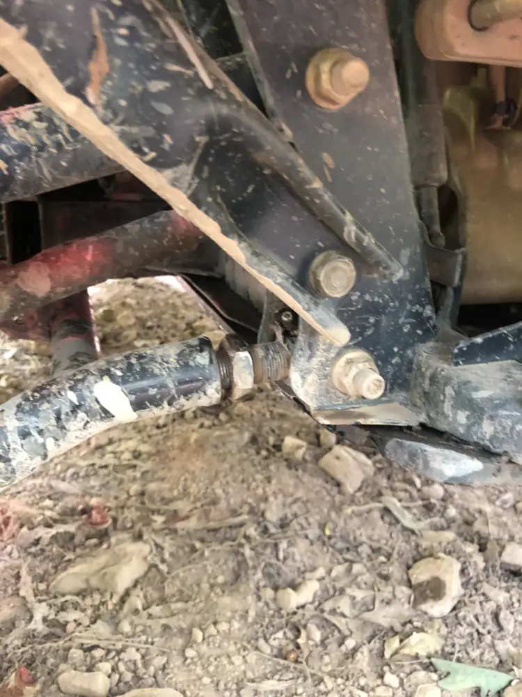

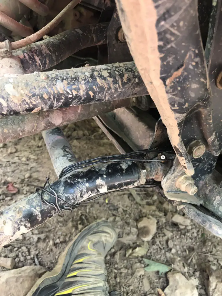

While I love riding at buckhorn I swear something breaks every time I am out there.. today was no exception .. riding with @my99svt , his wife and some of our Rzr friends I am leading the way when I hear a unusual noice from the drivers rear tires area... I stop and look .. see that the jam nut on my SATV a arm appear to have come loose.. no problem grab a wrench give it a yank and pop ... the remaining threads in the A arm expose themselves.
4468416E 7DDA 48D6 9680 BF71DA08FF94
No worry bailing wire to the rescue we winch me up on the side a little and I wrap bailing wire around it to hold it together... luckily we were 1/2 mile from some blacktop and gravel roads and made it back to the parking place . I will have to call super atv Monday to see about a warranty replacement.

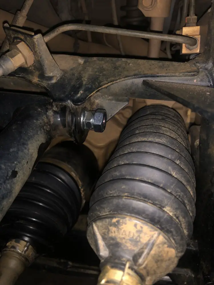

Well the holes for my upper A arm bolts were getting worn a little more. Big Thanks to @Neohio for the weld washers and bolts that he worked up.. I was finally a ole to get. A local welder to weld them on this past week - I really need to learn to weld. I took the Honda out this afternoon and it is nice to be solid up front again.
First two pics are a comparison of some other weld washers next to the ones @Neohio had made
3A3105BF 1A72 4F8F AA64 FF529C86A35F B2BF7F20 E414 44BB 960D B5E53C4E9201
Pic of the weld that was sent to me
681DF45C E42C 4369 A853 DA6EFEEAF639
followed by pictures of the final product
ECABDF30 F46B 4806 B0E9 DBE56CD3B227 1B2E4B40 A5A8 4DEF AA49 561076183D0D
