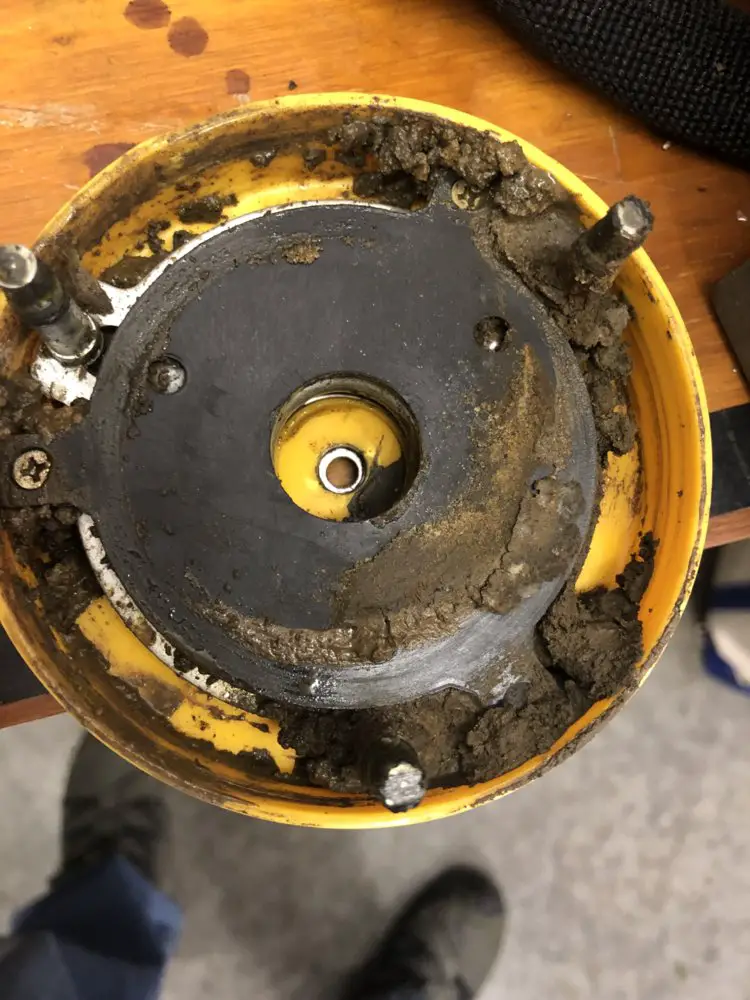

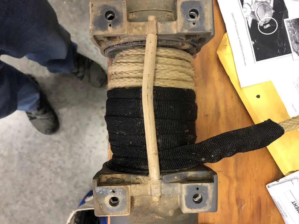

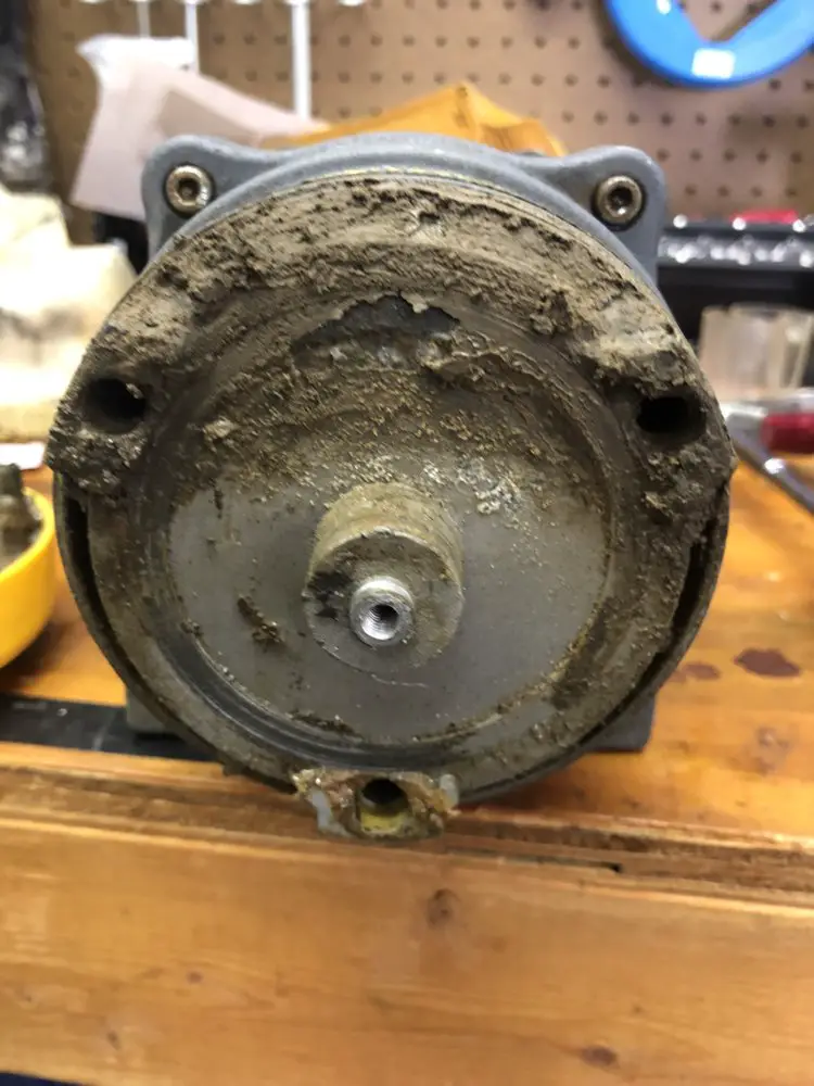

I was having a hard time switching my winch to freespool so decided to pull it and take apart to see if I could clean it - I am by no means a mud guy so I was a little suprised to find
F9EB92E0 D999 42A5 A428 A51AD5EC95D9 93315C0C 460C 4DAB 9186 426665EC3926
And even a bent rod on the bottom
View attachment 110322 View attachment 110323
Call superwinch, they will send you a new spanner bar for free.
Ask me how I know.....
My son put his feet on the dash and hit the winch in switch until it popped. New winch hook stopper, hawse fairlead and spanner bar and I'm good as new other than the tweaked mounting plate. I've since added a winch power switch.

Time to turn it into a rear winch!
I’ll say I have been happy with this winch, I have winch up some good hills (Overland, Puncheon camp trail), held @JTW up on widowmaker as his tie rod was fixed, and now that I got it cleaned out it is smooth switching to freespool. It has been a good winch.
