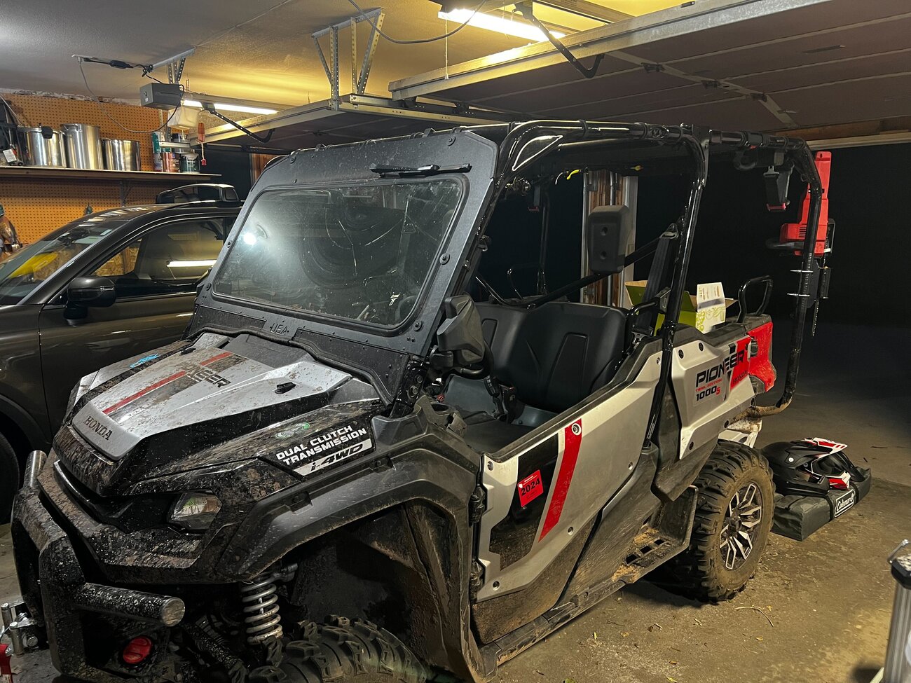

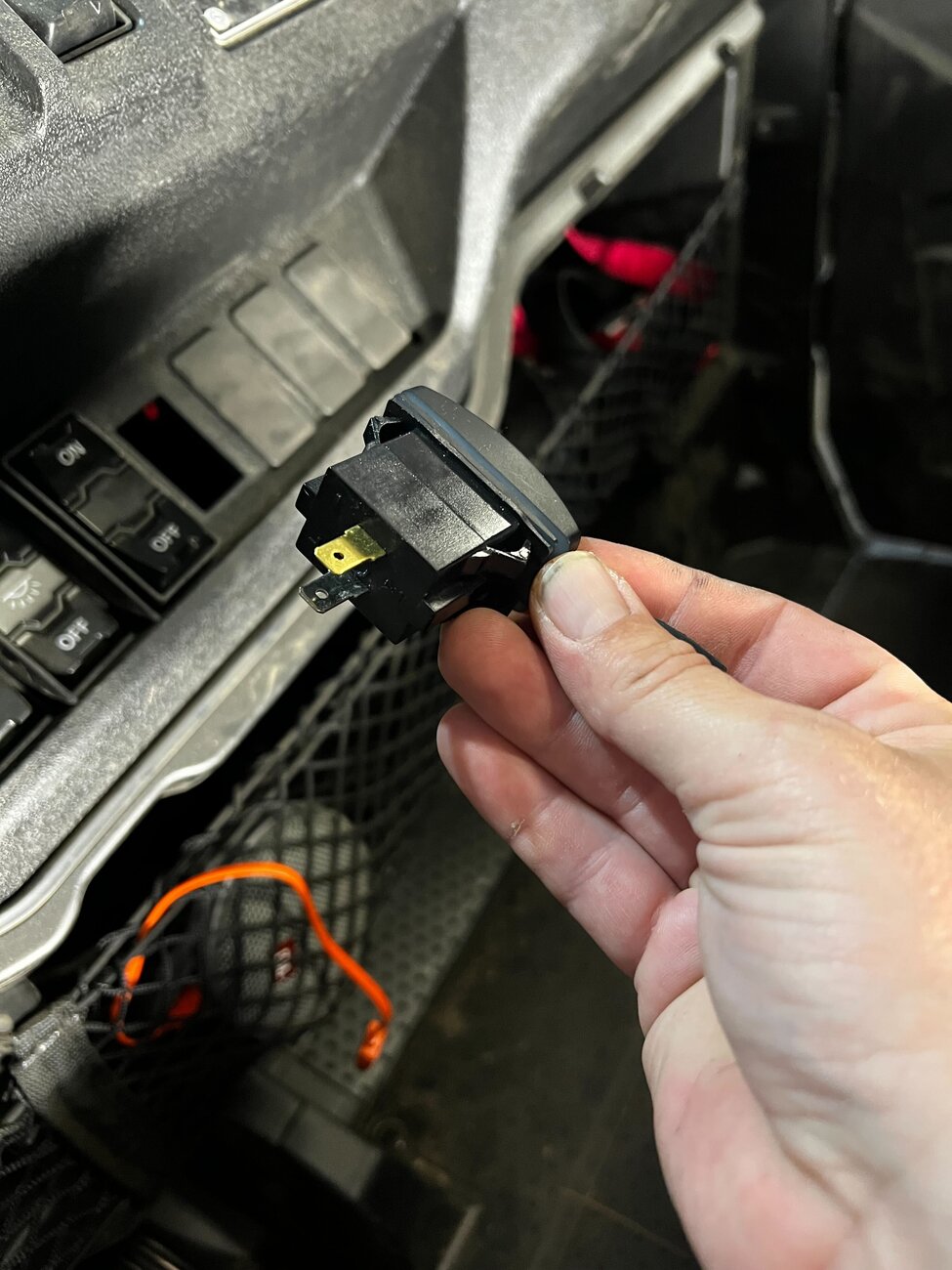

@Remington - haha! Here's some pics.
First is the vehicle itself
Second is where the pre-existing on/off is and where i'd like to install the USB rocker
Third is the back of the USB rocker
@GRANITE - Thanks, checking out the harness. Will reach out if I need further help.

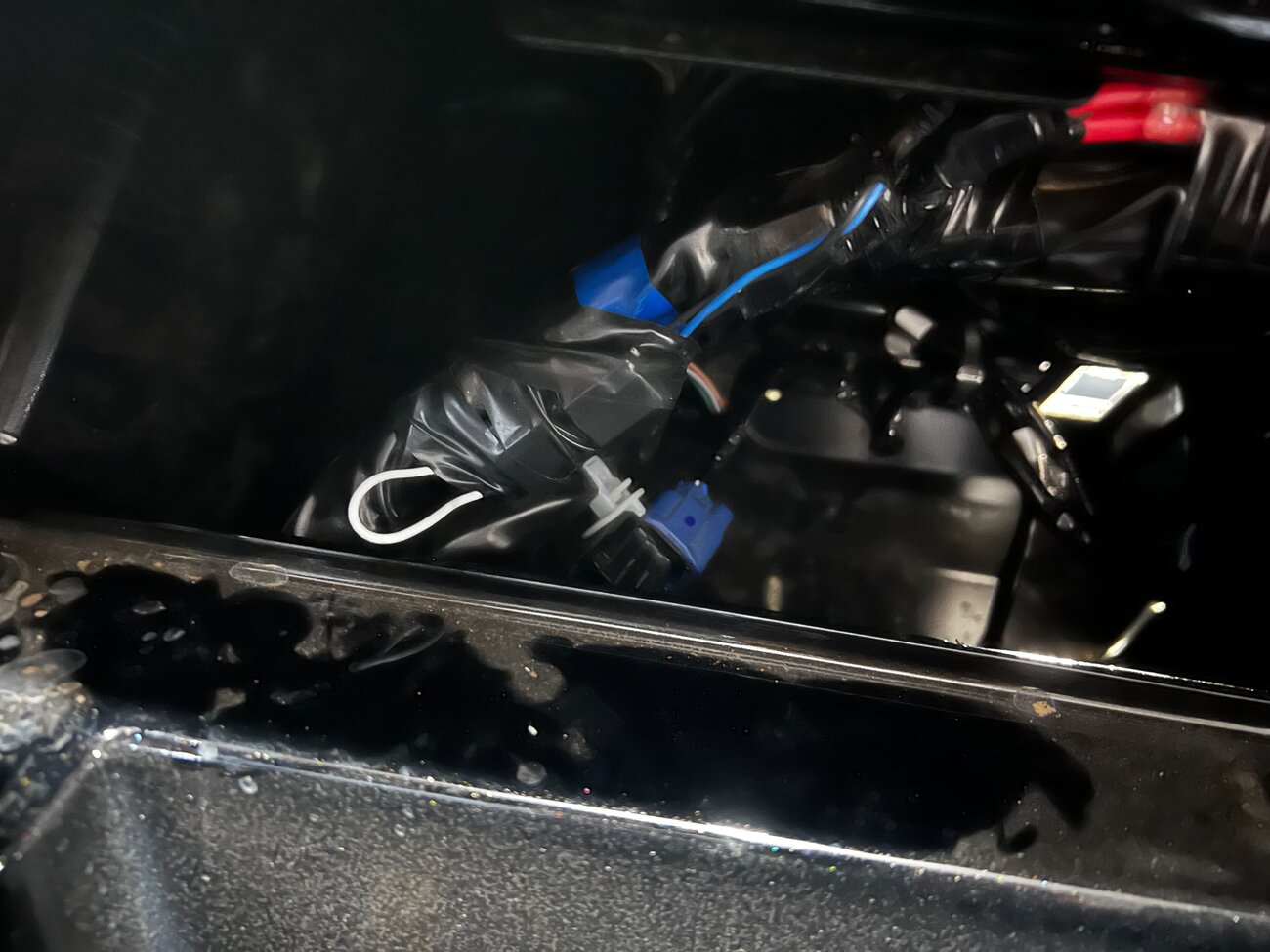

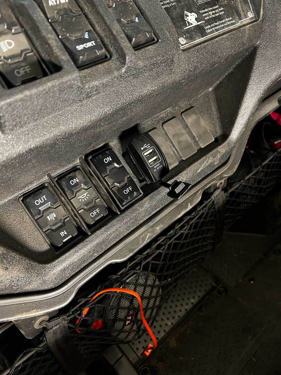

@GRANITE - Thanks, just bought the harness. Makes perfect sense now. Oddly enough I had removed that and saw the loopback and was like WTF, I think this is right but wasn't confident so I taped it back up. Now that I see the harness I think I can run with it.
Yes remove the blue tape and the connectors will make sense
