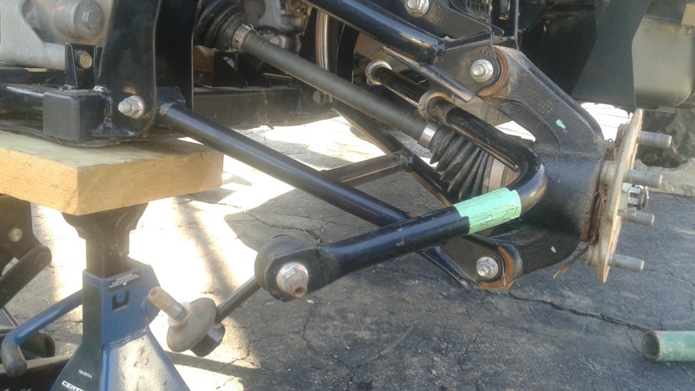

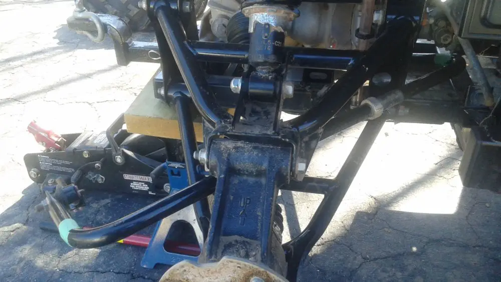

I took mine out in one piece from the passenger side with wheel off,a little tricky but you'll figure how to slide it out..I also marked the sway bar just in case i have to install it back..

Would it be ok to just leave the SB in but disconnected?
Took mine out the other night. Completely removing it took about 5 minutes from start to finish. Incredibly simple. Lift the rear with a jack, take off the passenger side wheel, 12mm socket to remove the swaybar links from the arms, 15mm to unbolt the swaybar from the frame, and it slides right out like in the pictures. Put the wheel back on and done.
I know everyone says they are shocked at how different it rides and handles, and before taking it off, I couldn't grasp how it could be that much different, but it is. Just riding around in general, it's smoother and less jarring. There is without a doubt, noticeably more body roll and in certain circumstances, I could see that leading to an increased risk of a tip over. But for 99% of situations, I can't see it being anything but a positive change. Bumps, curbs, ruts, the neighbors dog, it seems to just float over all of them now.
Took it through the neighborhood with some winding turns at just under 40 and while the roll was noticeable in the turns, it wasn't pucker inducing either. Maybe really sharp turns at speed would be different, but I've never been in a habit of taking turns like that fast anyways, and realistically, where I'd encounter those kinds of turns on trails, there's no way you'd be going that fast anyways.

I was able to work mine through and out of the drivers side without removing anything other than the sway bar itself. I have stock tires and all four were on the ground.
