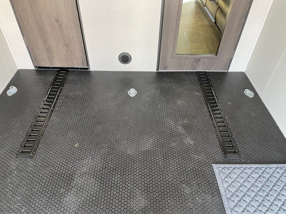

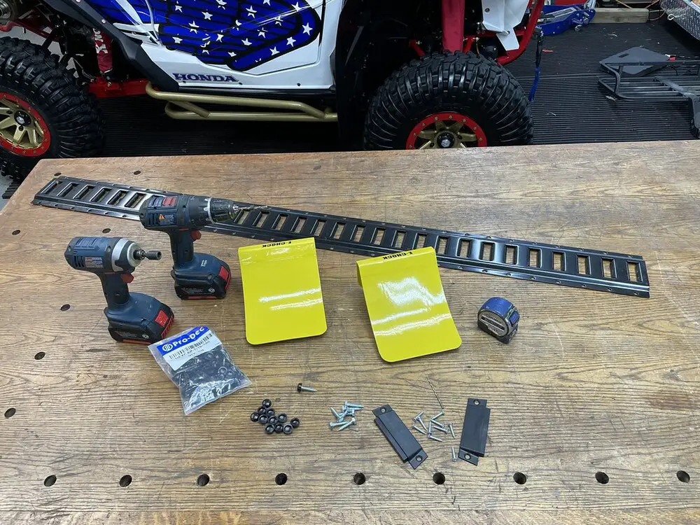

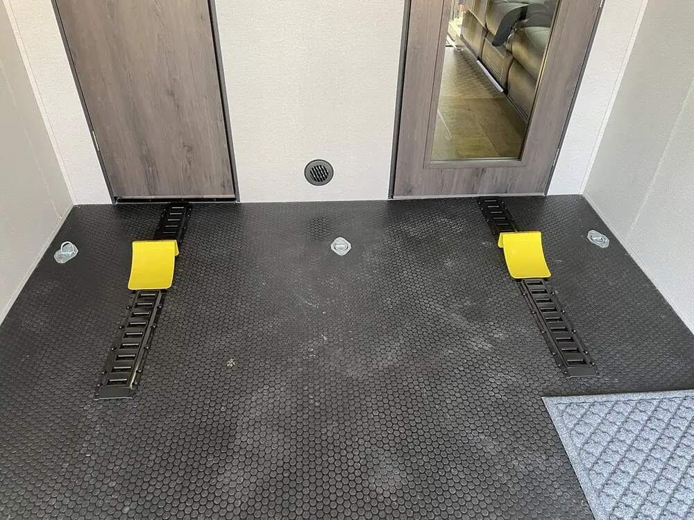

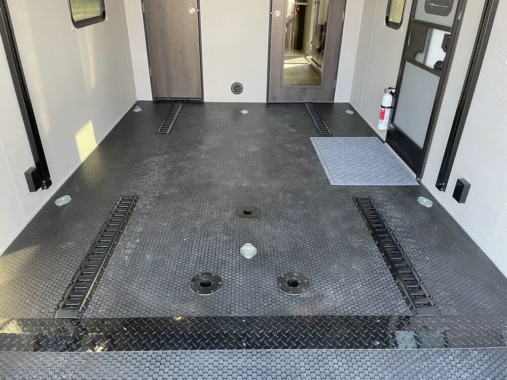

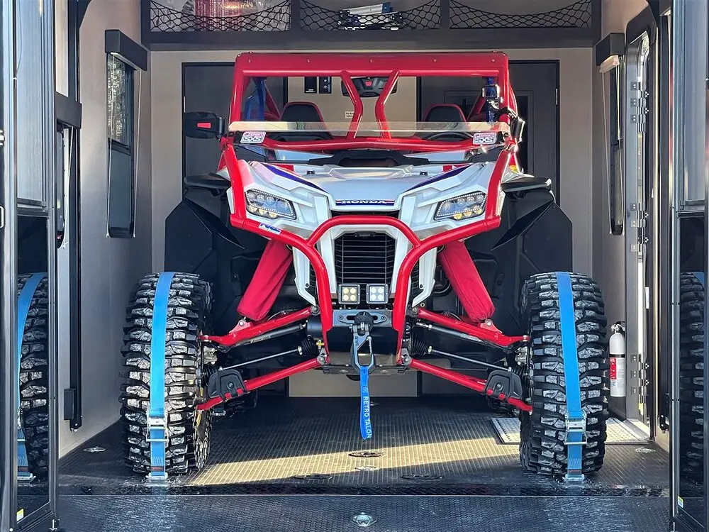

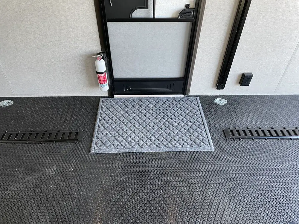

Finally got around to getting the E Track installed in our new Momentum 31G toy hauler. I've procrastinated for months on whether I should bolt it thru the floor or do lags. Finally went with 1 1/4" x 1/4" lags. I cut the E Track to fit our Honda Talon's footprints and installed it with the Erickson over the tire straps and E chocks in mind. There are 92 lags in pre-drilled holes holding the 4 pieces so I feel confident that it's not going anywhere. I used plastic caps to finish off the ends and plastic caps for the heads of the lags. Made for a pretty finished look and will hopefully minimize any trip hazard. I'm quite pleased with how it came out.
Here are the links to what was used:
E Track: Black Powder-Coated Horizontal E-Track Tie-Down Rail
End caps: Plastic End Cap w/ Install Holes for Horizontal E-Track
E Track wheel chocks: https://www.etrailer.com/E-Track/Erickson/EM09162.html
E Track over the tire straps: https://www.etrailer.com/E-Track/Erickson/EM59139.html
Bolt head caps: 7/16” Black Hex-Caps - bolt caps for 7/16” hex heads | Pro-Dec
50900189357 4d42ddd964 b
50899357303 f417939f5c b
50900189097 062c96bbe2 b
50900188907 60b8e60c19 b
50900188732 df69075a17 b
50900188592 d8ec2a8727 b
50900069761 94573a3ea9 b
50899357523 7656f6c29c b

What length of E-track did you cut to on each location? Thinking of just ordering four 3 footers for my hauler.
TerryH
TerryH
Sep 13, 2019
664
2,241
Springdale, Ar
I'll have to measure to be for sure since my memory is nonexistent any more but I believe it was 42" for the front and 46" for the rear. If you are going to use the E track chocks you'll have to allow for some extra.
2021LiveValve250R
2021LiveValve250R
Nov 17, 2020
31
42
Ohio
I'm just going to order two 8' sticks then i'll be covered, thanks Terry!
