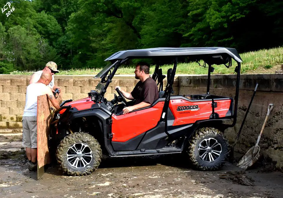

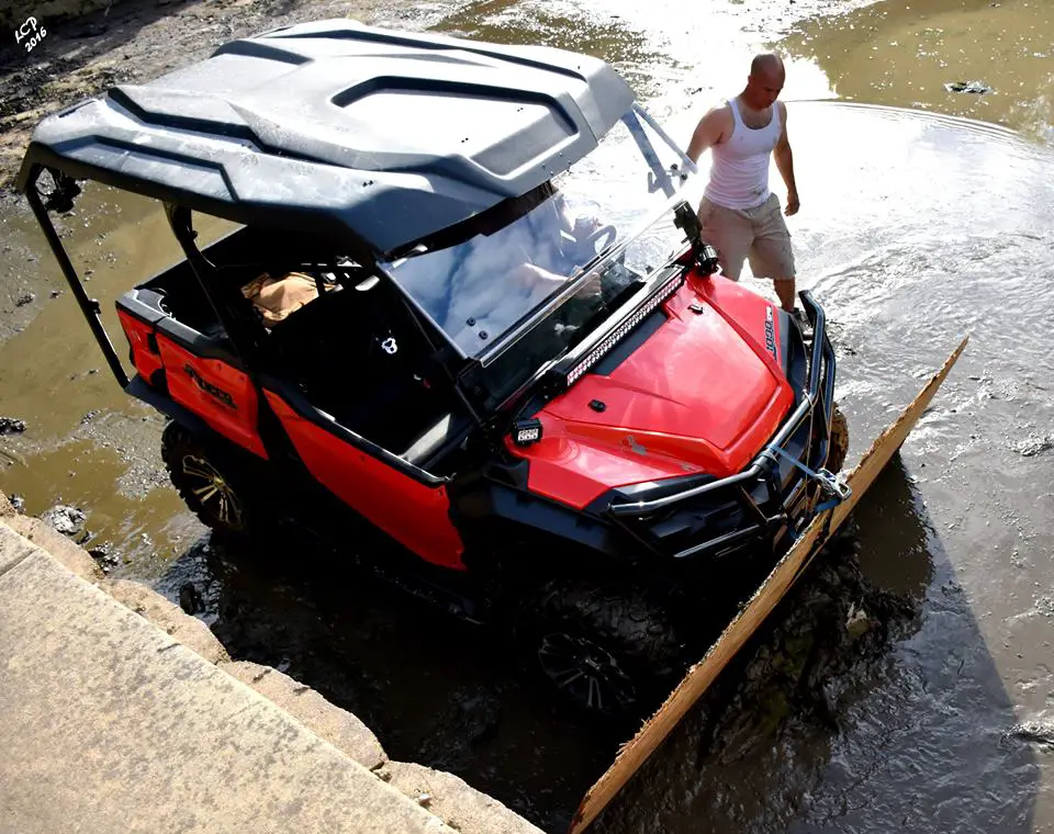

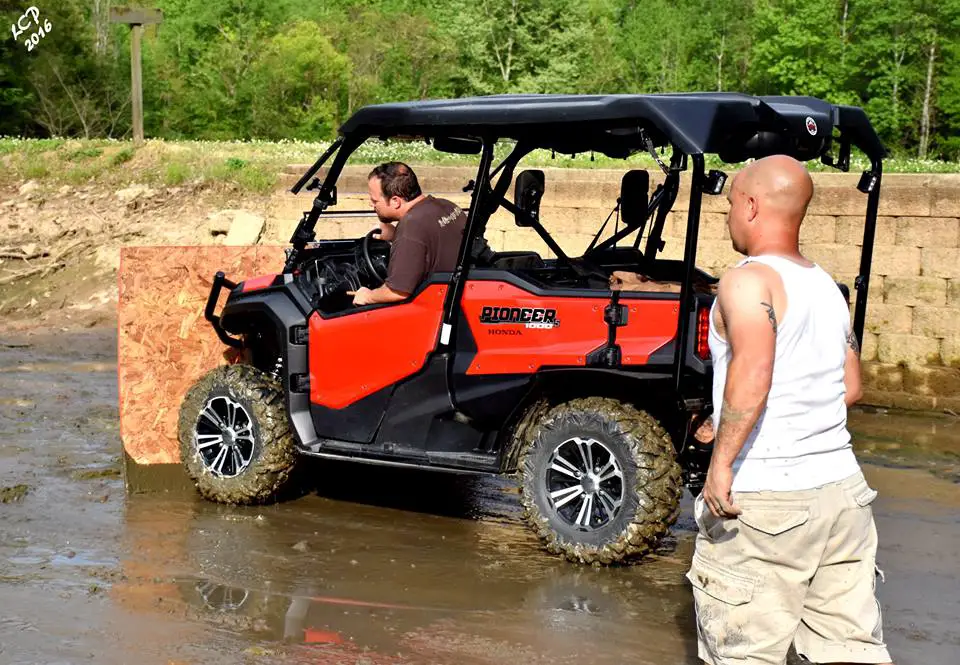

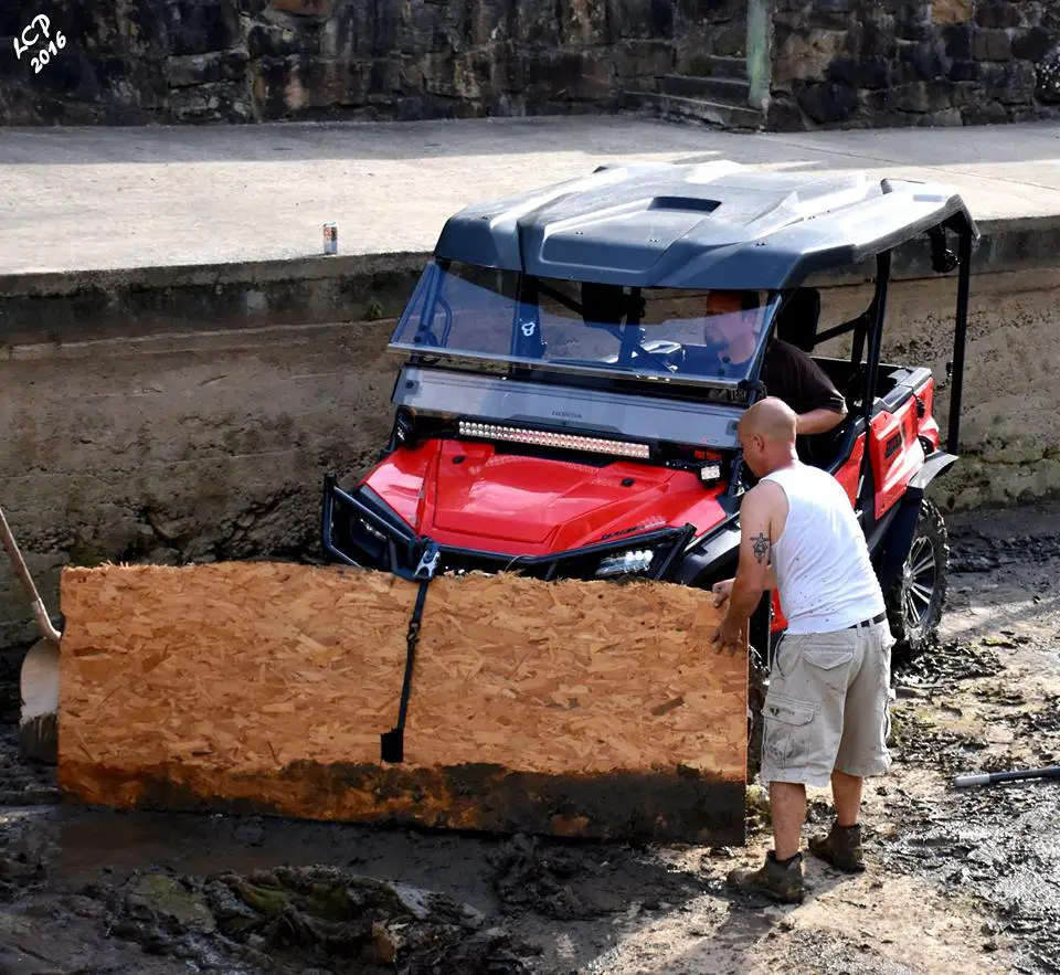

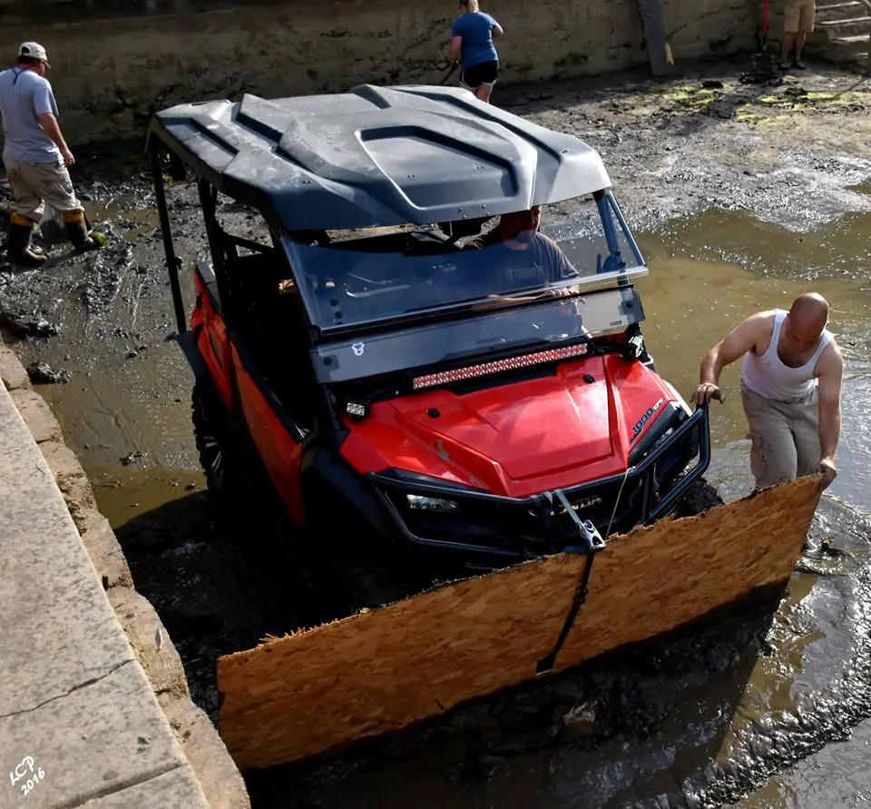

man, there were 5 or 6 of us out there shoveling mud out of the swimming area at the lake. the area we were trying to clear is about 8,000 sqft. after about 30 minutes we devised a scheme to put the pioneer to work for us. what would have taken us hours got cleared out in about 15 minutes with the pioneer, which translates to more time to focus on important things like beer and pizza!lol

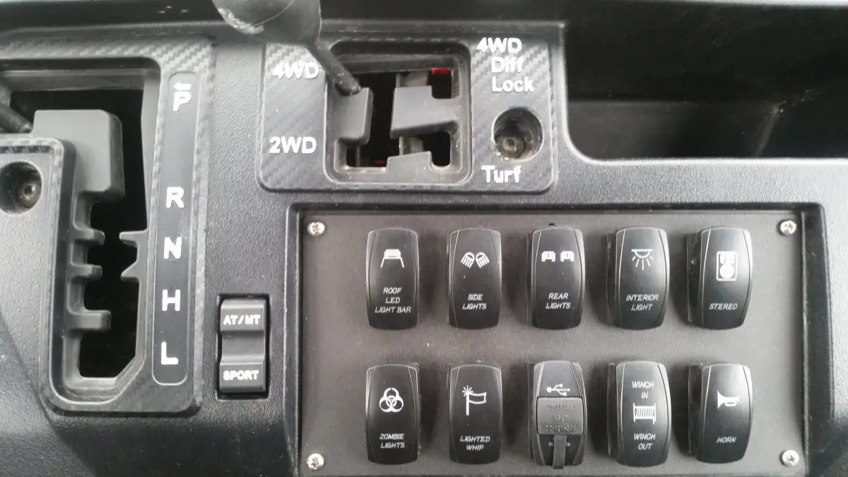

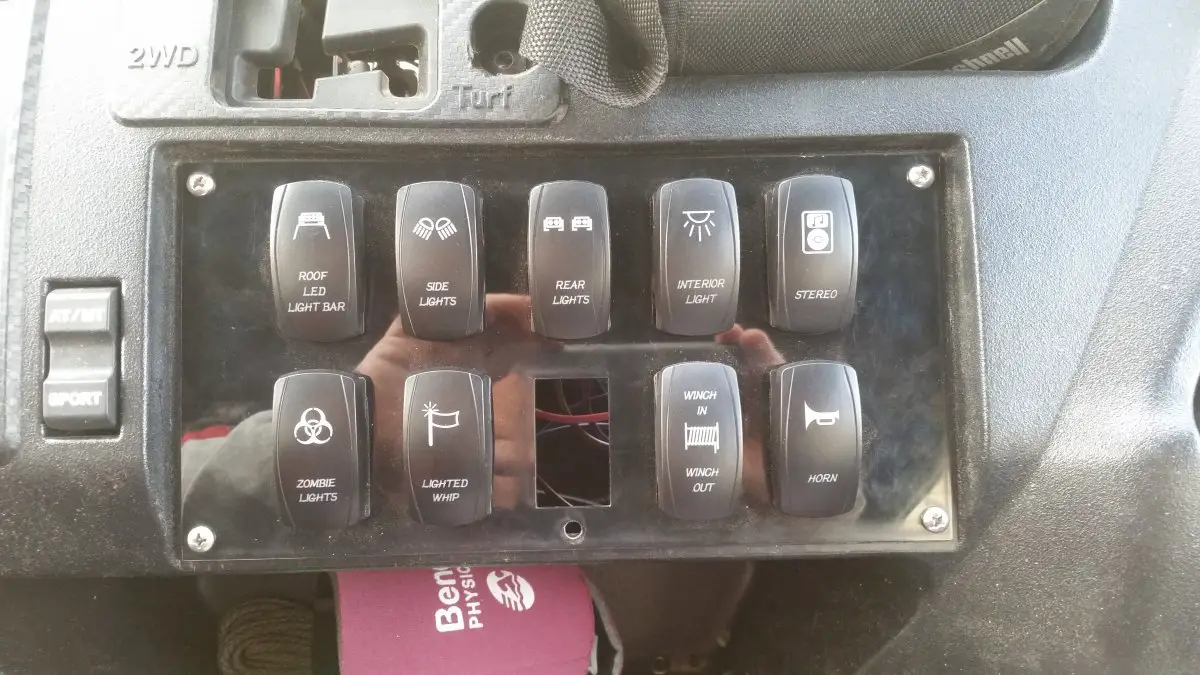

OK, I wasn't happy with my first switch plate that my friend made for me, so I ordered one from a professional. Much better fit, and it's powdercoated metal instead of plastic. The holes are also a much tighter fit, so the switch seals are nice and tight.

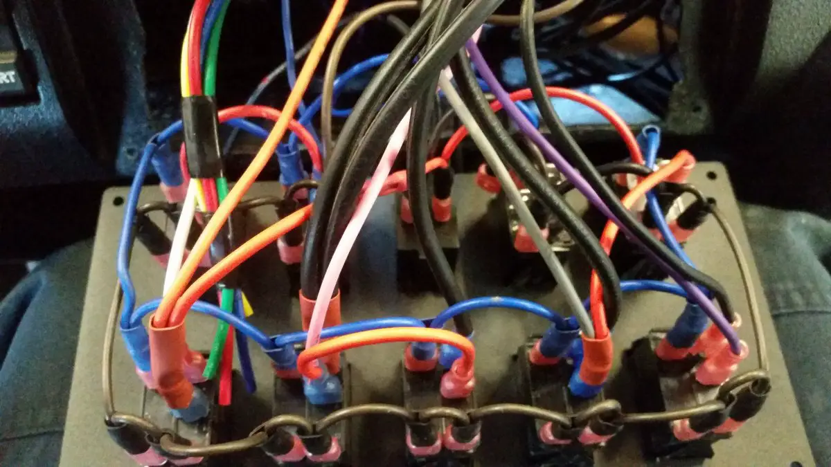

Here's a pic of the "rats nest"
And the front view
Something I forgot to mention, the double black wire you see is landscape lighting wire. I found it to be a good option for running positive and negative wires in a single package. it is designed for direct bury, so it is heavily insulated and is 16-18 gage, so it is good for smaller lights and accessories. I used it for all 4 of my light pods (2 front and 2 rear).

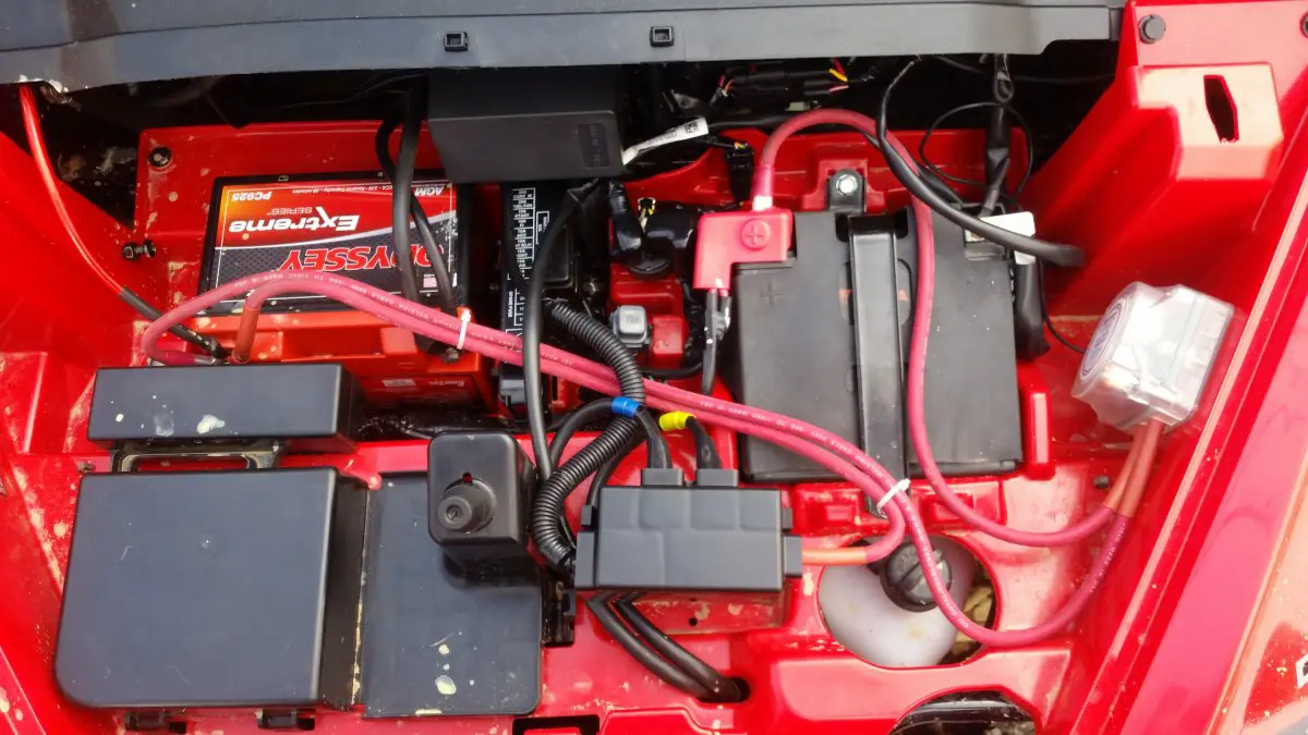

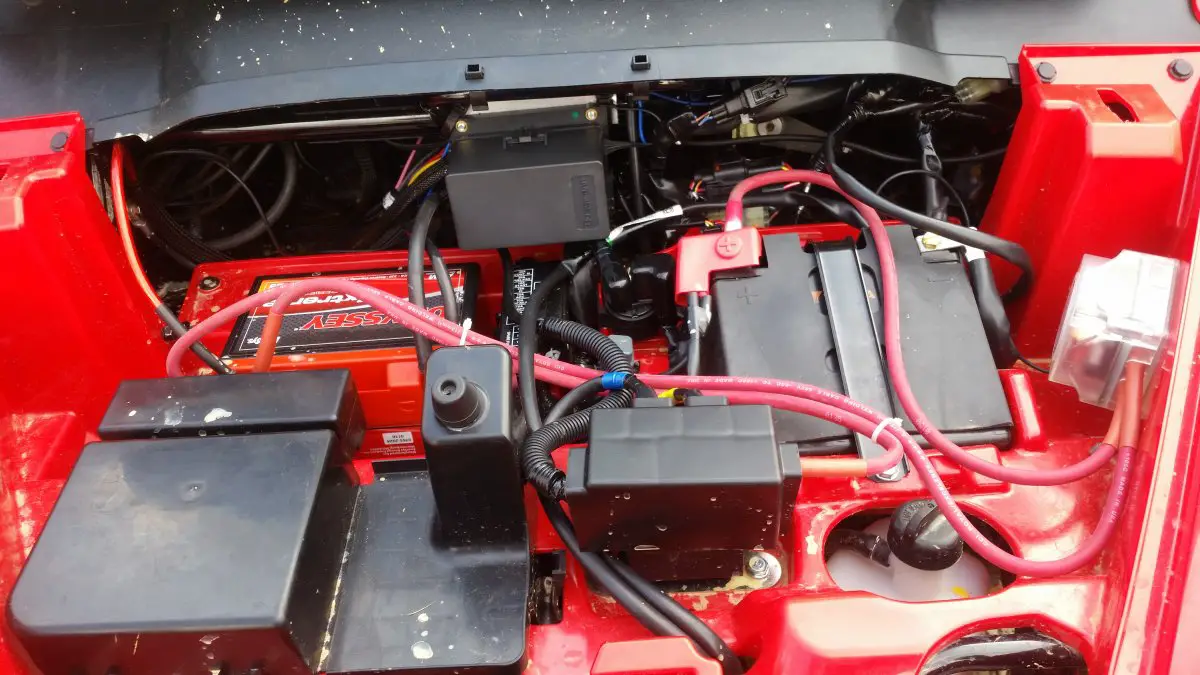

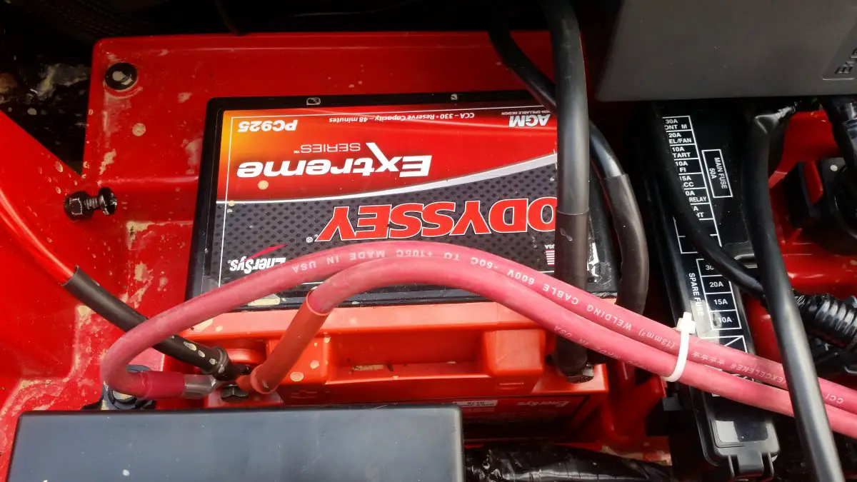

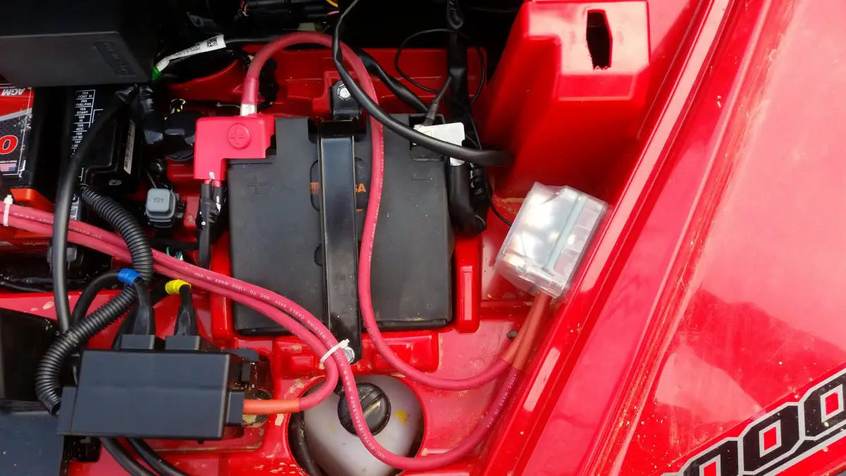

I didnt realize how time consuming this thing would become. Wiring and electronics are 95% done. Still trying to decide whete to mount the red led strip. Its ~6ft long.
Also still waiting on my usb outlet for the switch panel.
Under the hood is complete, although still debating inline fuses on the pdm lead and isolator leads.

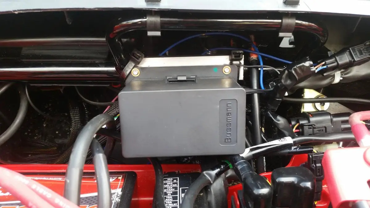

Found a nice out of the way mount for the pdm.
copied @JACKAL on the:
Universal Relay/ fuse auxiliary distribution box jeep, Cooper Bussmann Off Road

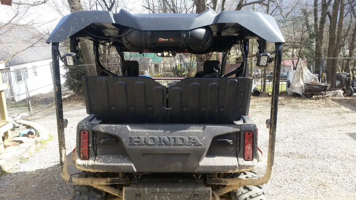

Used the net mounts for the rear lights.View attachment 9959
The PDM is wired hot all the time from the auxiliary battery so my accessories will all work without having the key on. The PDM and winch are grounded directly to the frame, and the stereo is grounded directly to the roll cage. Everything else is grounded to the "bus bolt".

The PDM is wired hot all the time from the auxiliary battery so my accessories will all work without having the key on. The PDM and winch are grounded directly to the frame. Everything else is grounded to the "bus bolt".
Wow you've got alot of time invested in that thing. I'd like to check it out more closely some time when we get the chance.
Reactions: PioneerPete
39,129
FYI. "For y'alls info" is what that stands for in AL
Just to be safe, I used a switched power source for my rocker switches. So, even though the PDM has power, the accessory won't operate with the key off if I leave the switch on. So far I seem to like it, I may go back and make the stereo switch be hot all the time so I can turn it on with out turning the key. Right now the only switch that will power up an accessory is my interior lights.
Reactions: JACKAL
39,836
272,137
That is exactly how I wired mine up as well.
I guess everyone has their preference. The main reason I installed the second battery and isolator was so I could have my accessories hot all the time and not jeapordize the primary systems and primary battery. I like being able to flip a switch and have lights, stereo, winch, etc without digging the key out and having to listen to the annoying buzz sound in the primary systems.

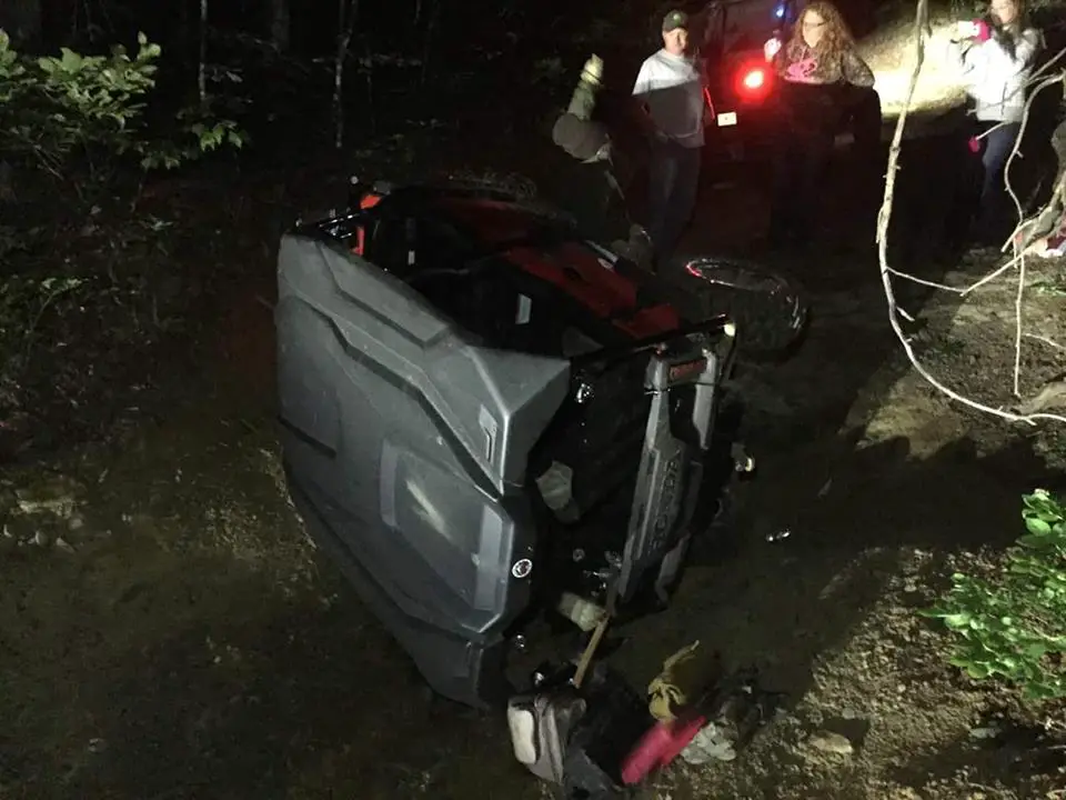

remember when your parents used to tell you to stop crying or they would give you something to cry about? well I got tired of hearing my wife whining that the sxs was too dangerous, so I figured I'd give her something to whine about...
Honda Roll at AMA
Reactions: sharp and vince
39,129
First, I hope no one was hurt.
Second, I hope the vehicle wasn't hurt.
Third, I remember your motto at Royal Blue..."always use 4x4 and when it doubt, throttle out".
Is that roll over due to that motto?
Reactions: pct and PioneerPete
39,129
BTW, it looks like y'all went to Prentice Cooper. I love that place. I used to live up there and rode those trail weekly.
