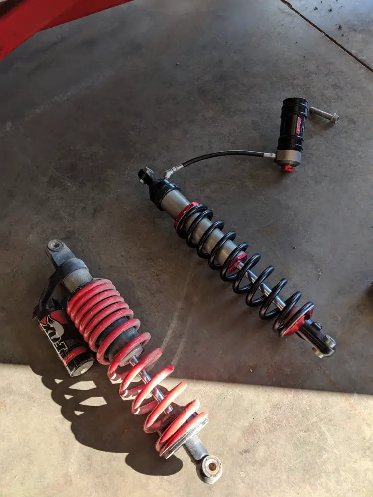

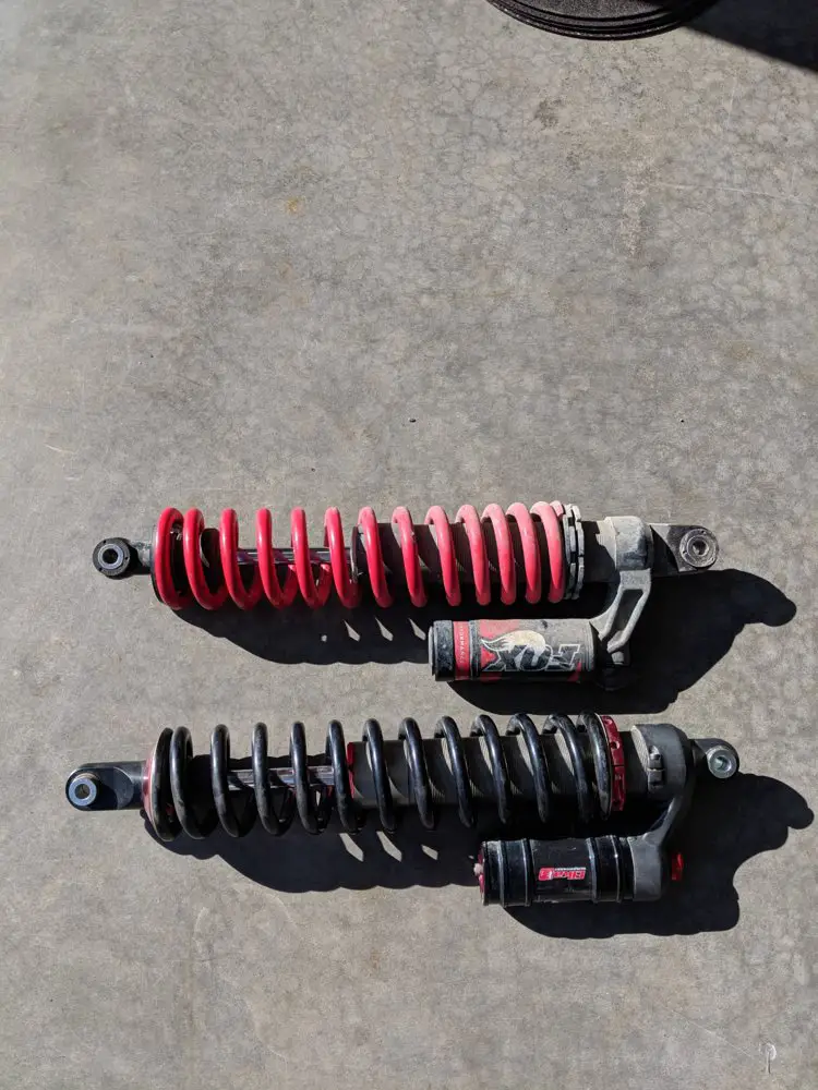

Too bad ya couldn't get the Fox shocks off :(
The rears had the shields busted off and the right front shaft was bent. They had about 1200 miles on them and were basically ready for a full rebuild

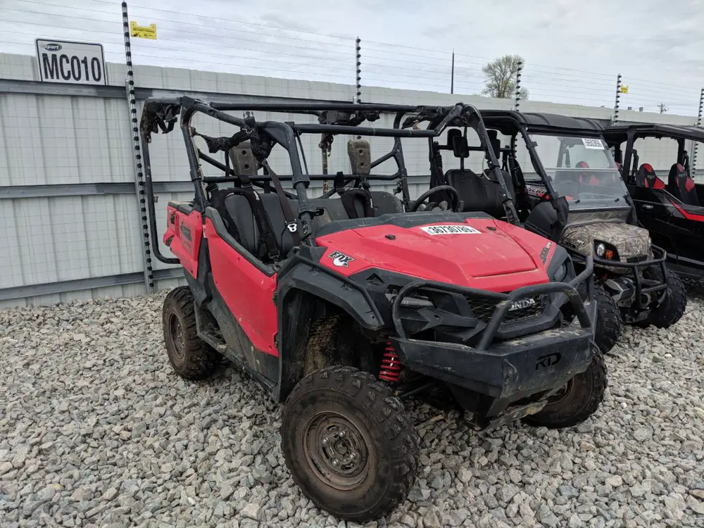

They'll make somebody think they are getting a good deal at auction

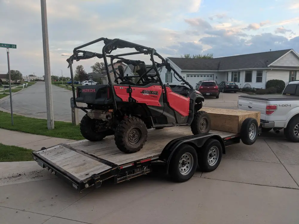

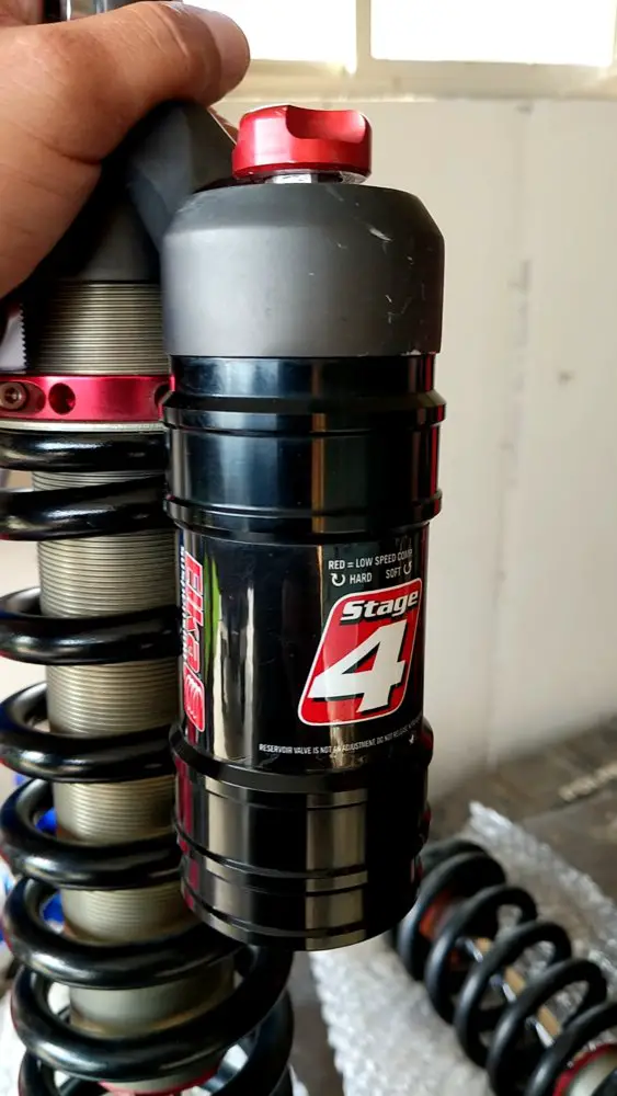

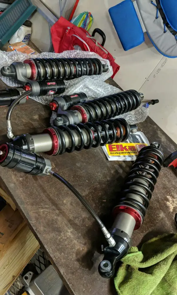

Looks like I have a new project.
Received 717048875383664

Same price as 814s or fox shocks if you find them used with a few hundred miles on them but I'd say I was just in the right place at the right time
Yeah but key word is "if". That is only the 2nd pair i have ever seen used for sale lol

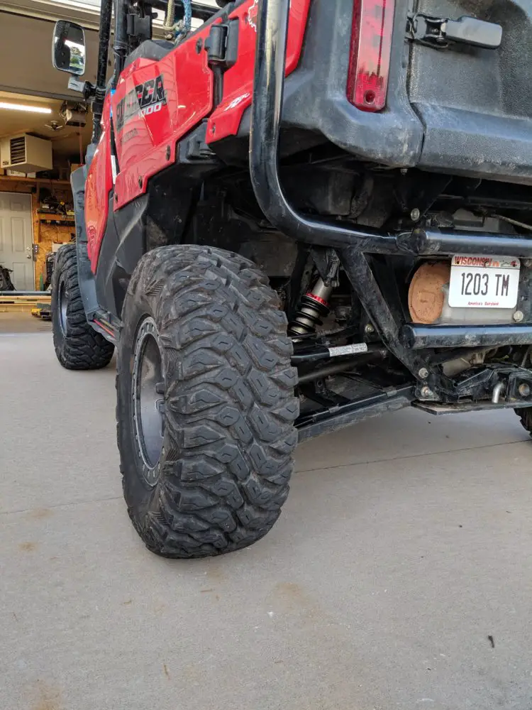

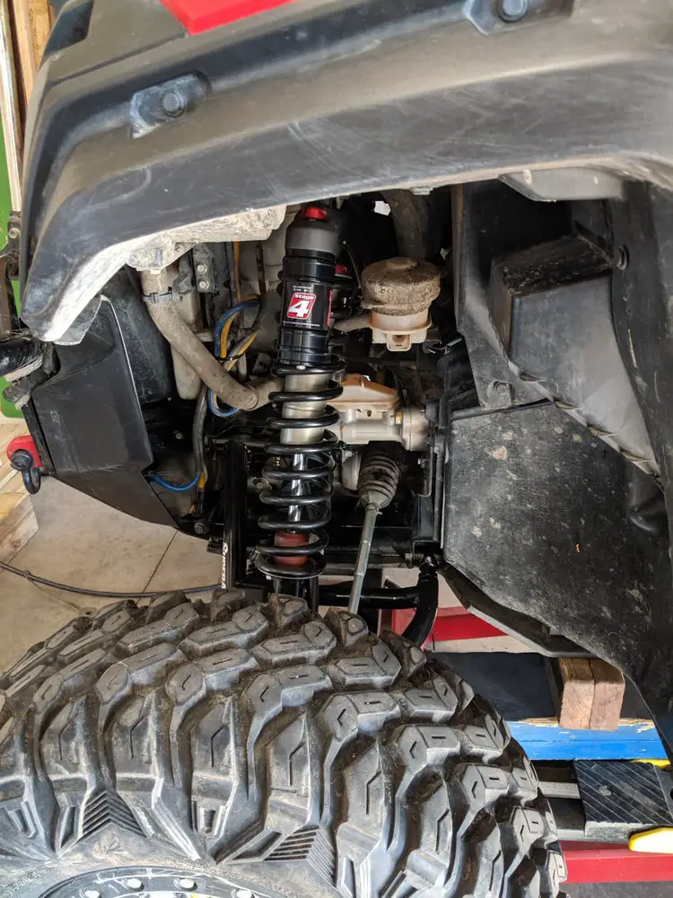

So how much are they to replace? Takeover will be here before you know it!
Probably around $600 each. Looks like a bit more rear preload would be a good idea. It's about 1-1/4" lower in the rear than the front with no load. Elka recommends 3/4-1" lower in the rear.

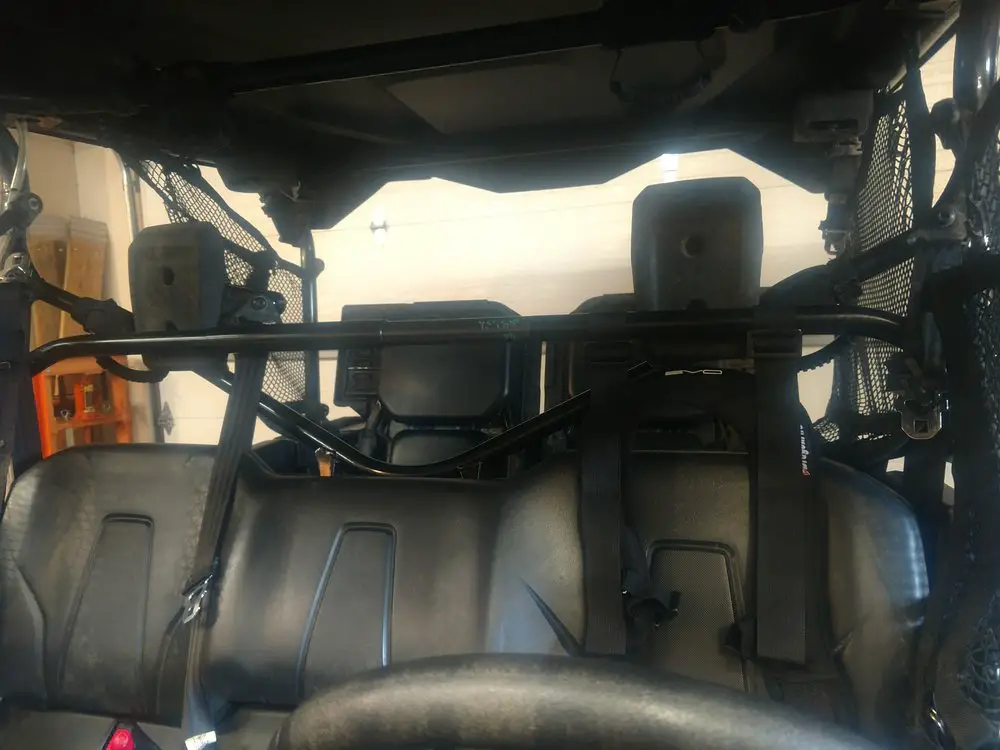

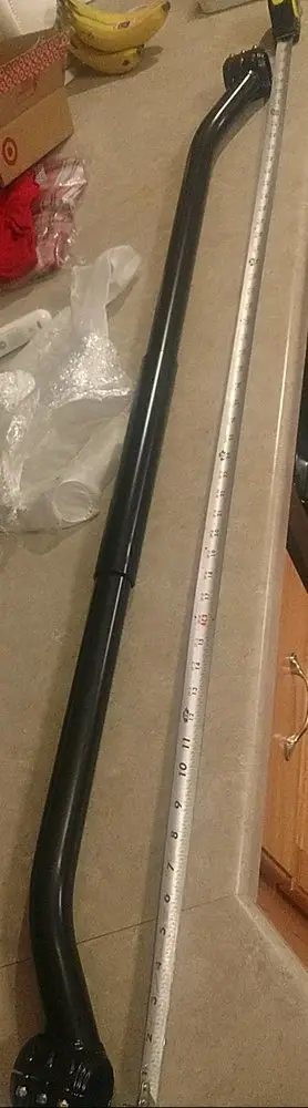

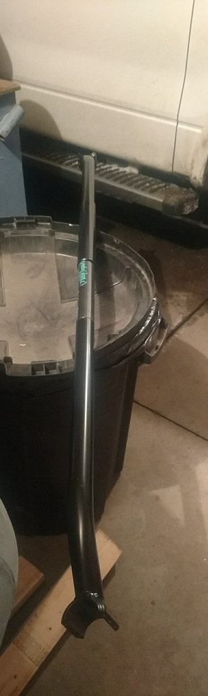

I've prodded our vendors to make some thing like this but nobody did it yet. I've been looking to upgrade to 4 point harnesses, specifically the Dragonfire EVO. I had to have a dedicated harness bar because being at the recommended harness height was important to me. I purchased a Dragonfire RZR-4 rear harness bar and extended it 9-1/4" to match the width of the Pioneer, the 1-3/4" B-pillar. Drivers side is installed and I like the fit. I'll order a passenger side harness this week.
Harness bar
Extended 9-1/4" and sleeved on both sides
Tube installed
Harness is a Dragonfire Evo
Fit
Did you do the quick connects at the bottom or how did you attach? I just ordered the BCF bar and Dragonfire 4-pts. Trying to figure out what I will need for hardware. Like the idea of the quick disconnect and would like to leave the OEM belts intact if possible

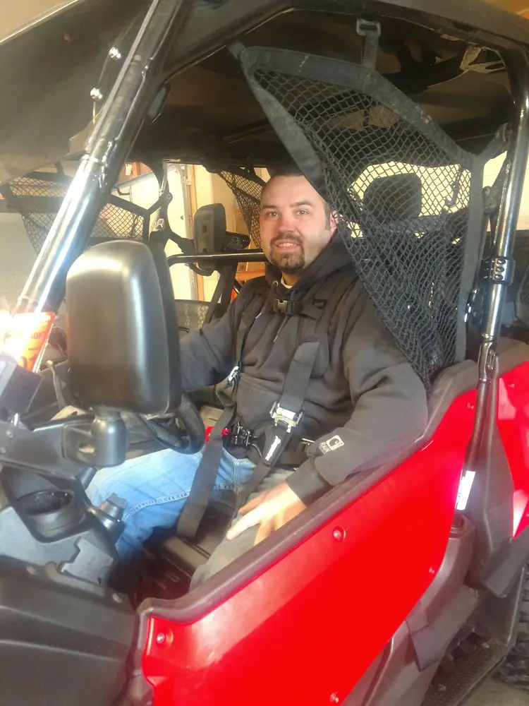

I replaced the stock belts with the lower Dragonfire belts.
