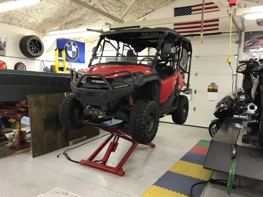

Greased my wheel bearings and added zerks to my rear knuckles. Also installed new rear pads and stainless brake lines
Up in the air for the week.

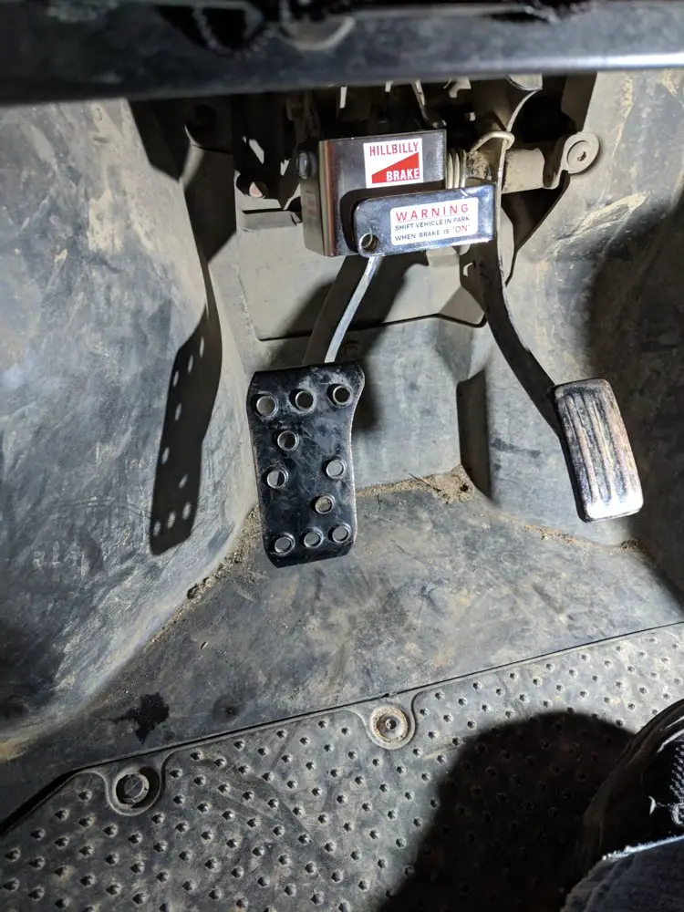

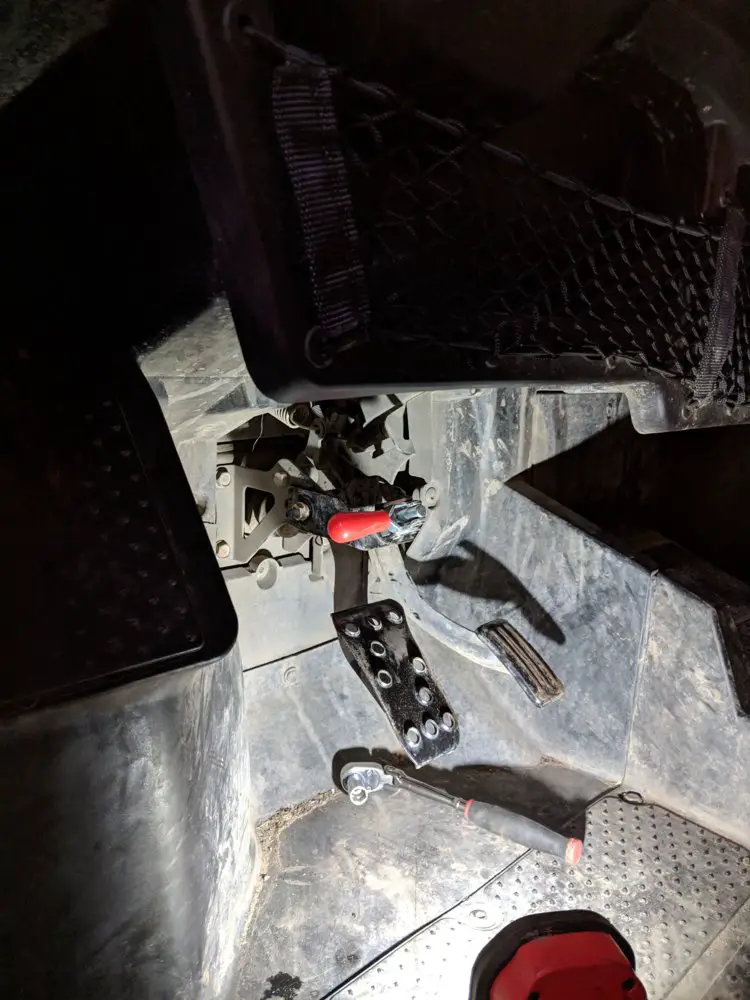

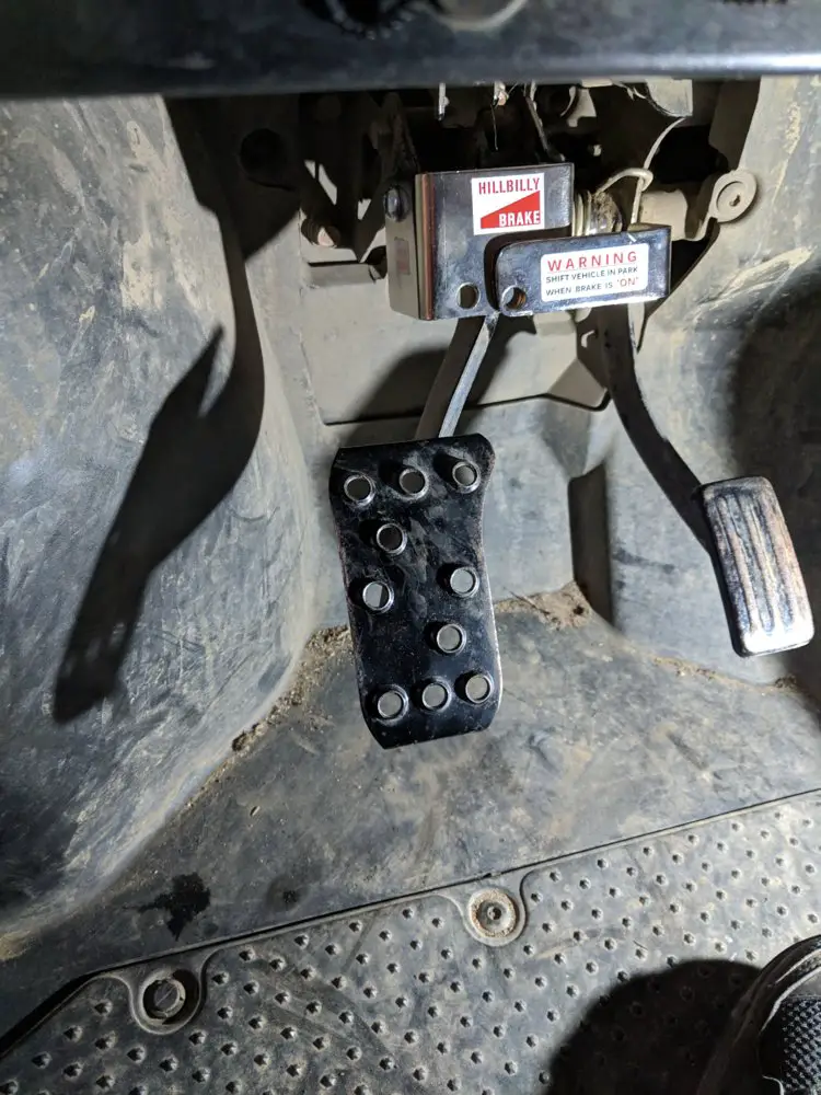

I also swapped out my parking brake for a hill Billy brake. Not sure I'd like the hill Billy because of the spring design and as it turns out it's a lot clumsier than I expected. The mechanism requires you to push the pedal as hard as you can and it doesn't have any positive engagement when it's on. I also can't see it from the seat so it requires a lot of effort to figure out. It does release really nice.
Out with the old

In with the new, unlocked

Locked. With just a bump of the pedal, it unlocks which should prevent forgetting that it's on. That's probably the feature I'm most satisfied with

I bought that also. It is kinda hard to engage but I'm satisfied with it. I've only been on 2 rides with it.

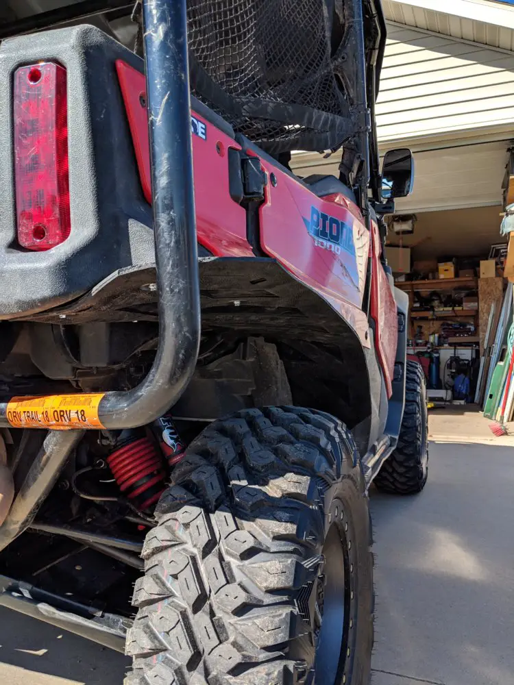

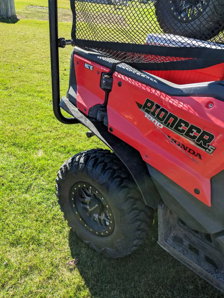

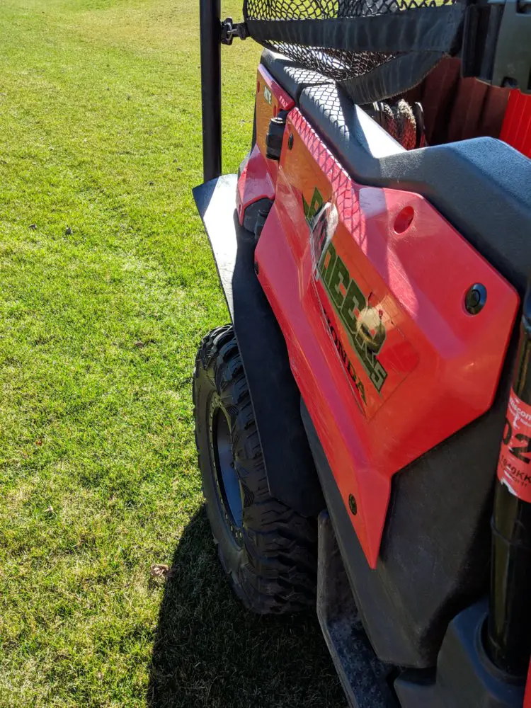

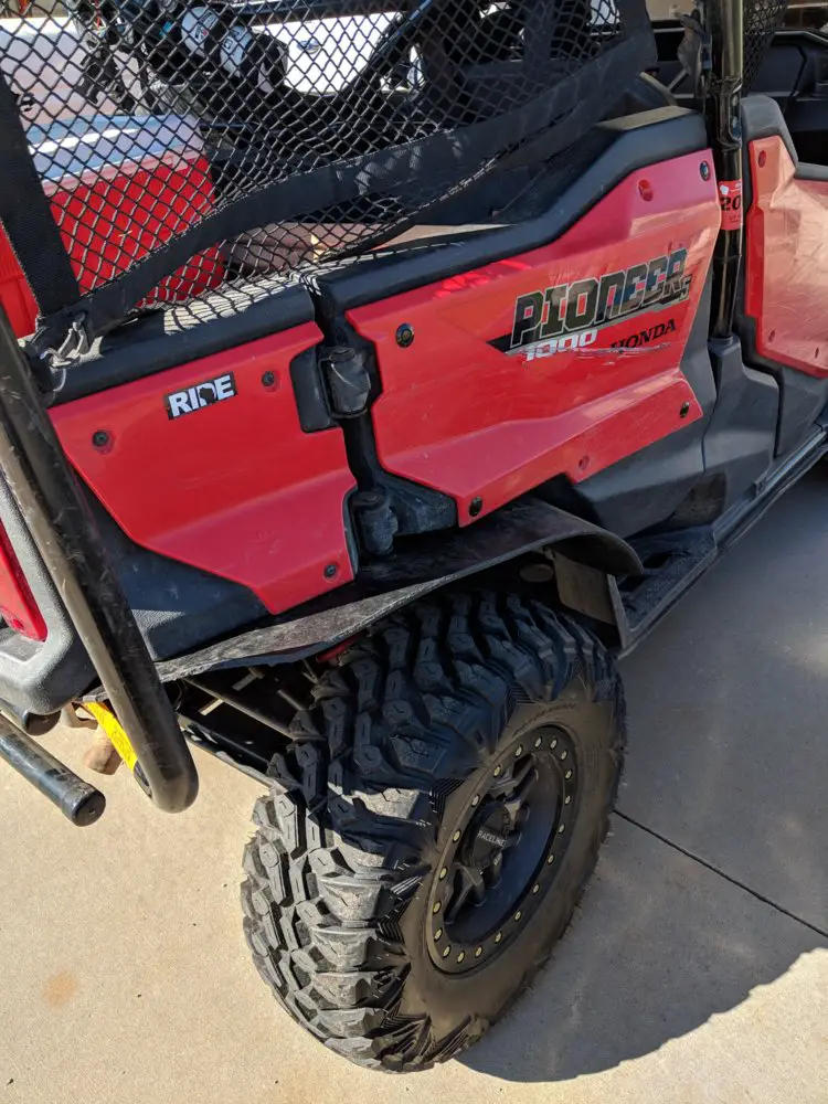

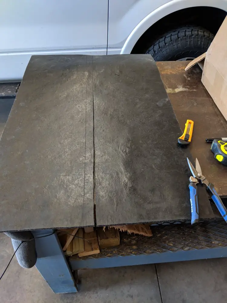

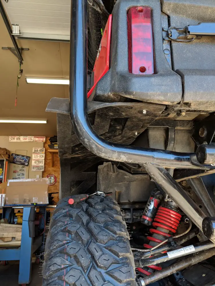

Added rear fender flares today. Wanted to keep some of the mud out of the rear doors and keep my boys a bit cleaner in thr back. Pretty simple 36x24 mud flap cut in half with the corners trimmed for looks and a bit of clearance to the rear cage. Bed dumps and they tuck inside the roll cage.
24x36 mud flap getting cut in half

Test fit
IMG 20190419 140923
Nutserts installed. 7 per side
IMG 20190419 142800
IMG 20190419 161826
IMG 20190419 161832
IMG 20190419 162539
IMG 20190419 162535
