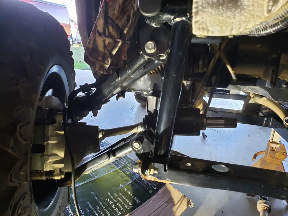

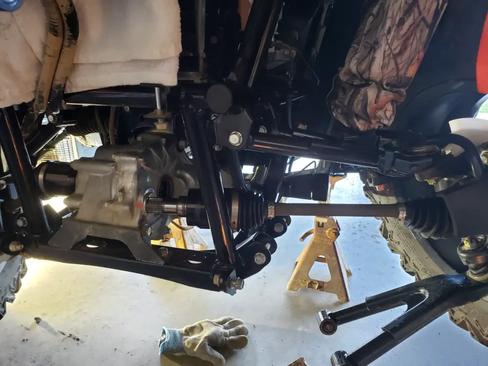

I installed the locker a couple of days ago. After watching vids and reading the instructions I tried something different. This procedure has probably already been done but I couldn't find any other post with a quick search. So here goes. Removed the driver side upper shock bolt. And drivers side lower A arm bolts from frame. Pulled outward on the drivers tire which allowed me to pop the drivers axle out. Removed the 4x4 cable and switch wire. Then I removed bolts securing diff. Pulled the diff forward to clear the rear bracket, then moved diff towards driver side. This allowed me to remove passenger axle without touching anything on the passenger side. This worked for me and saved alot of time. I didn't even remove the wheels. This may be an option for future locker installers that feel intimidated removing the entire suspension or just dont need to. The only disadvantage I see is not being able to disassembled and inspect/lube the suspension/brake components. Hope this helps

I installed the locker a couple of days ago. After watching vids and reading the instructions I tried something different. This procedure has probably already been done but I couldn't find any other post with a quick search. So here goes. Removed the driver side upper shock bolt. And drivers side lower A arm bolts from frame. Pulled outward on the drivers tire which allowed me to pop the drivers axle out. Removed the 4x4 cable and switch wire. Then I removed bolts securing diff. Pulled the diff forward to clear the rear bracket, then moved diff towards driver side. This allowed me to remove passenger axle without touching anything on the passenger side. This worked for me and saved alot of time. I didn't even remove the wheels. This may be an option for future locker installers that feel intimidated removing the entire suspension or just dont need to. The only disadvantage I see is not being able to disassembled and inspect/lube the suspension/brake components. Hope this helpsView attachment 99432 View attachment 99434

Thanks Mudder, the 4x4 cable was easy to get to from the bottom. The reason I went the way I did is because the diff is offset to the passenger side giving lots of room to move it towards the drivers side to disengage the passenger side axle. I dont think it has enough room to go the opposite way. But I didn't try it. It might work. check out the bottom pic of how it is offset to the passenger side.
