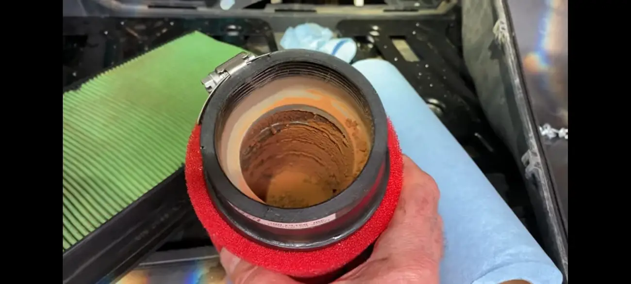

Here is one after 500 miles.
Cotton clogging up the UNI, wall full of dust and debris.
Also, proof that the UNI is, in fact, the new PRIMARY filter.

Example 1 the cotton ball clog posted above.

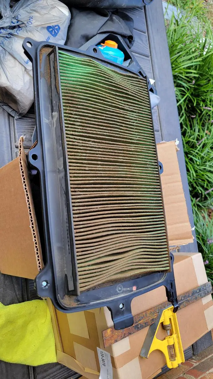

Finally, an image showing what looks like a dirty filter.

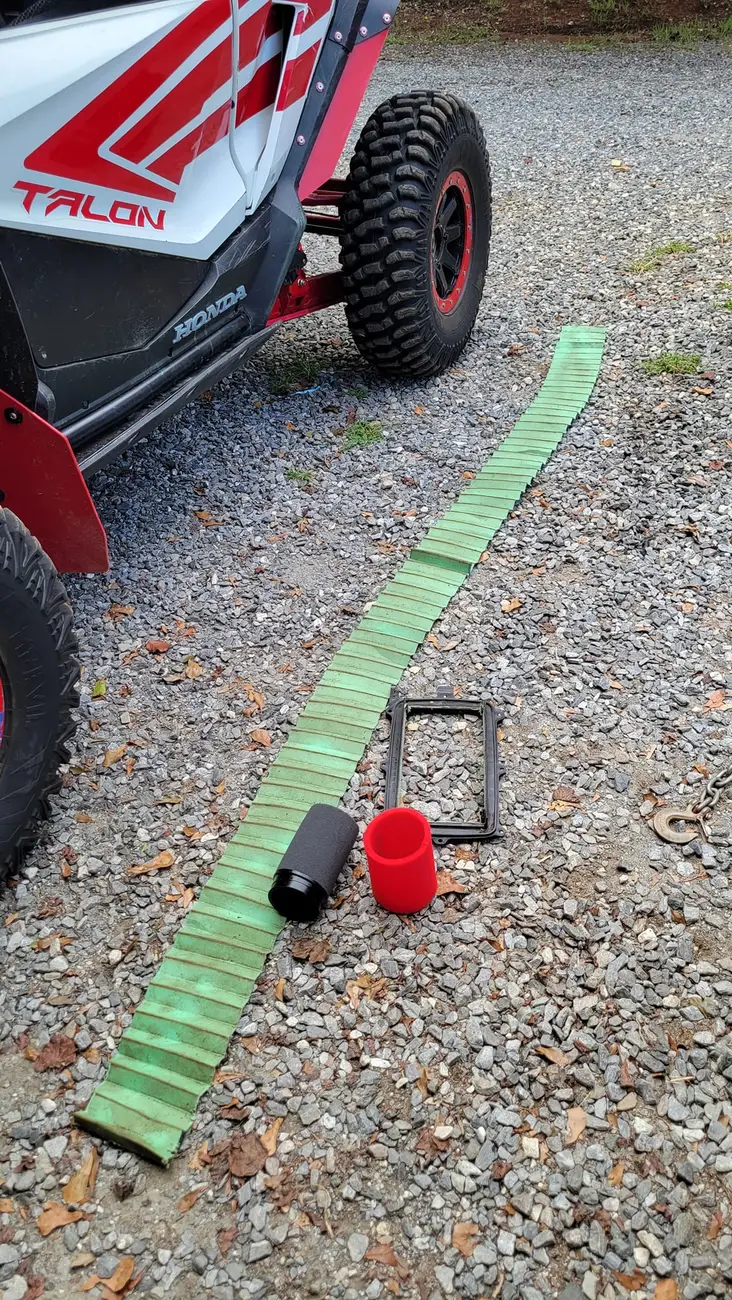

Then the same filter cut open to show how much life is still left and the surface area of the OEM compared to the UNI.
The UNI is the black one, Not the red outer cover filter.
