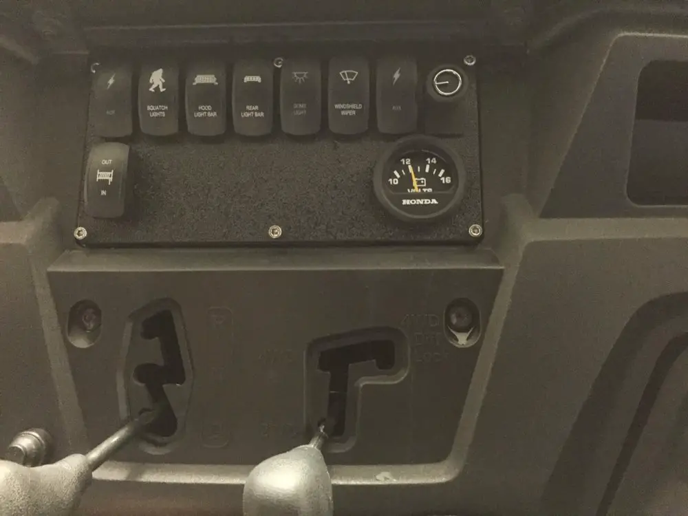

Next came my duct and control location. This is a short run remember for less heat loss and less air flow loss. For those of you in Reo Lynda that’s “more heat”. The control that came with the unit is a simple off, low ,medium,high swith witch comes with the unit. I conveniently installed it in the middle, easy to reach and pretty much out of the way and more importantly not taking any more room on my dash up. Those of you with accessories switches know what I’m talking about ;). The vents are a simple 3” vents that swivel like most pickup trucks have. The kit that I bought from summit as well. You can use the kit but I found that that was a waist of good cabbage and I’ll show you that later. Just buy the vents ok!View attachment 97761
