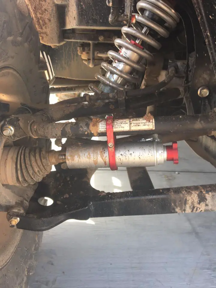

HondaSXS I have never seen shocks with the remote reservoir mounted with reservoir mounted to the A-arm. Can't they be reversed with the reservoir mounted up on the frame.
I agree, but with the brackets supplies that was the only round bar in that area I could see to mount. I have them off currently. I will be looking at it again when I remount.
I thought the same thing but after playing around with it, I noticed how the reservoir when mounted to something static would allow the hose to be constantly moving. Maybe it's ok just like a brake line but the hose is stiff. When mounted to the arm nothing moves independently but all together.
Heck, I don't what way is best.
That is a clean install Joey. Personally I'd be perfectly fine with it. Loved how a compression adjustment was felt immediately. Didn't have to bounce it a few times to feel a difference.
Makes sense to me.
