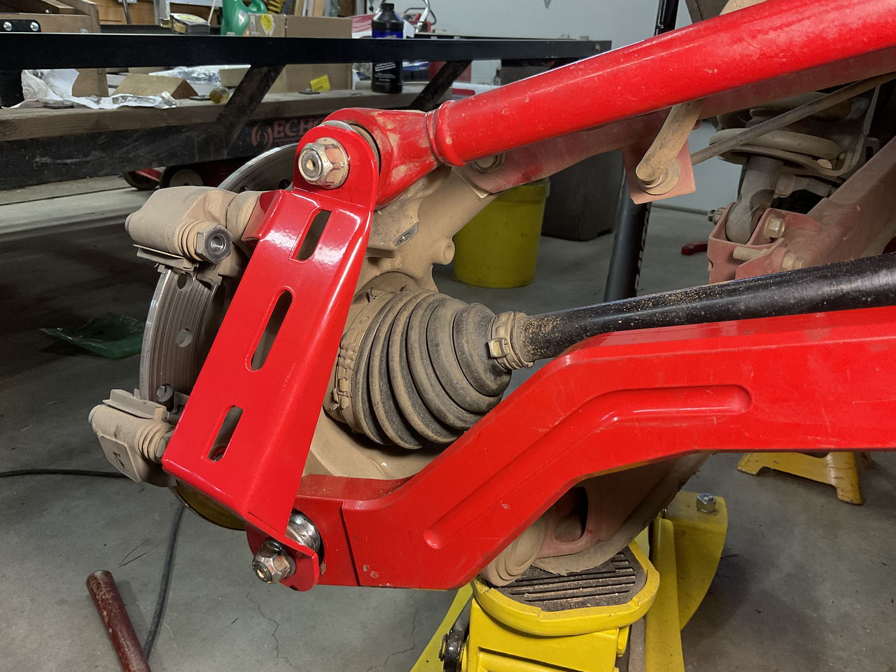

While I had the rear end apart to replace the heims in the L&W radius rods and the LR inner CV joint, I installed the double shear brackets I had bought earlier.
1666371155186
There has been enough breakage at the hub end of the radius rods that All Things UTV came out with the double shear brackets (they call them shear stoppers). Stock, the radius rods connect to studs sticking out. The bosses are fairly stout but still breakable.
1666370556955
Some of these aren't compatible with the L&W radius rods, the All Things UTV are. Not sure why I couldn't find these on the ATUTV site, all 'search' could find was the directions, so no link. 😧
1666370665356

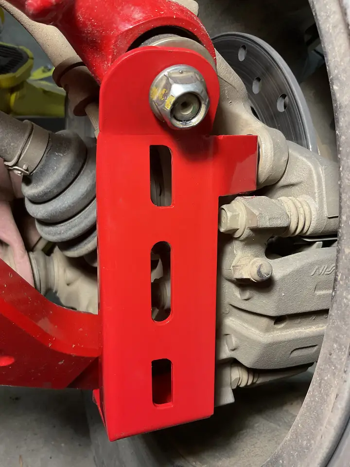

The double shear brackets support the outer ends of the studs and tie in to the hub. We couldn't get the heims to press out of the L&W upper rods so I'm using the stock uppers for now.
1666370238334
1666370285884
This blocked bolt is the top one, the bottom one is equally unreachable. That will require removing the two bolts holding the caliper to the hub so I can get these two out to replace the brake pads. ETA: trial fit, finger tight, see the photo above for fully tightened.
1666370403949
This is the unreachable one on the bottom (on the right). The missing bolt holds the caliper and will have to be removed for pad changes, no big deal.
1666370497839
Well, doing the RR brake pads, I just learned the double shear brackets have to be removed completely to change pads, the caliper won't clear the rotor with them installed. 😥

Are you comfortable with the lack of full thread engagement on those? Standard engineering practice deems two exposed threads, this setup has none.
Reactions: Merlin and Dankathy
CID
CID
Oct 27, 2019
5,759
26,449
SE Denver-ish
If you're referring to this photo, that's the trial fit up and finger tight.
1666374487863
This photo shows the studs are long enough to fit flush to the nut, utilizing all the threads. I'll add a note to that photo. 👍

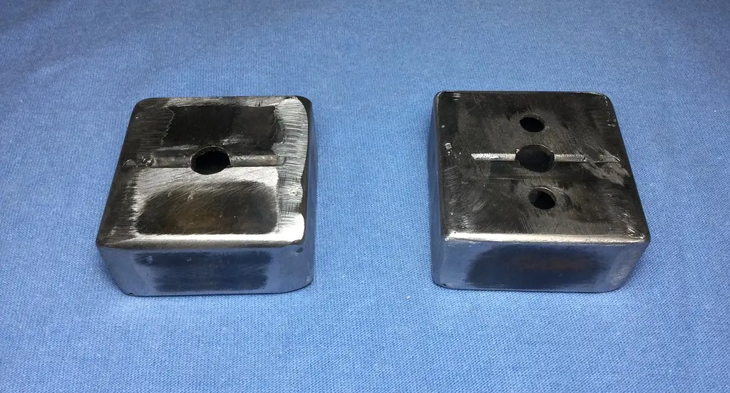

He had installed seat risers but went with 1-1/2" in front and 1" in the rear, tilting the seat back 'some'. I liked it so much I went home and ordered a set of 1-1/2" Jeep seat risers from ebay and made a pair of 1" for the rear. Highpocket74 makes them now (1-1/2"). You'd still have to come up with 1" for the back. Someone else said the Jeep guys use hockey pucks, apparently they're 1". Note that the Talon seats have too much lumbar support IMO. With the seat laid back, my shoulders frequently don't touch the seat but it's better than before the tilt.
These took me too long to make from scrap I had handy and why there are a couple of extra holes, nuther project.

No, I was referring to the tightened one, just even is not generally considered good enough as most bolt threads are tapered near the end, thus the need to have at least two extra threads beyond the nut.
CID
CID
Oct 27, 2019
5,759
26,449
SE Denver-ish
I had an engineer tell me a long time ago that 3 threads are all that's needed for full strength. Since I knew how smart he is, I've carried that information for decades. So I'm happy with flush. Two threads beyond the nut may be 'perfect' but this isn't the Space Shuttle.

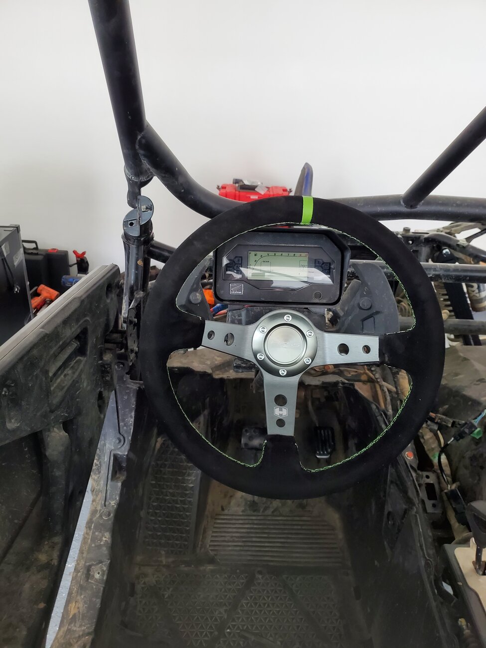

This is the last pic I took. One of the many upgrades I did to my wrecked Talon.
Instrument panel relocation
Hess steering wheel and quick disconnect
Hess I4wheel drive override. Its sitting off to the side you cant see it.
Dynojet programmer to Hess tunes.

Long time no see! Glad to see that you still have the Talon and are still working on it. Is it drivable now or is it still in the rebuild process?
amelung45x
amelung45x
Nov 20, 2020
85
261
53
Chillicothe, Ohio
What's going on. Its been a little bit lol. I've been a little busy the past couple of months. Between moving to a different state, starting a new job, buying a house, I now have time to put time and money back into it. It drivable. I took it out one last time in Missouri before I moved to Ohio. It ran very very well. Plus I missed driving it. Im still rebuilding it. I added a lot more aftermarket parts and body plastics. Just waiting on the few plastics to finish putting it all together. The rebuild is coming a long very well also. Im getting to know this machine inside and out unfortunately lol. Ill post pics and everything that I added to it once its finished. I was putting my front grill together today and found I had one of my headlight bezels was miss boxed. I need to send that back and get the right one. Getting that put together is on hold just like getting my front end and passenger rear fender because of waiting on body plastics and parts lol. Gotta love rebuilding lol. Its was nice to hear from you.
