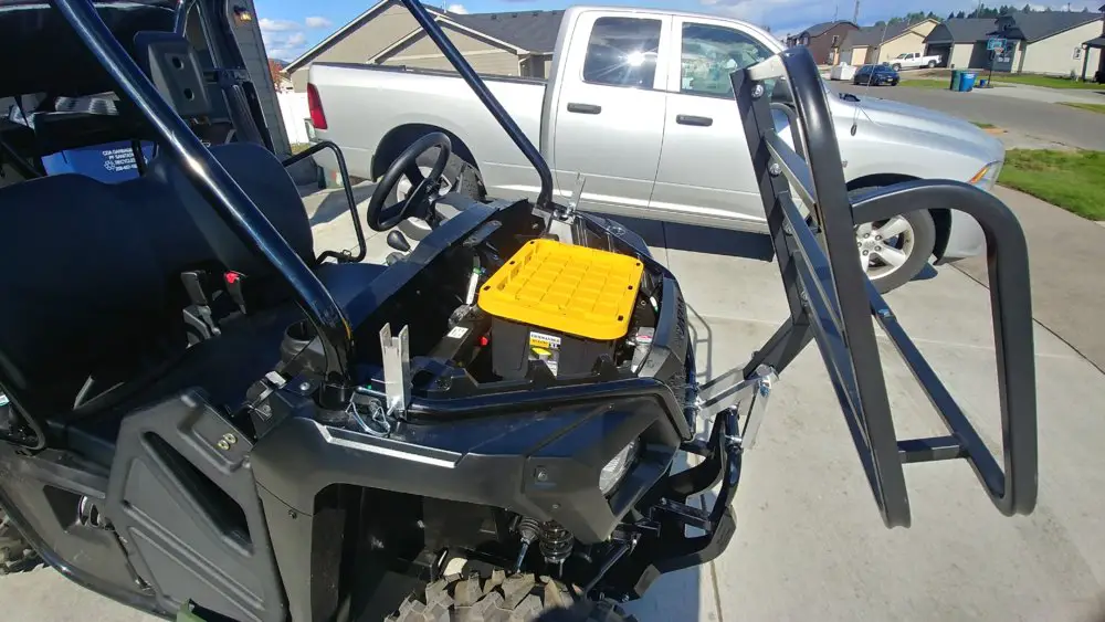

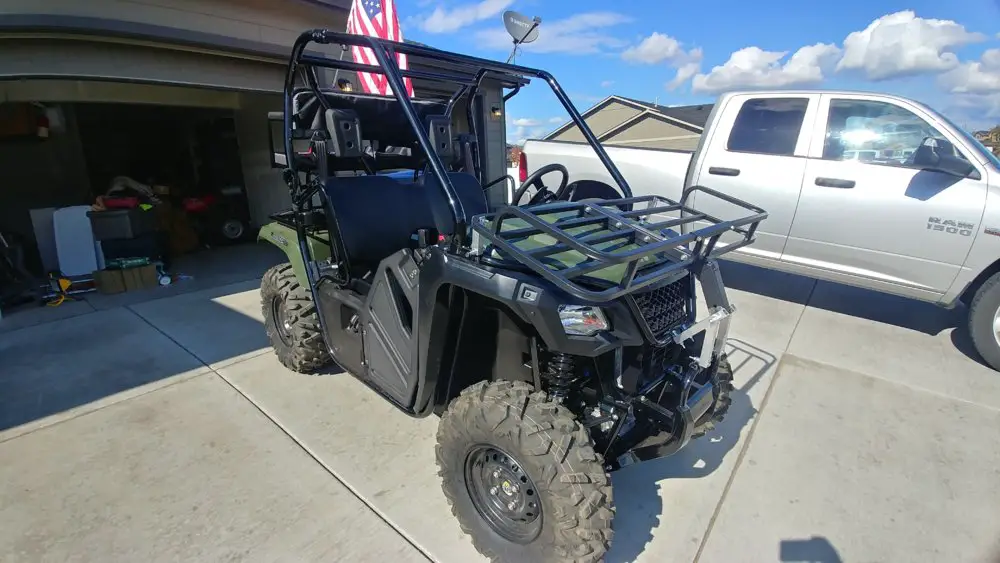

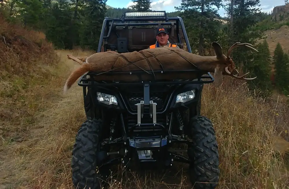

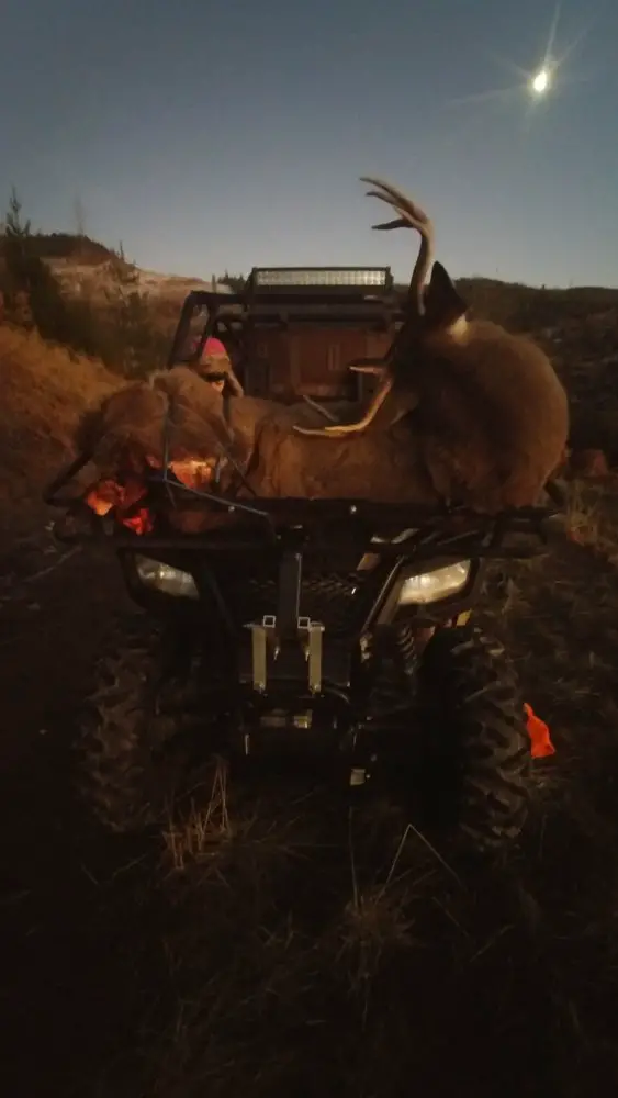

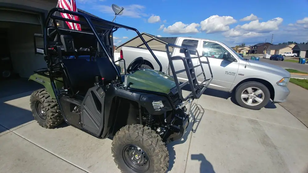

I wouldn't trail ride with large loads on the rack because they will start to obstruct your view. You can see how much the view changes between my son's young buck and my old buck. For me it is a place to put an animal after I harvest. It allows me to fill up all the rest of my storage in the rear and still have room for a deer or elk quarters. I stood on the front rack and pulled my son's buck up. I would guess that came out to about 325lbs., and it handled it without a problem. As a hound hunter, I think it would work great for a cat.
I mounted it on an angle on purpose. I didn't want the front bar of the rack to obstruct my view during typical driving. It doesn't at all! I don't even notice it, and the front bar holds a deer great. I threw a few bungee cords on it and hit the trail.

That's a really slick rack. It would be a handy spot to keep snowshoes too.

The rack is from Harbor Freight. I bought mine for $30 as an open box return in the clearance section. I think they go on sale for around $50. I used aluminium for the support bars. My plan was to throw it together for the hunting season, then weld up something nice when I had more time. I don't think I will bother, because it seems to work really well. When in the down position, it is fastened to the upright posts with simple spring pins. I mounted it with rubber covered conduit clamps I bought on Amazon. I think I paid around $12 for a dozen. They are the same clamps I used to attach my roof and back screen.
I'd like to know more about your axillary gas tank. Can you post pictures of where you mounted it and how you plumbed it in?
