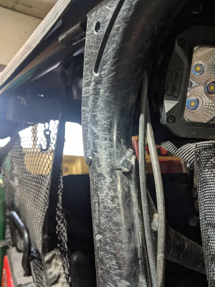

I cut my b-pillars at a z. The outside was about an inch longer on the top at the outside and then a out 1/2" taller on the bottom on the inside. This way I could over lap the 2 pieces and keep the gussets on both sides. I also sleeved mine with tube
Hopefully the pictures help
View attachment 244612View attachment 244613
Yes that helps a bunch, thanks. I'll post pics when I'm done with it!

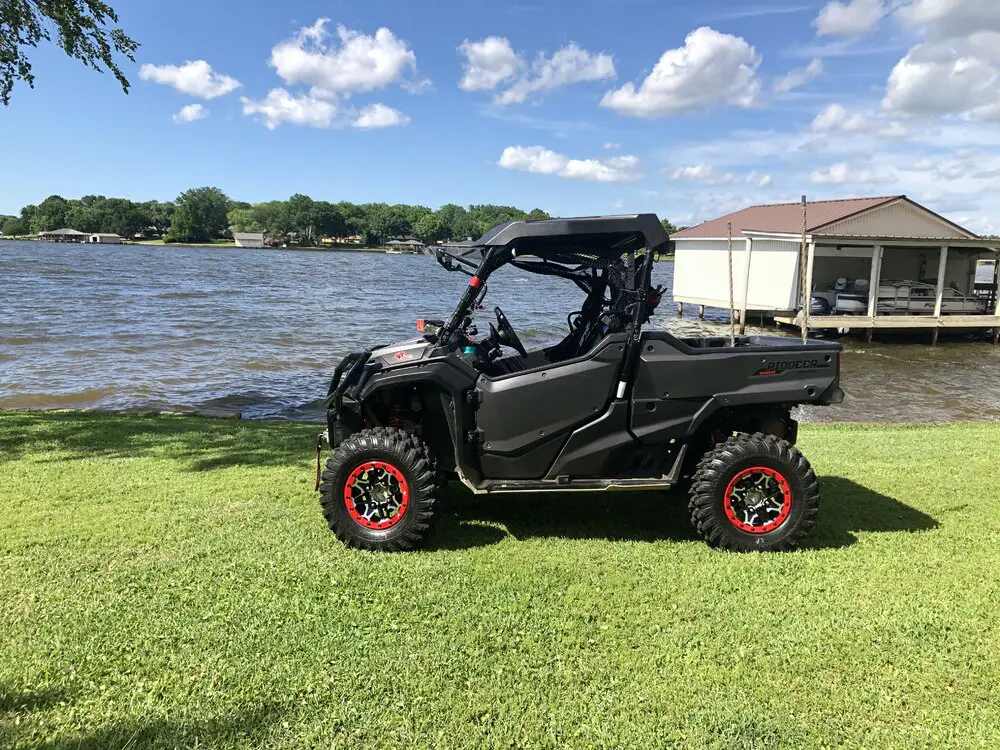

No, I cut mine 4” in the front and 5” in the back without changing the length
Is it a P1K5? You got any pics of this chop? Maybe a side view?? I was thinking doing 4 all around but may like the 5 at the rear
