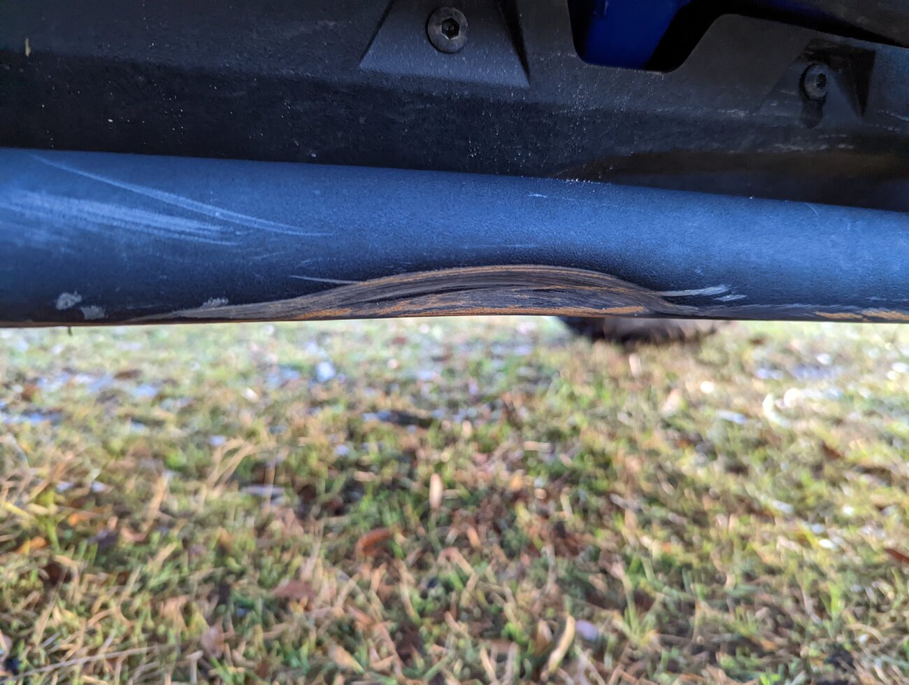

@CumminsPusher you'll probably be okay with those sliders... This was after 3 days in Tackett on pretty much everything but No Business and Hell's canyon.
PXL 20220228 235709374
Really the only damage and that was a serious whack. Me and @Frogtown went on a couple adventures the rest of the crew decided against :D
Tree kicker or frame?
That’s a decent ding right off the bat, ya they’ll get torn up fast, hopefully not as fast as side bars on Pioneer.
I was thinking about filling them with expanding foam. Done that on a few things and it definitely helps but just gunna run em

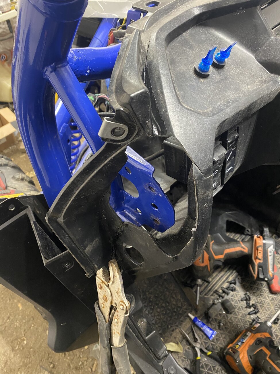

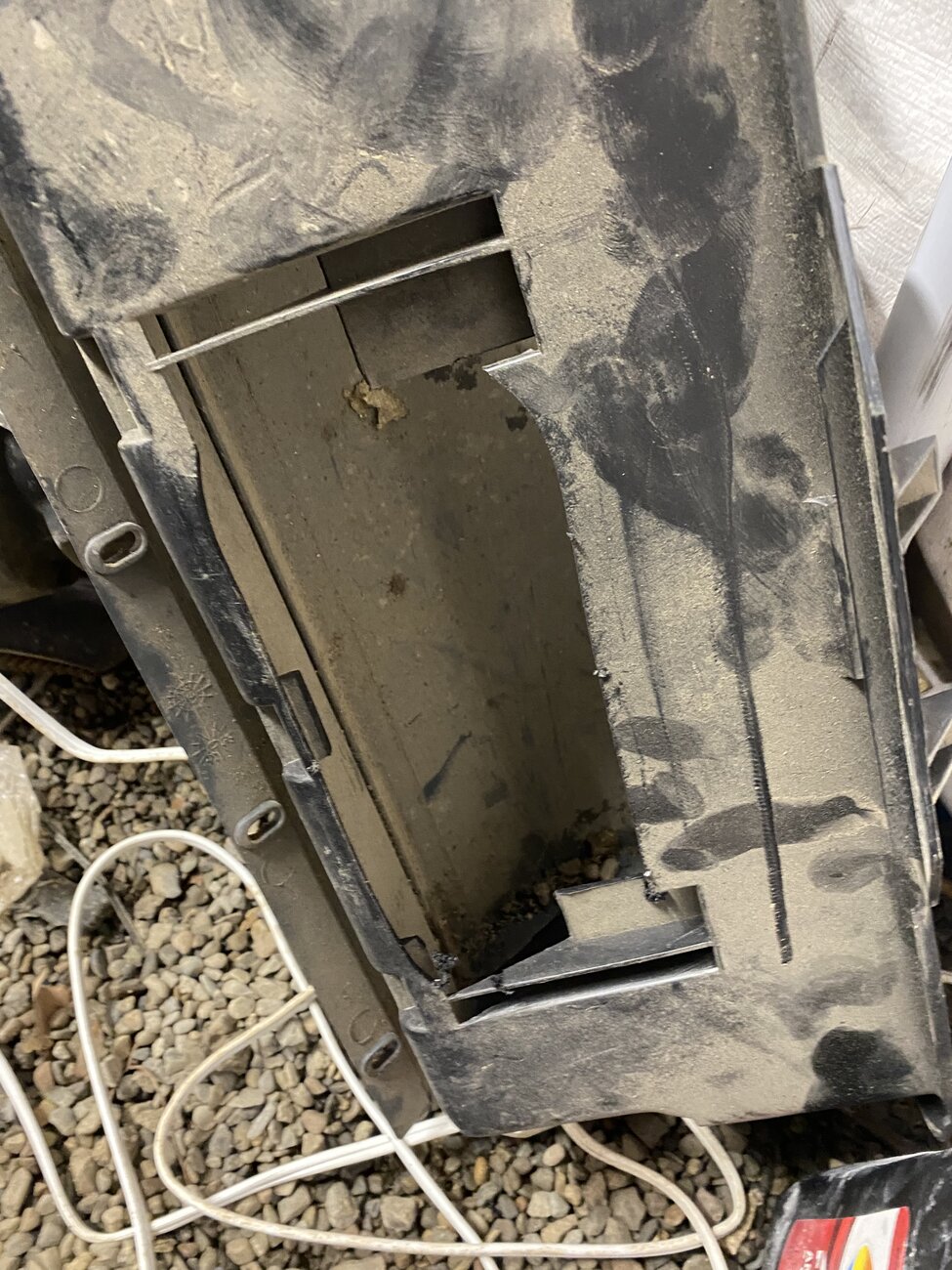

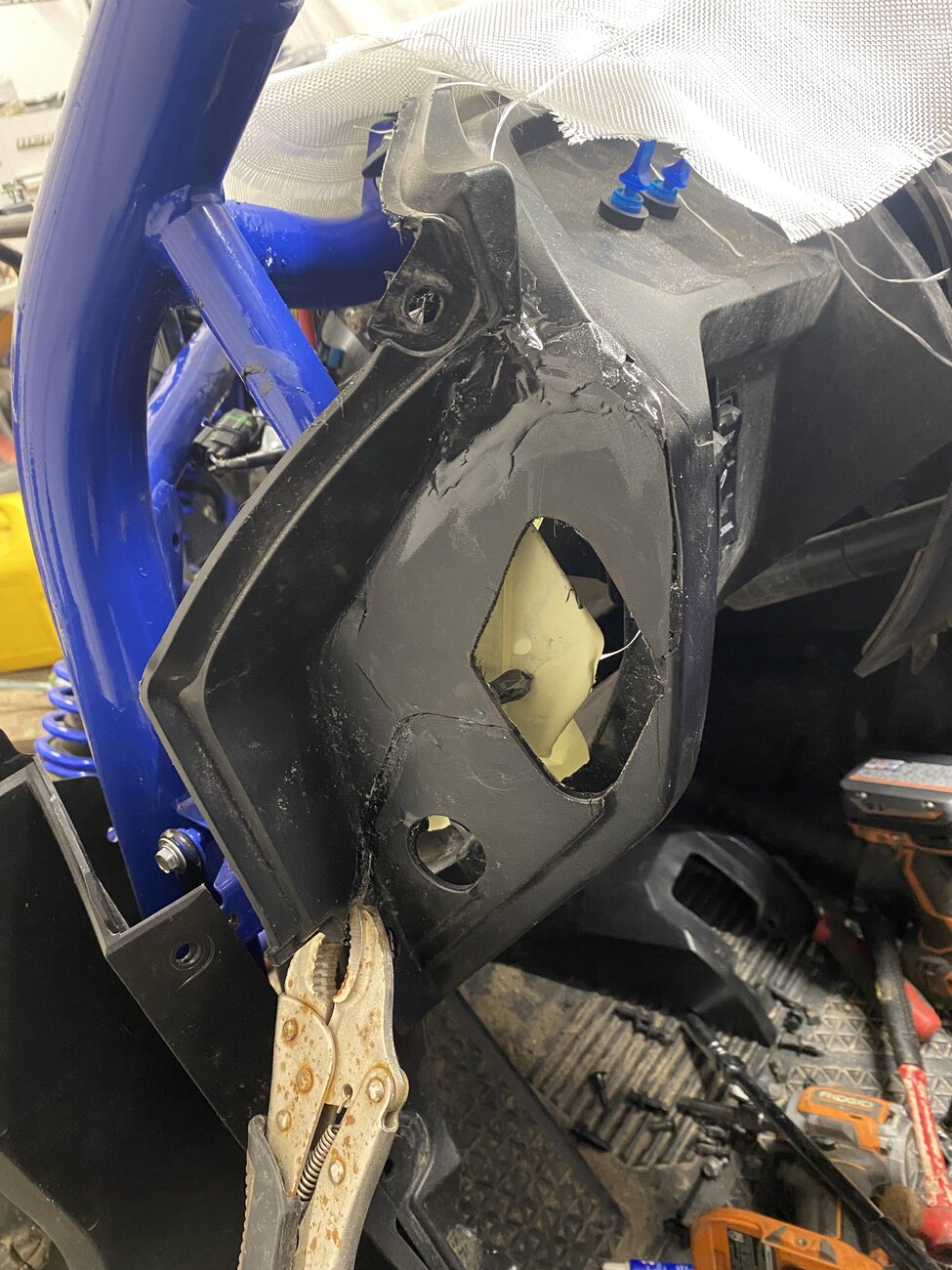

Couldn’t get a dash but just couldn’t leave it looking like s*** till I did get one. Repairing multiple spots but latch area was really broken up and missing a big section.
Looked around and closest plastic type and thickness was inside of one of my old Dodge inner glove box so that’s what I used.
Cut it to fit, heated up to get a couple bends and traced latch hole on passenger side to get it right. Used fiberglass mat and a two part panel bond on backside. Letting it fully cure tonight and I’ll bevel the face cracks then bodywork and paint in the morning.
Sucks to fix but gotta do what gotta do.
Nice work!
Finished the cracks and big hole in the dash. Not my best work but it’s usable, not near as obvious.

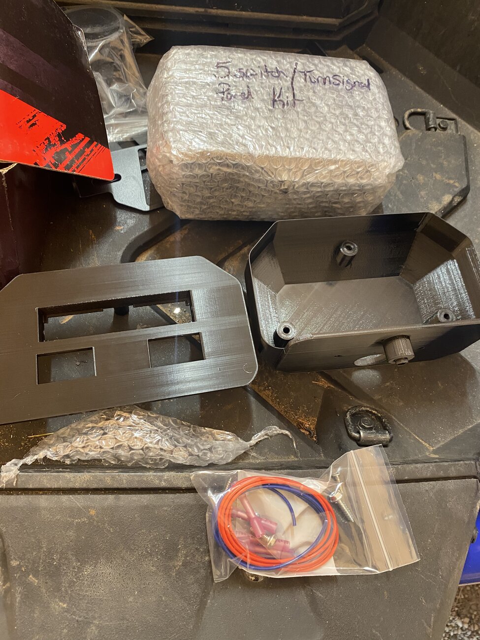

Got the cluster relocation kit in. Not sure why I had to extend wire for mode switch but did. Moved the switches tried everything could with routing but in the end extended it. Probably got a switch or harness that’s just a bit short.
Since I lengthened it I went ahead and lengthened the launch mode because it was tighter then I’d want. Then obviously the required power outlet.
3E70F9A0 6B5E 4147 A40C FFF03984A9D6
21C564F0 1D67 43CE BB5C C9C2306D75C6
E76C4011 C64F 4BFD B167 EC74EAAA3B3C
Sanded the printer lines off and painted blue to give it a little bling. Also painted the Talon dash cover while I was at it.
