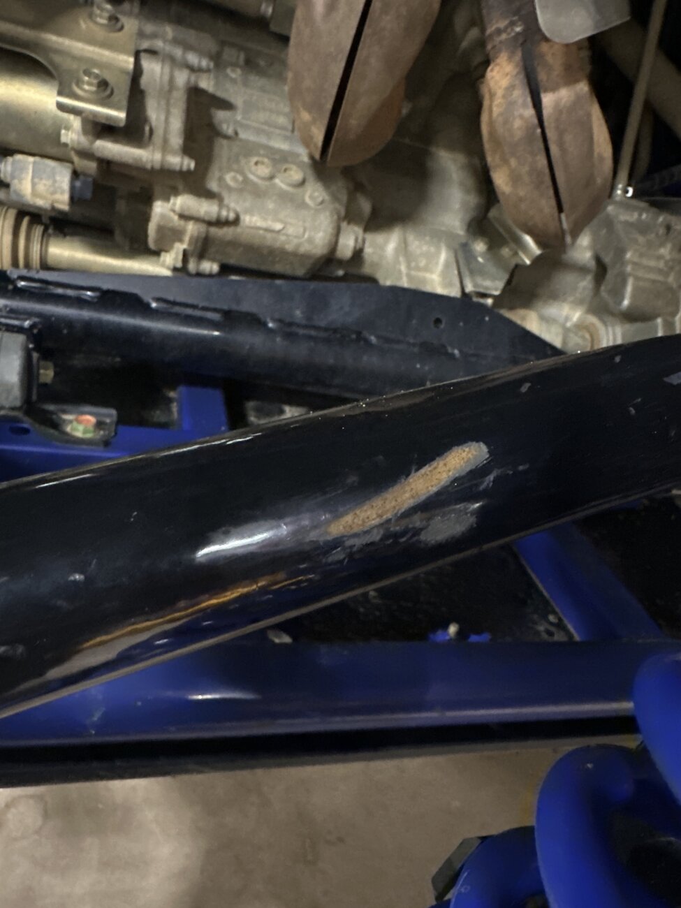

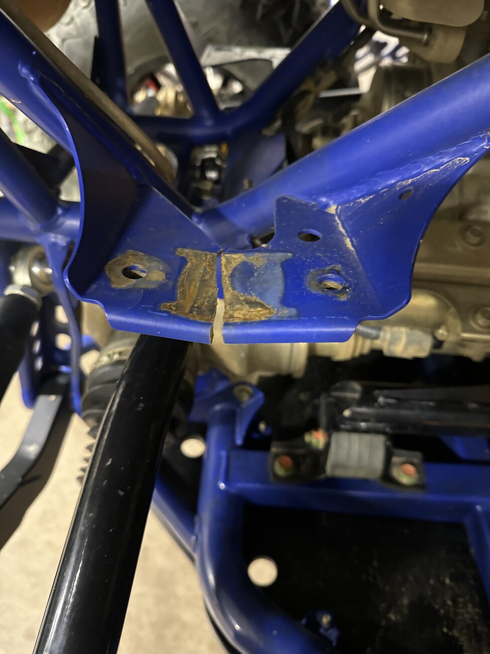

I’d be curious to know if the overall width (link mount to link mount) is wider than the stock one. We have bent the 4th link on 2 different R’s of ours and installed the SATV 4th link and it is not engineered right. The sway bar hits the 4th link while flexing and it has already broke our sway bar mount on one of them due to it flexing the sway bar when it hits it.

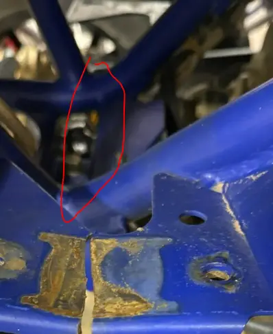

I will send the pics asap. I had been to busy to contact you about at this. I actually have 2 sets installed on our 2 of our Talon Rs that both rub. One has split the brace and one has not yet. I have adjusted them every way possible with nothing stopping it from rubbing. I have a 3rd set sitting in the box to install on our 3rd R. I did not install the 3rd set yet due to this issue. Thanks

Yeah the upper rear 4th link. I don't run a rear swaybar so I never ran into this with my SATV set on my R.

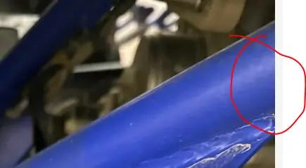

I run this even without the swaybar since the flex in the rear can fatigue those uprights and cause them to break clean in half just in front of the gusseting right here:
1713966321456
Adds more lateral support higher up between the two sides since there isn't any from the factory other than the rear diff mount brace (I guess technically the swaybar would be the upper bracing...) :
Geez...I guess we're going to have to make one of those frame braces too. Looks like that's always going to be a problem...even without the sway bar.
@Hometeam I couldn't make it hit on the lift with the shock off. We had pretty big billet hex sway bar links on there too. Way bigger than stock. They are bolted to the outside of the sway bar, correct? PM me so I don't wreck CP's thread. Lol!
