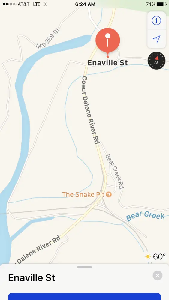

look up kingston or enaville idaho. thats were i grew up.And definitely stop in at the snake pit and get there chicken fried steak.
Yep that's 6.2 miles from our intended path. If it sounds good to the group we may run up there.
