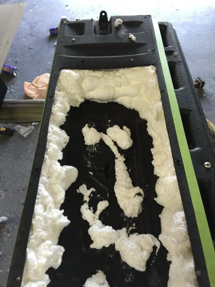

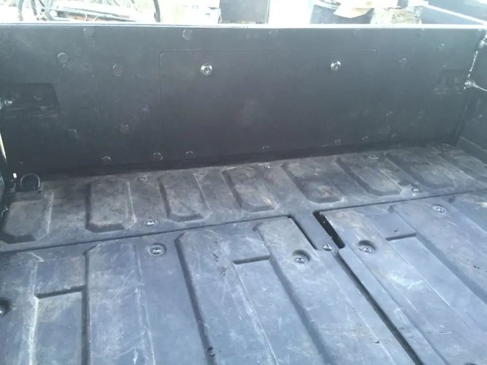

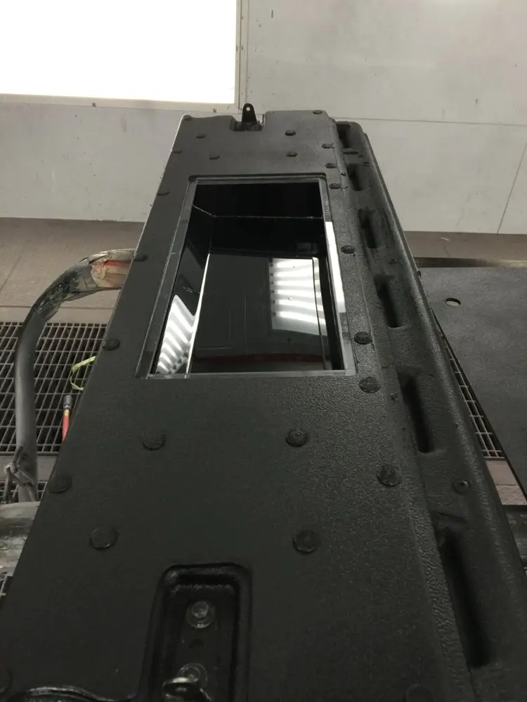

View attachment 21001 View attachment 20999 View attachment 21000 Been a while since I've updated and a bit has been changed.
Added a stronger tailgate with storage. Storage is an all time low with these so this is stage one. It killed two birds with one stone. Very strong now! Two can sit comfortably with no bending you can do whatever those cables will handle.

There is less depth on the inside of the 3 but it is wider too. Aluminum should work just fine but I’d go thick so it doesn’t collapse. The gate looses strength obviously with a hole so you’ve got to over engineer it a bit to get that back.

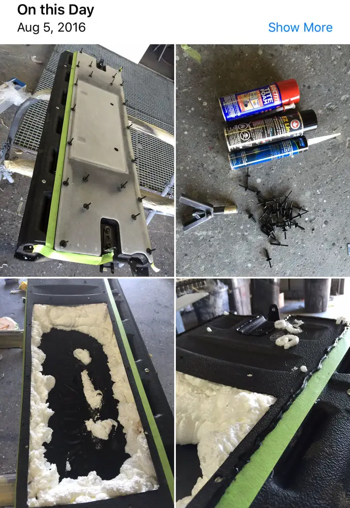

We used polycarbonate because it’s shatter resistant and strong as hell. Used capillary glue in joints and windshield cement with plastic pop rivets to adhere. Dense expansion foam for strength. Then sprayed bed liner over.
With this mod done on ours you could put as much weight as you wanted on it without any flex at least in till the maybe the cables broke. It’s really stout. Dry lockable storage has been wonderful. We currently have a compressor, first aid kit and a pressure sprayer all in there
Edit
Apparently it was 2 years ago yesterday we built this as it just popped up in memories lol. Still holding up great.
