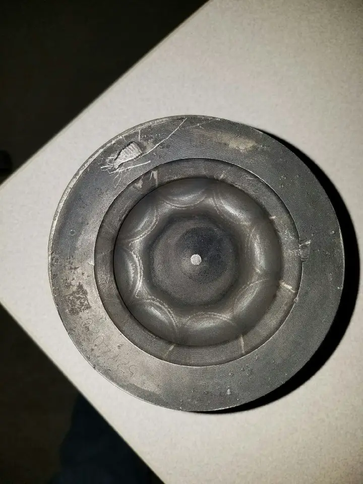

Each system has it's pros and cons but I wouldn't go as far to say the grid heater is far more problem free than glow plugs, definitely not more efficient. The Cummins grid heater pulls 200A. That is brutal on an electrical system and batteries in the dead of winter when it's needed the most. The grid heater in my 2013 Ram failed and destroyed the engine. It melted the stud off the inside of the heater and the remaining part of the stud found it's resting place on the top of a piston.

I’d take a grid heater over glow plugs any day. It’s a no brainer
So would I until it cost me 10k. At least I have a cool paperweight now. Maybe I'll change my thinking again if my Powerstroke ever eats a glow plug tip and cost me an engine.
Edit: CP out of curiosity and honest question. Why do you not like glow plugs? A58a96d595f1acd4228fd6b640c6eaf8
Reactions: Biteme
Edit: CP out of curiosity and honest question. Why do you not like glow plugs?View attachment 236268
FAR less instances of a grid heater issue. I’ve never known anyone to have an issue much less have to change one out. Glow plus are recommended every 100k, I’ve got 400k,375k,,265k,260k,250k respectively all around 30yrs old with original equipment. Those are what I currently own but have owned many others, family and friends have owned a ton more again without even changing one out. Nearly everyone I know in a slightly older Ford has had to dick with the damn things.
Just changing a glow plug out can be a serious problem, usually seized in, sometimes just taking one out can break apart and fall into the engine. Powerstroke and Duramax both have very common catastrophic issues with them.
I like s*** that lasts. That’s why I buy what I buy. For me the glowplug vs. grid heater is like the inline-6 vs. v8 conversation, yes either can have a problem but one has drastically more at more repair cost.
