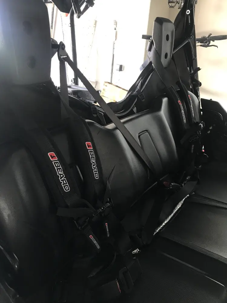

Well I got around to putting in the 4 point harnesses today. They feel amazing. Glad I saw @Tramguage1 using this brand and @GlockMeister install. View attachment 49955
Do you have anymore pics of theses installed ? Thinking about doing this

Like where you bolted the shoulder straps and the lap straps I have never had 4 or 5 points before when I was younger did not care but I just bough new helmets and Google's for me a better half , just want to be safe if we roll hopefully never happens but theses stock seat belts seem a joke to me ,.so any pics that will be helpful for me to install them would be great ..thanks

Has anyone installed theses on a 2017 model where the drivers seat belt has to be clipped in to go over 15mph or so

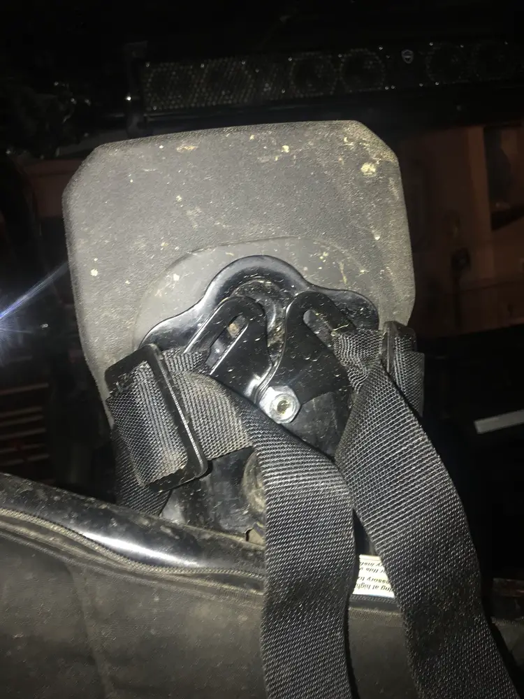

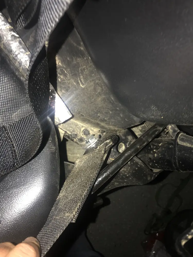

Ok so you will need 5 7/16x20 1.5” bolts, approximately 10 7/16 washers, and 1 7/16x20 2.5-3” bolt. You will need 2 7/16x20 nuts. Remove the factory bolts for the lap portion of the bolts. Insert the 7/16 1.5” volts with a washer through the new lap belt portions. As seen below. (Simplest part)
Eddb588130998886c60f42f41a98053d
Now remove the headrest on the drivers side. Insert the last 7/16 1.5” bolt with washers on bolt and a washer behind the shoulder harnesses. See pic below. E0e388743e67398d8968331a7f9052aa
On passenger side you will need to drill a hole through both sides of the hollow headrest. Once drilled, slip bolt through washer then through the headrest. Put both other shoulder harnesses on and last nut. It really is about an hour project to complete.

I will say I did not remove the factory seat belt auto retractor behind and under the seat. I messed with it for a second and said screw this. I folded the factory seat belt up, and zip tied it below the seat.
