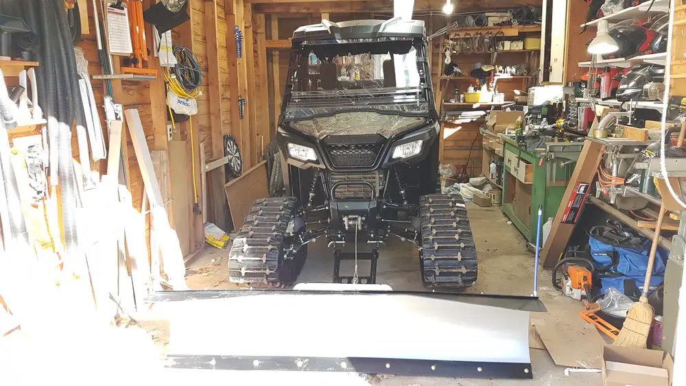

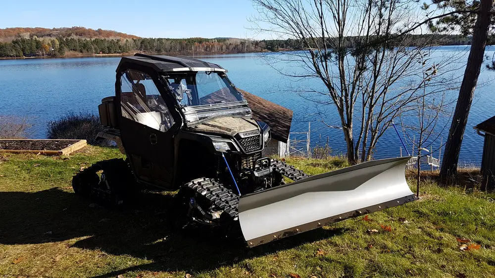

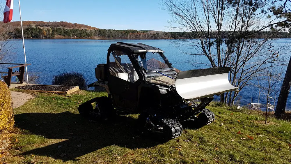

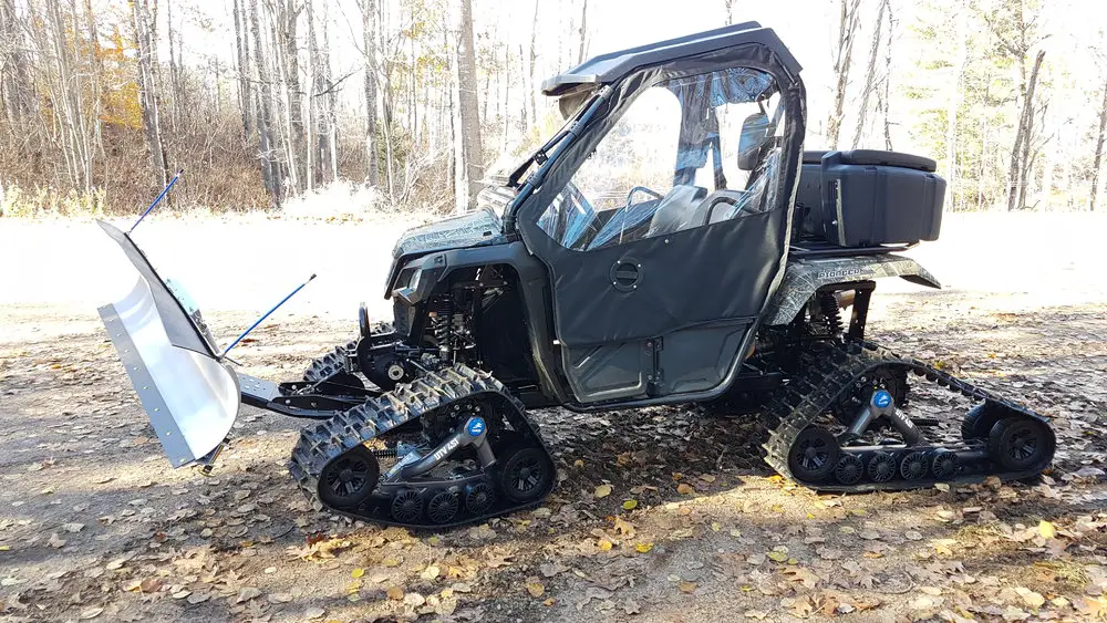

Here are some pics of the final setup. Went with camso tracks, 72" kfi plow, superatv flip up windshield, honda doors and rear panel. The whole set up is mint! I was worried the 72" plow would be too big and heavy, but it is perfect. 66" wouldn't clear the tracks when angled and the front end barely moves when I lift the 72" plow. And with the way the KFI mounts I can raise it super high, like almost over the headlights. No snow here yet but I expect when it does come this p5 will be unstoppable. Should be able to pile the snow up and keep pushing more on top. I'm happy with the whole set up.

When the snow comes and you do some pushing , it would be nice to see some videos of this setup at work.......looks great
