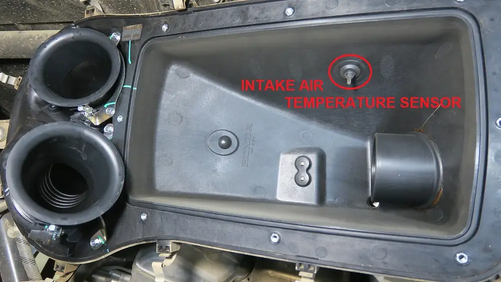

The Intake Air Temperature (IAT) Sensor. Access is between the seat and airbox, if you're bendy, it may be removeable without removing the rear firewall, maybe ...
I f3LTG7J XL
The IAT sensor and its plug, push the green circled pad to release, photo thanks to Hondasxs hisself. 👍

Is this an FYI or has this been a maintenance problem?
It's just an FYI from a question asked on another thread. 👍 When I learn something, I pass it on.

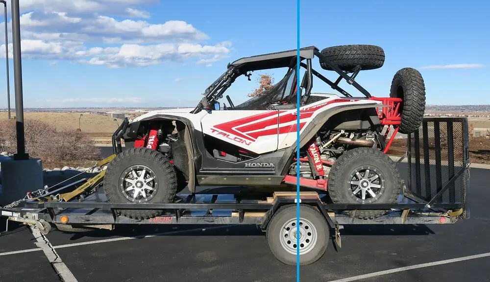

For a 250 pound tongue weight, this is where my Talon sits on the Echo Elite 14' trailer (which has a 125 pound TW empty). Tongue weight should be 12-15% of total trailer weight, I'm right at 2500 pounds - Talon + trailer. Your Talon will be similar. I'm a little light at 250 pounds because the RV has a 350 pound rated hitch and I wanted a cushion - luckily it tows with no swaying, the giveaway that I'm light on TW. This will change when I add the bed extender and spare hanging off the back, I'll post that photo when I have it.
Adding two spares and a bed extender for solo desert exploration plus a storage box full of 'stuff' added about 200 pounds to the rear of the Talon. Setting it to the same 250 pound tongue weight only moved it forward 2-3". (the red one was stolen, recovered and heavily damaged, this is it's replacement)

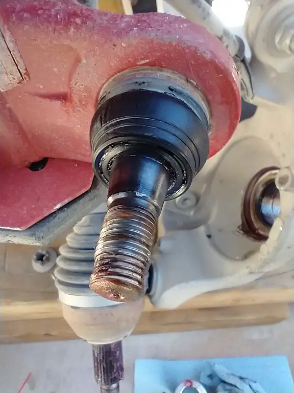

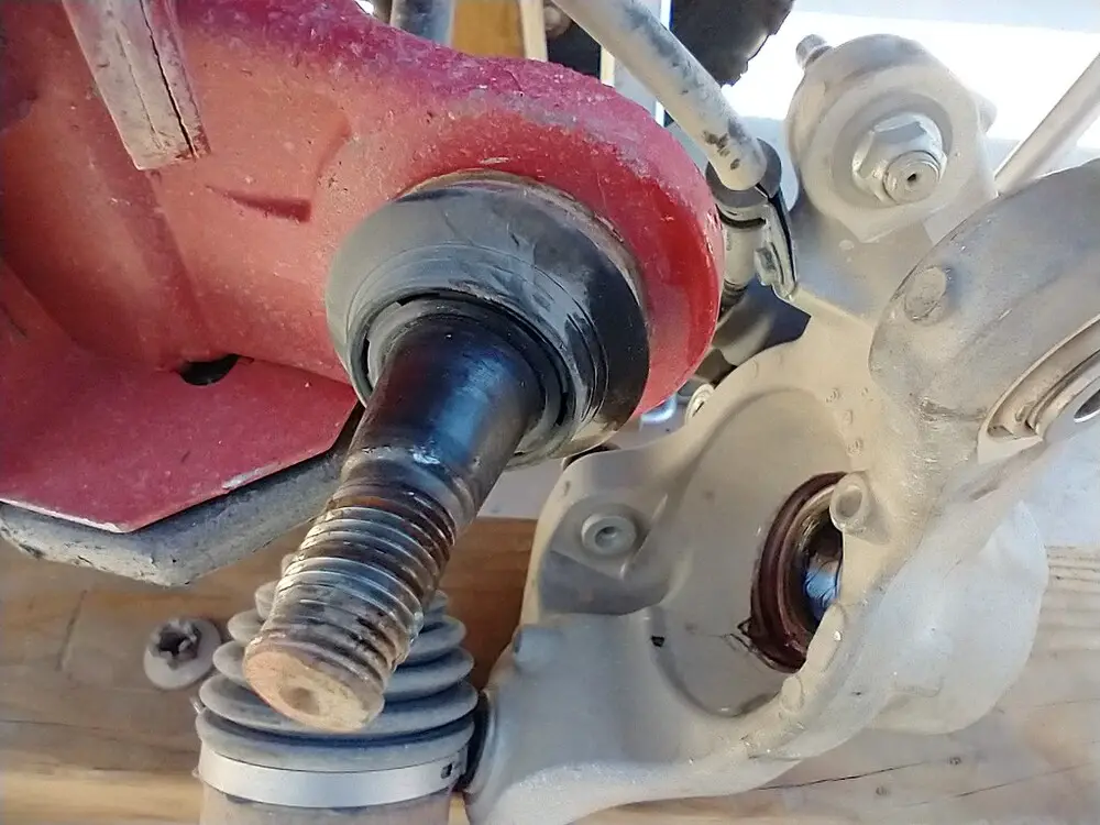

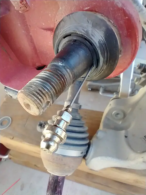

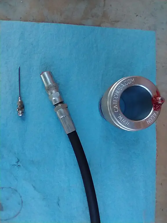

I was greasing my rear wheel bearings yesterday and took the opportunity to grease the trailing arm ball joint as well. I'm not aware that this is something that needs to be looked out for, just sharing the info here.
I cant remember where I got this grease injector needle but this is a good use for it. CA Tech wheel bearing grease tool on the right.
Since I had the rear knuckle off to grease the wheel bearings, it was easy enough to slide the greasing needle under the ball joint boot.
I gave it a few pumps of grease and worked it around by pushing on the boot, then wiped away any excess grease.
Now I don't have to worry/wonder if those ball joints are sufficiently greased.
I did that on the front tie rod ends and it push the top cover off .

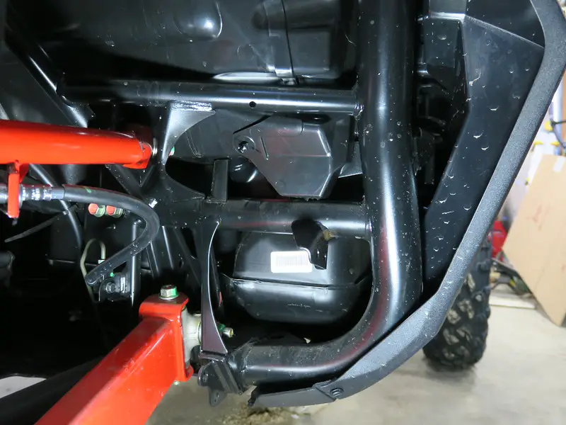

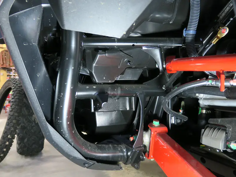

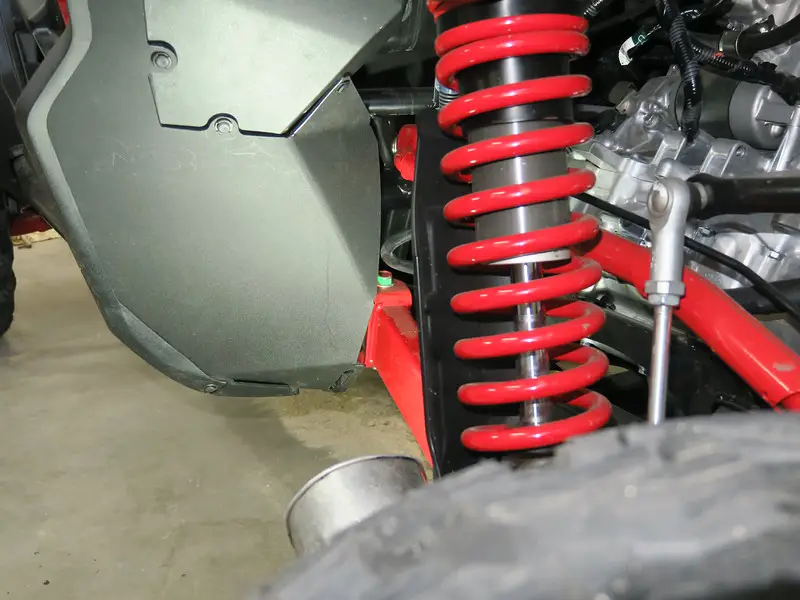

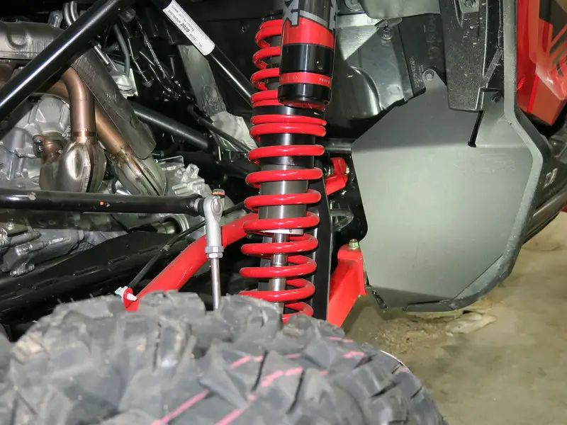

Another issue Lil_Steve brought to my attention is Honda's inexplicable reason for leaving the rear wheel wells open to the cab. These openings are directly in front of our rear tires and all y'all know how much doo doo rear tires throw forward.
Left -
Right -
Mudbusters makes a pretty good solution.
Left -
Right -
Anyone install the Mudbusters with nerf bars?
