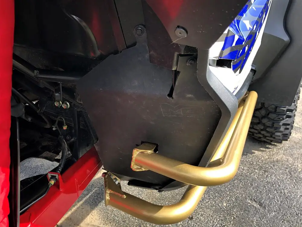

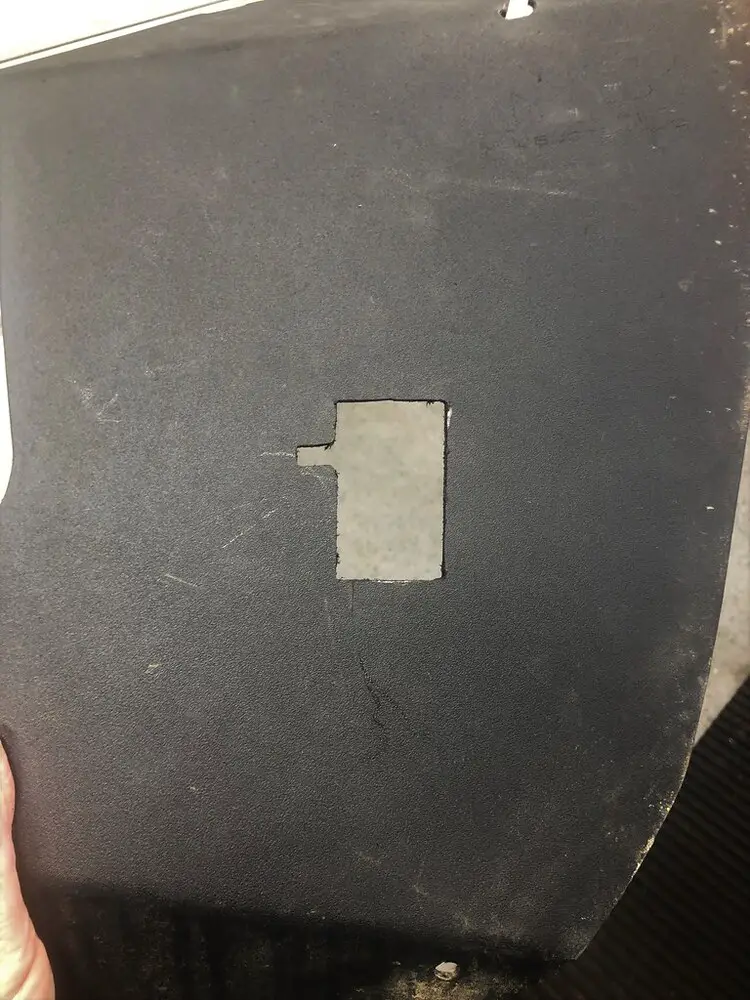

@TerryH has IIRC and did a nice job of it, accurately cutting the necessary hole in each MB.
It's a pain in the rear but can be done. Measure, cut, curse not necessarily in that order.

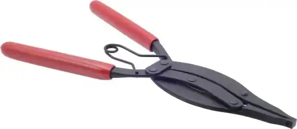

We have a special set of inside opening pliers (Mac Tools) to get the clip open in the diff. Lube and brake clean help loosen it up.
Then use a pry bar to pry the driveshaft back while opening the clip

We all have a similar set of "inside" pliers. They work great when the machine is new.
