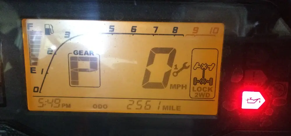

highpocket's recent thread on R2C airfilter failures, however few, made me realize that I haven't looked at mine since I brought it home 2561 miles ago. I never rode it without the Uni pod filter on a snorkel behind the passenger's seat and I checked the two airbox gaskets before my first ride. So I pulled the filter tonight to have a look.

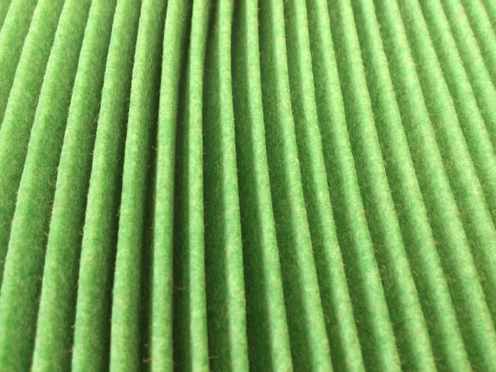

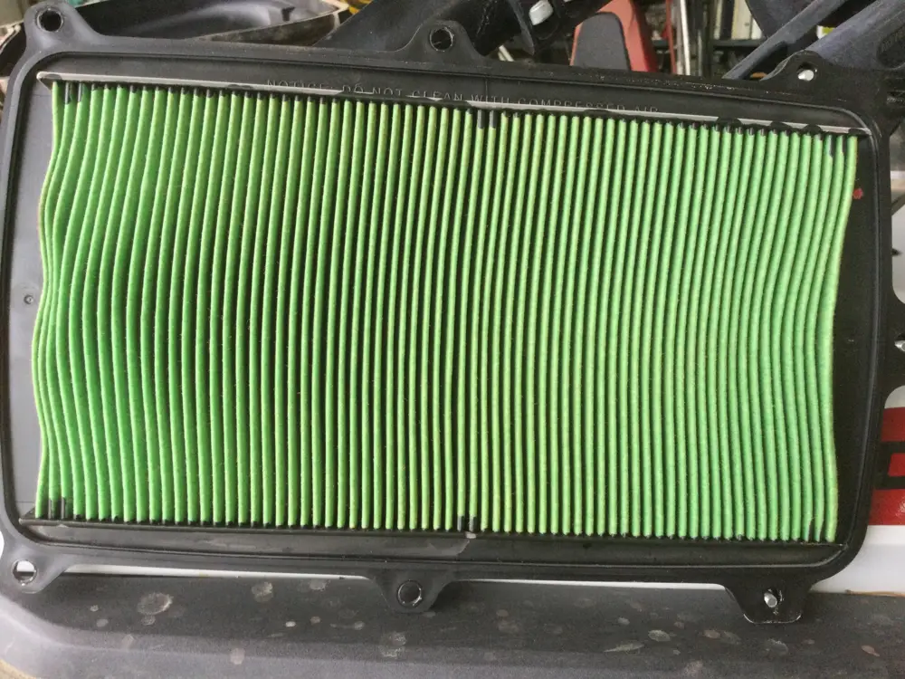

I'm not a filter cleaning OCD kinda guy, I wait until they start to 'mud over' before cleaning (that photo is in post #18), this is the result. I'm also not a racer, a slight drop in airflow will have no affect on my riding. The result of 'over oiling' is the last pic in post #19, but oil is how they work so I give it plenty. Note that I don't soak it stupidly and I squeeze out as much oil as possible but there won't be any dry spots.
1628906433696
1628906735093
All was not well inside the airbox though, there was a very light dust around the intake tubes. I couldn't feel it, it was soft like cotton lint but it was there. Since the filter was clean on the dirty side, that meant there wasn't any dust getting around the filter's edge seal either. The only source left is the groove around the airbox cover itself so I filled that groove flush with grease as has been suggested by others. I had thought this step was overkill, now, obviously, I don't.
This complicated reassembly a little bit - the 11 clips around the cover are pretty damn tight and now they're tighter. I had to bend a piece of welding wire to help me pull a couple of the clips into place. The grease also prevents the 'kerthunk' when the cover seats itself and I hoped that I had it aligned properly but the clips are so tight that misalignment is unlikely. When I was done I ran my finger around the perimeter seam and it was even all the way around so I should be good. Start putting the lid on in a corner, it will help the initial alignment.
Greased FULL - the grease smear in the upper right was there when I removed the cover. A grease gun with a small hole in the nozzle would make this faster, easier and less messy but I didn't have one.

I had all these same thoughts on my first talon. Fast forward 16000 miles and it was made clear that one of the tubes between the air box and the throttle body was improperly installed at the factory. Engine was using oil, she got a new talon. Will suggest you check your throttle body tubes closely, if there is a problem would hope it is not as severe as mine due to the lower milage.

Thanks, Dan, I remember your story. I 'assumed' that my cover was leaking but it sure could be at the throttle body connection. It's tight in there, hope I can get at it to make sure it's properly connected. 🤔 I checked those connections before but it may have been on the one that got stolen.
