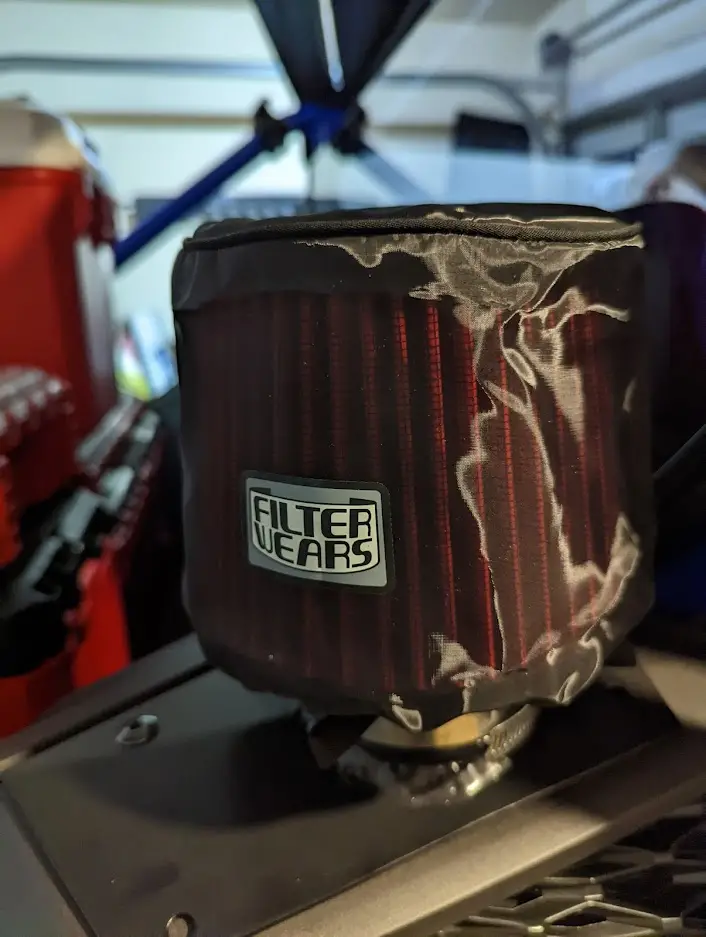

I'm running a Spectre filter and will be using a Filter Wears like I've done on the Pioneer.
1642309332925
