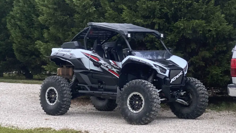

It's a good looking machine but it's still a 2 speed belt drive. Those are the things that led me to the Pioneer. Yamaha now has one with a real multi gear transmission but they only offer it on their high performance model.

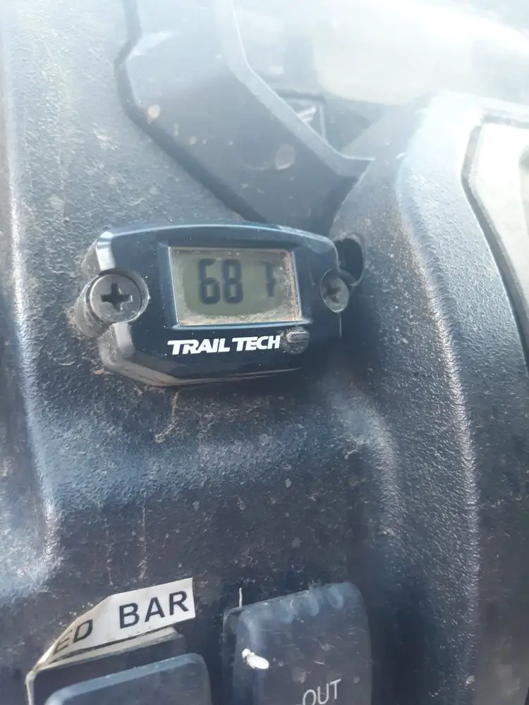

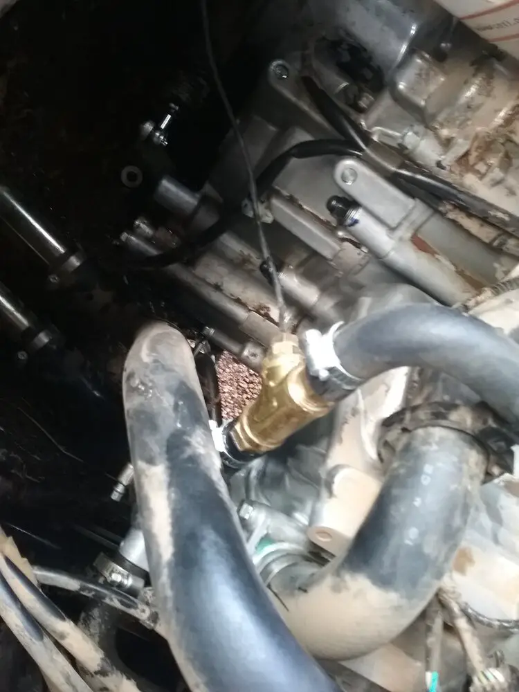

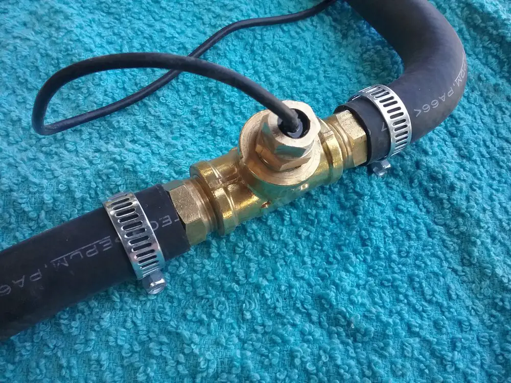

Never is a long time, nothing is forever. I still recommend the manual fan switch and the digital temp gauge. That way you have complete control and always know if a problem arises. If you would like I can post some photos of the hose adapter I put together for the temp sensor. I put it in the 12mm bypass hose because it always has coolant flow even when the thermostat is closed.
If it isn't too much trouble, I'd like to see your setup. Thanks!

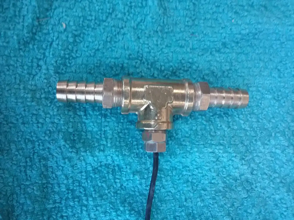

Photos attached. The hose adapter is brass 3/8" female pipe tee. The 2 hose adapters are brass 3/8" male pipe x 1/2" hose barb. For the center port I put in a 1/4" Female x 3/8" male reducer bushing and then I had to find an adapter bushing that is 1/4" male pipe x 1/8 x 28 BSPP (British pipe thread). I eventually located one on Amazon and if you follow the link at the bottom it will take you there. I chose to install the sensor in the coolant by pass hose because I wanted water after it exited from the engine which is when it is at it's highest temp and didn't want flow interference from the thermostat. As it turned out the adapter exactly placed the sensor tip in the middle of the water stream. This gauge has it's own battery so doesn't require any wiring but because of that it doesn't have a face light for night use. Don't ask why they chose British Pipe Thread, it could as easily been IPP (which is tapered where British is not). Any further questions feel free to ask.
Me too... but omg Kawi nailed it with this machine for the riding our group does!
Amazon.com: VIAIR 90001 1/8" Female BSP - 1/4" Male NPT Adaptor - 2 Piece: Automotive
Old Gasser
View attachment 236040View attachment 236041View attachment 236042View attachment 236043View attachment 236040View attachment 236041View attachment 236042View attachment 236043View attachment 236045View attachment 236046View attachment 236047
Mighty fine work sir! Thanks for sharing!
