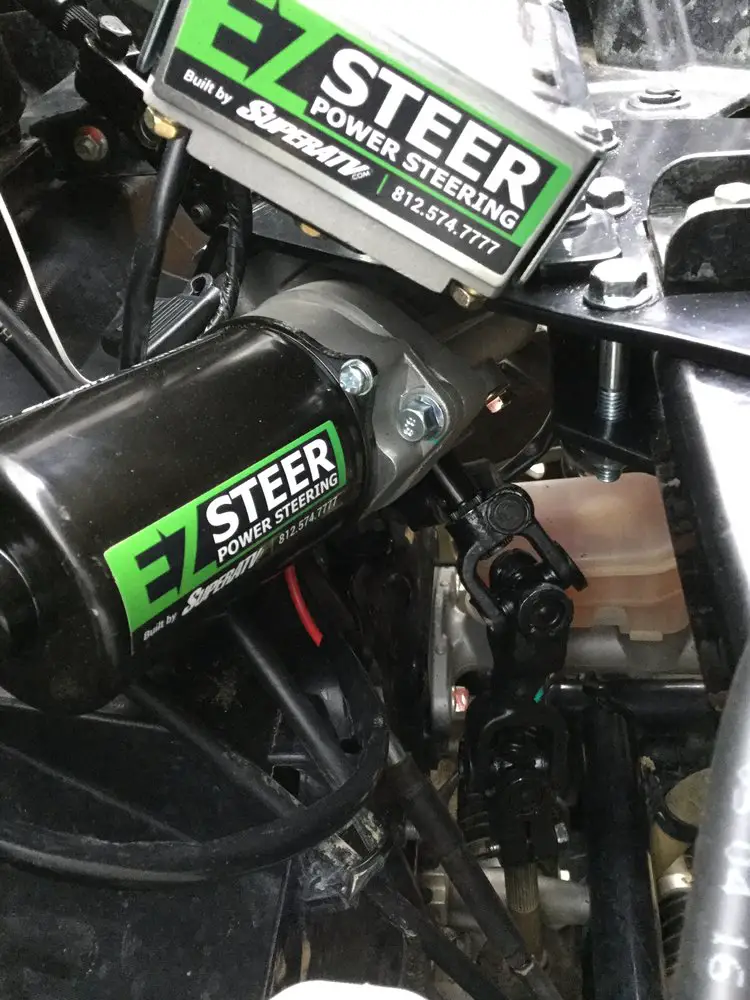

$549 after mentioning Hondasxs.com for discount. Huge difference with the 27 inch tires and it was a larger power steering motor than I expected (good thing). FYI..Tapped into the white/black 12 v key hot lead from the four slot accessory plug for the small while wire, and already had the heavier main red power lead under the hood from the earlier winch install.
This picture is worth a thousand words, shows the position of the lower shaft and that's the pita! I also remembered reading that you took out the wrong bolts and then I went and did the same thing. It's their picture that shows the wiring clip coming out of the top, they really need to change that pic in their instructions. Back out I go. Thanks Mudder!

@trigger , Glad you got one. Let us know what you think. Hope others will note this post on bad instructions, might be that wire exit depends on how it was assembled at factory. Key is the pic with the three large bolts pointing down.

The EZ Steer is all bolted in but the wiring fell about a foot short for me, just have to extend them in the toolbox. I did crank it back and forth to full turn a few times just to make sure nothing rubbed and everything was kosher. Inaccurate pictures don't help their instructions but it ended up being a nice compact and clean little install, can't wait to try it.

@Bad_bowtie , Ez steer still working great for me, and don't forget to ask for the forum discount, $40+ Savings was worth asking for it. If you do get one, note the earlier post about the error on their instructions picture.

No they had not changed it when I installed mine and that was after @Mudder did his. They show the unit upside down and it creates problems. Knowing this going in will save you some time and grief.
