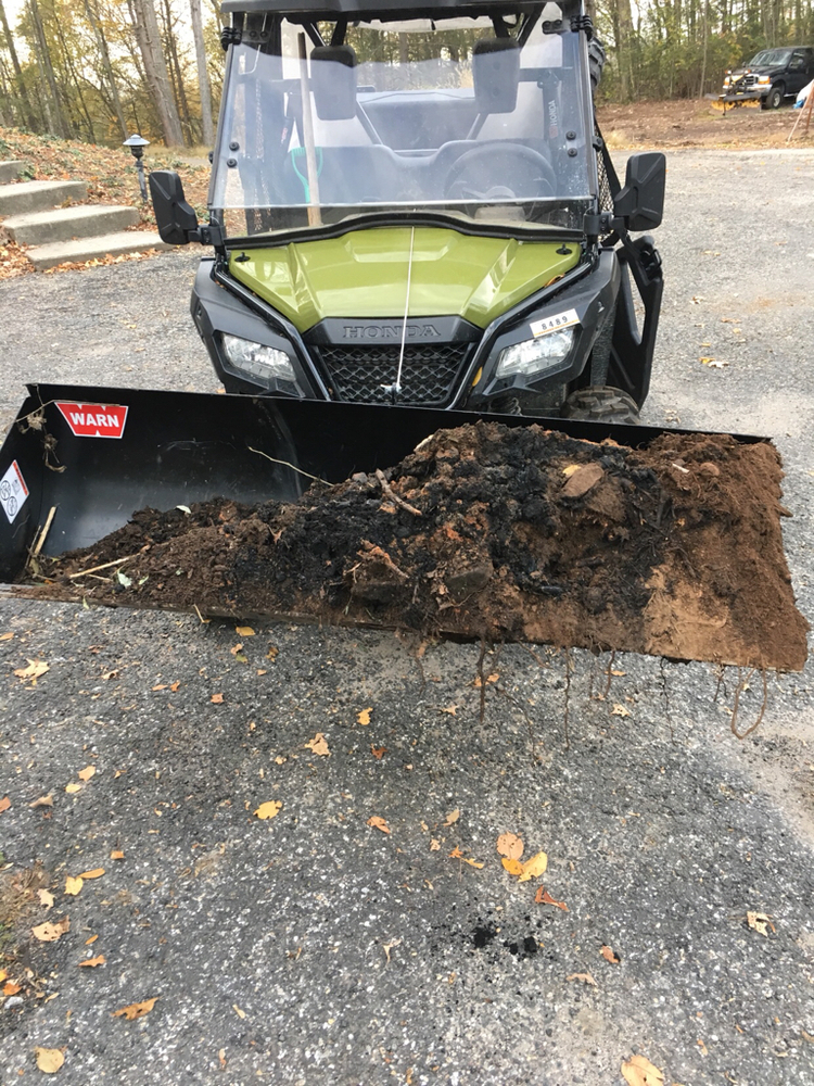

I did research on this one as well. The Tusk unit has more up to date instructions than the super atv one. Installed it last month and it works great. Got it from Rocky Mountain ATV, makes a big difference with my Bighorn tires plus front bucket.View attachment 60527
