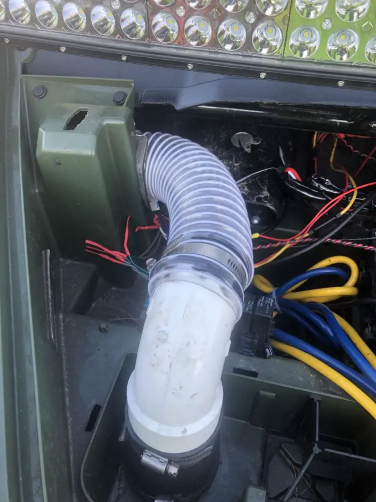

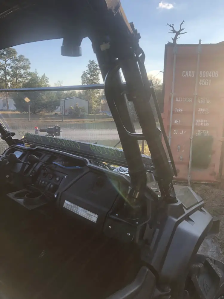

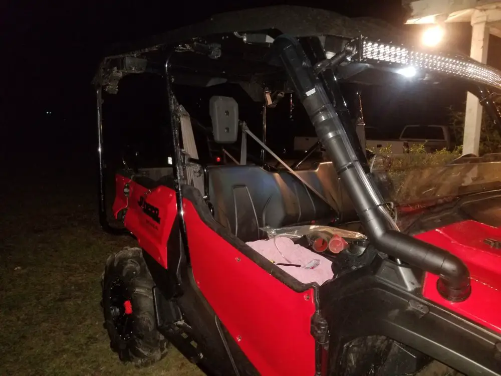

Ok this evening I got the snorkel finished. I didnt put the screen over the end though, I guess I need superglue for that or something. I gotta tell yall Im not real excited about this snorkel. I shoulda got the stainless one that went through the passenger cup holder. I will probably build my own one of these days. Im kinda in a time crunch for now though because we're going riding and camping tomorrow. I took my heat gun and heated up the piece that goes between the outer fender that I drilled the 2.5" hole in, and the inner fender that has the big ugly hole in it that it looks like Ray Charles cut in there with a sawzall at midnight in a thunder storm. Anyway, that got the angle a little better and then I put two 22.5° female to male 2" couplings in there aimed towards the stock intake hole. I had to trim the end off of the 2nd 22.5° coupling and I had to trim the piece that comes in the kit that plugs down into the stock intake hole. I had to trim the rubber coupling almost in half that has the hose clamps on it that came in the kit also. So be warned, if any of yall buy the snorkelyouratv.com snorkel kit you will probably have to do the same. The only things I have left to do to it for now is put the winch and winch mount on, and also the SuperATV arched front arms. That is something I'll tackle maybe next weekend though. I gassed it up and in the morning I'll load it on the trailer and hook the dually to the camper and we're hittin the road! Yall be good!
View attachment 101986 View attachment 101987 View attachment 101988 View attachment 101989 View attachment 101990

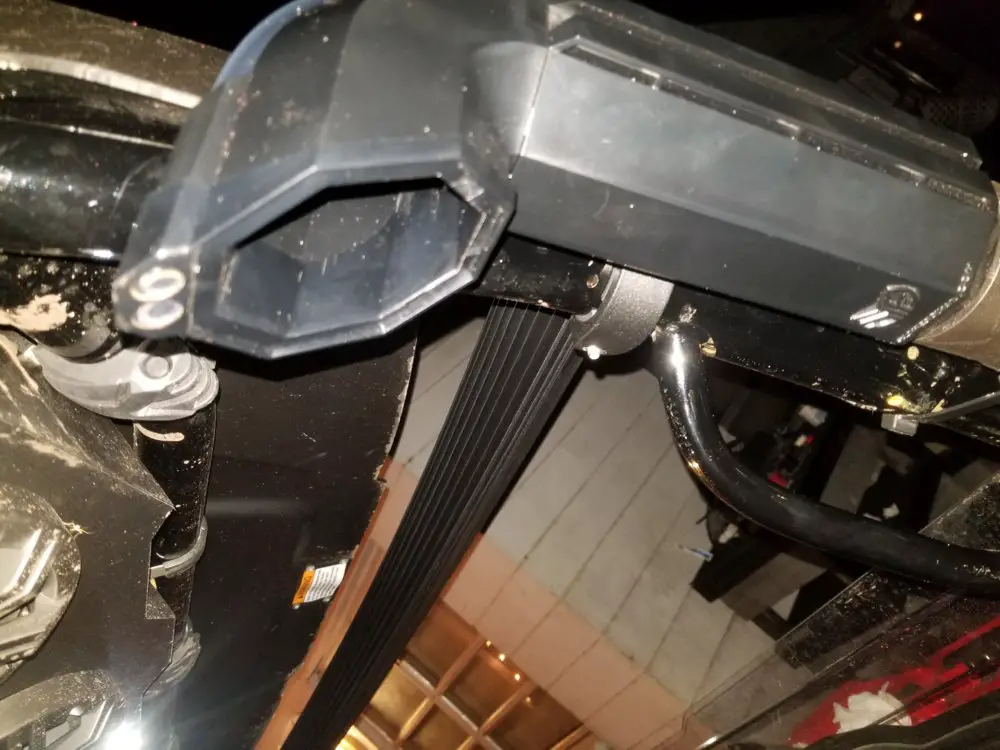

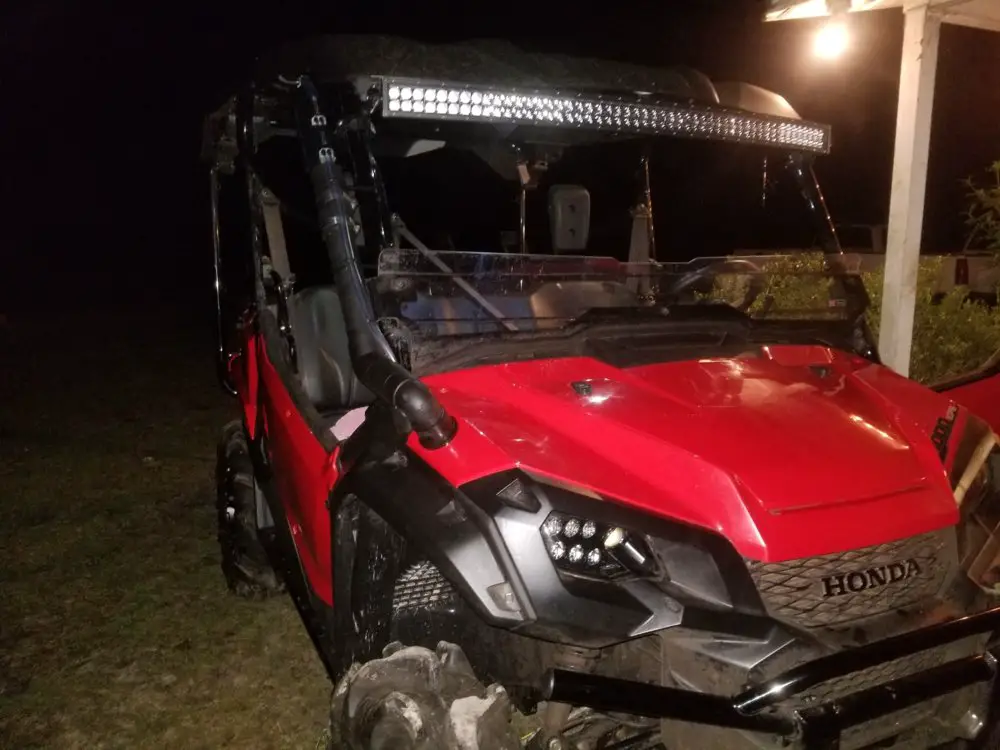

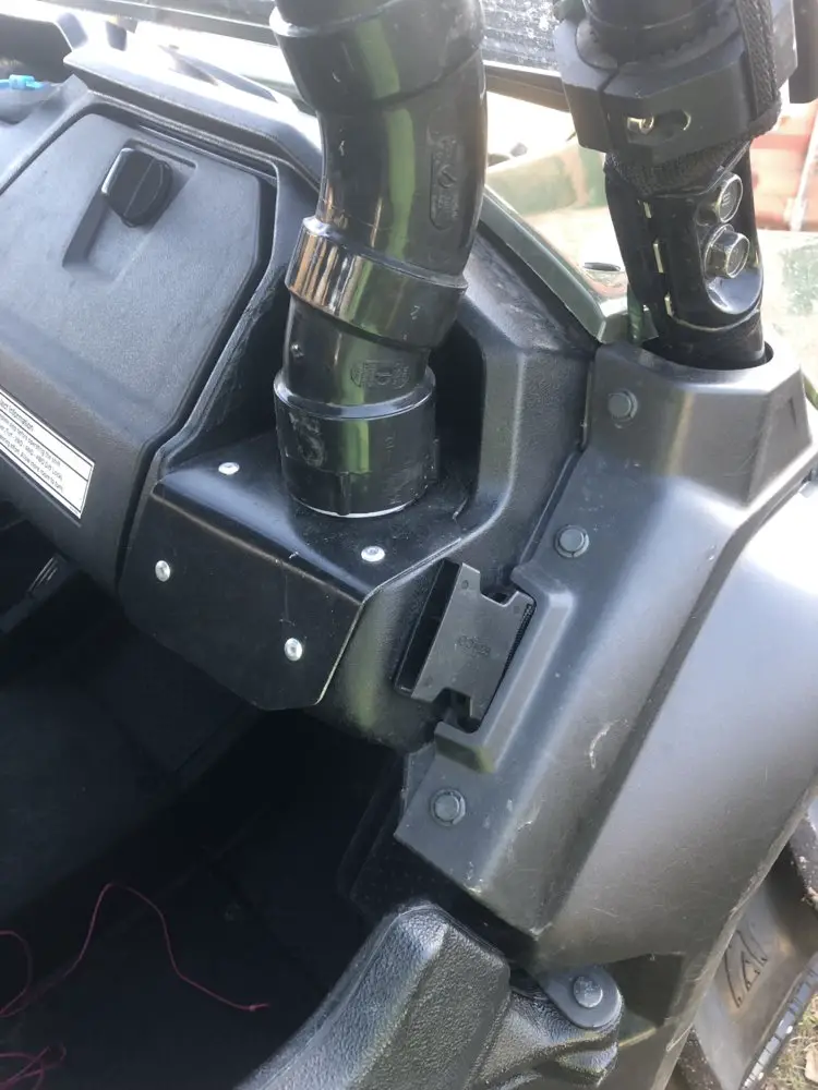

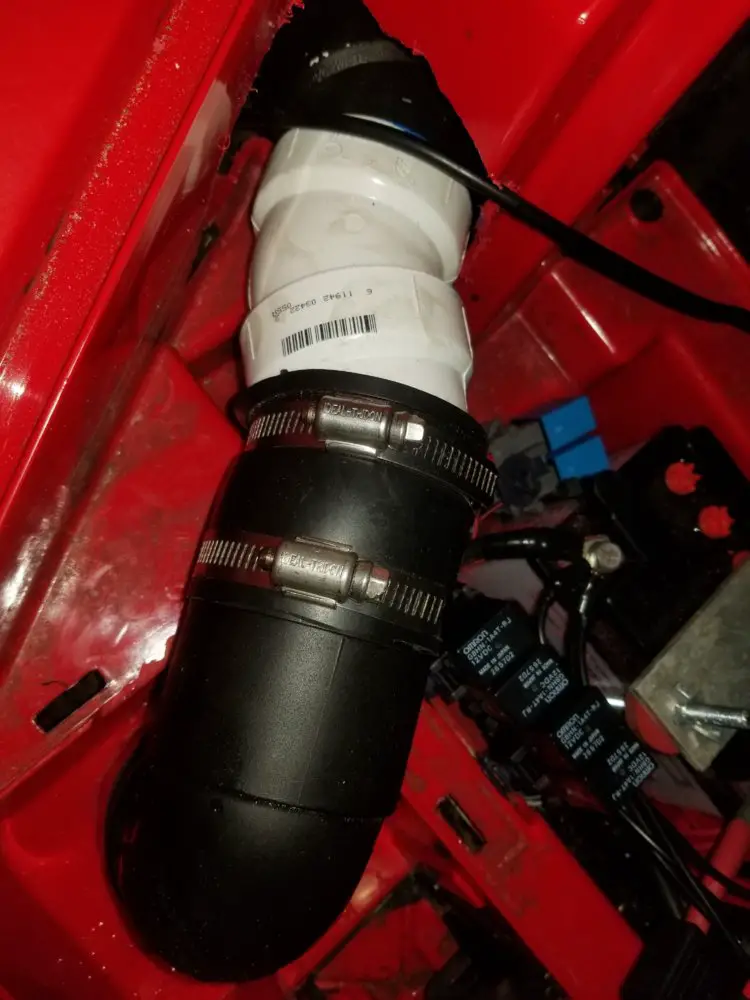

If you do decide to go through the cup holder I made a mount plate for mine and got about $60 in the whole snorkel itself I don’t live to far it looks like. I’m in the melrose are if you need some help
E288DA8C 1DE3 43C4 BCFC 653703B9B3FF 736A1E92 8EB1 4893 98CB 957AC1705C88 04B2D5B9 185E 463A 9E6E B88A44294494

Wow that looks nice! Thanks for the pics. I actually live in Orange Heights. You could throw a rock from my house and hit the intersection of 301 and 26. We should get together and ride sometime.
View attachment 102432 View attachment 102433 View attachment 102434
